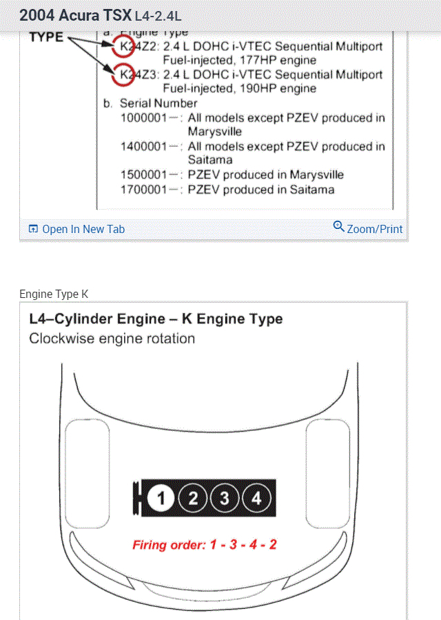

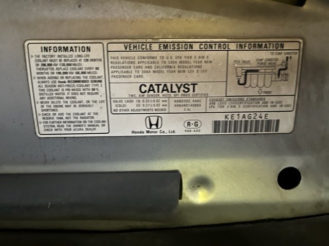

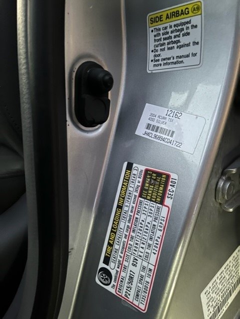

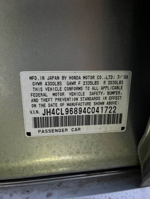

I want to replace the coil pack, but on this 2.4L VTEC 4 cylinder I find mixed information online on which is the #1 cylinder. What is the cylinder arrangement on this engine? Is it (pass 1234 driver) or (pass 4321 driver) while viewing the engine from the front standing there looking at it? I have attached additional picture info which may help clear up exactly what type of car / engine I have.
