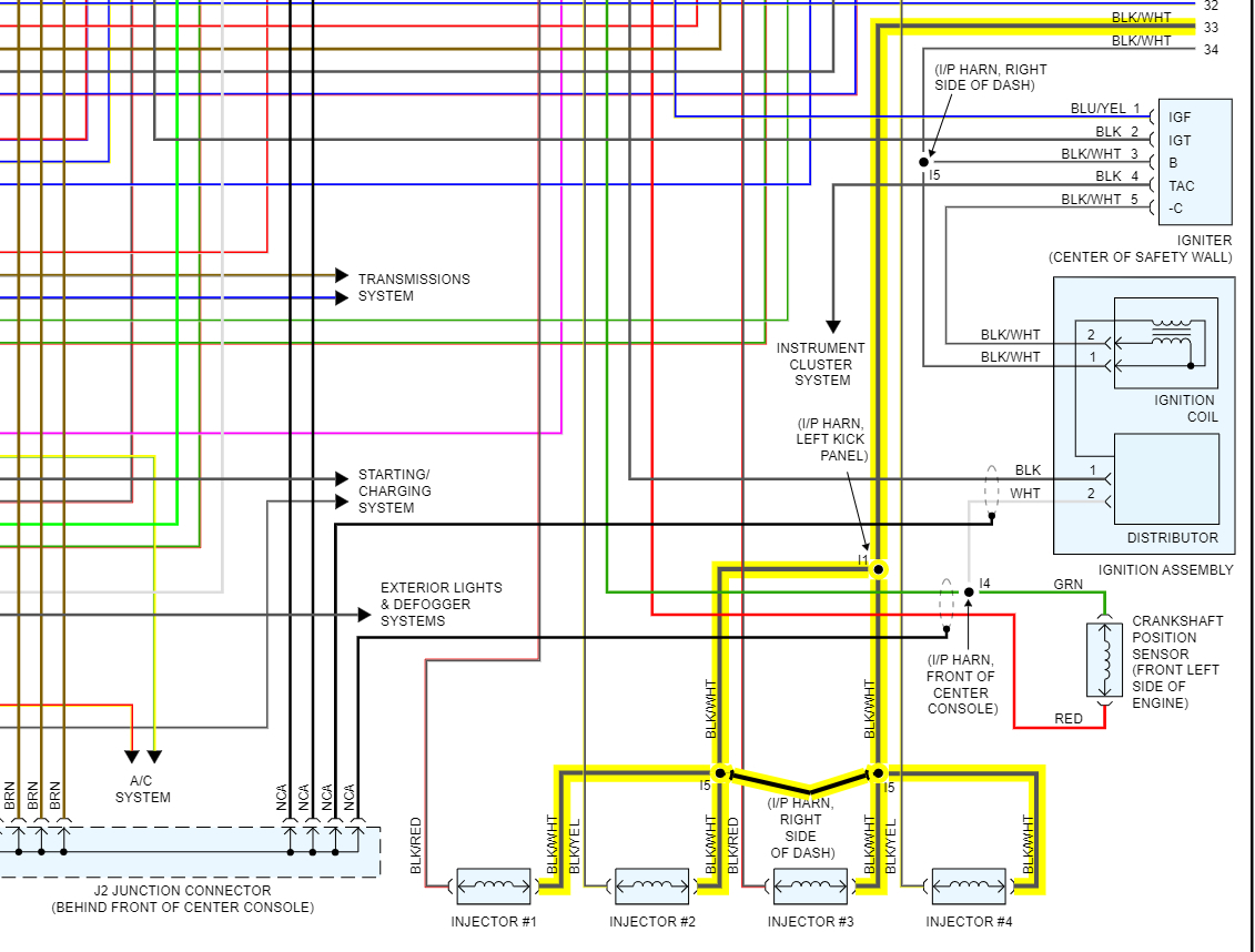

Were you able to do the test light check on the Fuel Injector? If its a bit unclear, the computer will turn the ground side of the Injector on and off (pulses) extremely fast. So, if you hook the test light to Battery positive, the test light will flash because its acting as the Fuel injector should act. The test will flash dimly because the computer is now grounding the test light and pulsing it. This test will work with the Injector plugged in or unplugged. Back probing the Injector harness plug while it's still plugged in is the better way to do the test because the fuel injector will put more of an electrical load on the circuit. If you have 12 volts on one wire and a dim flash of the other wire, the fuel injector is being controlled correctly. And doing a compression test would be next.
