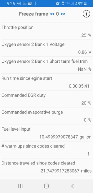

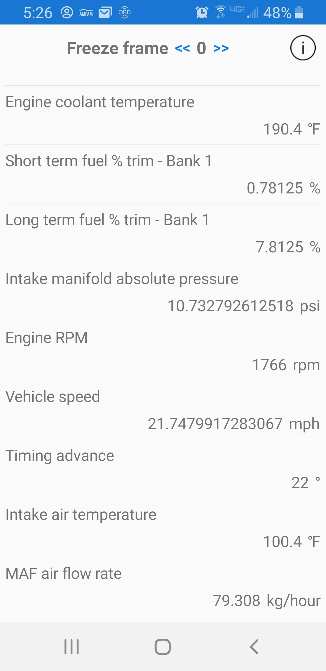

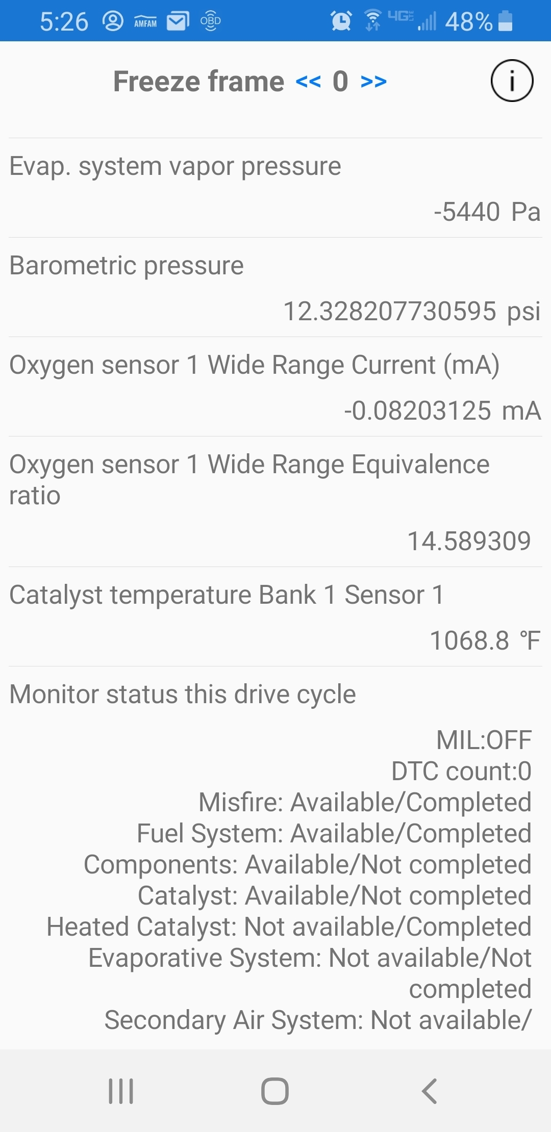

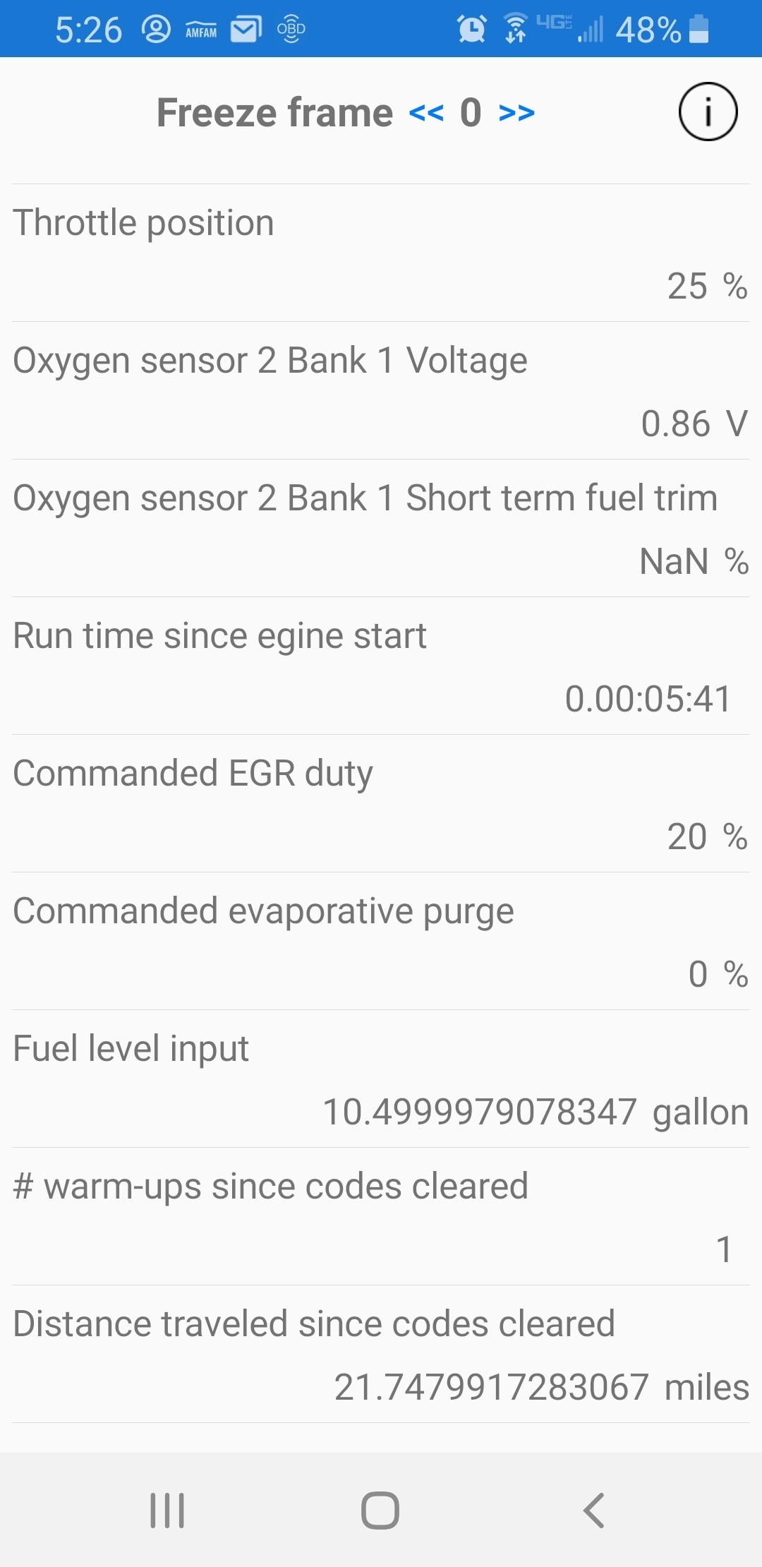

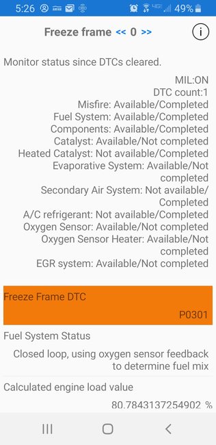

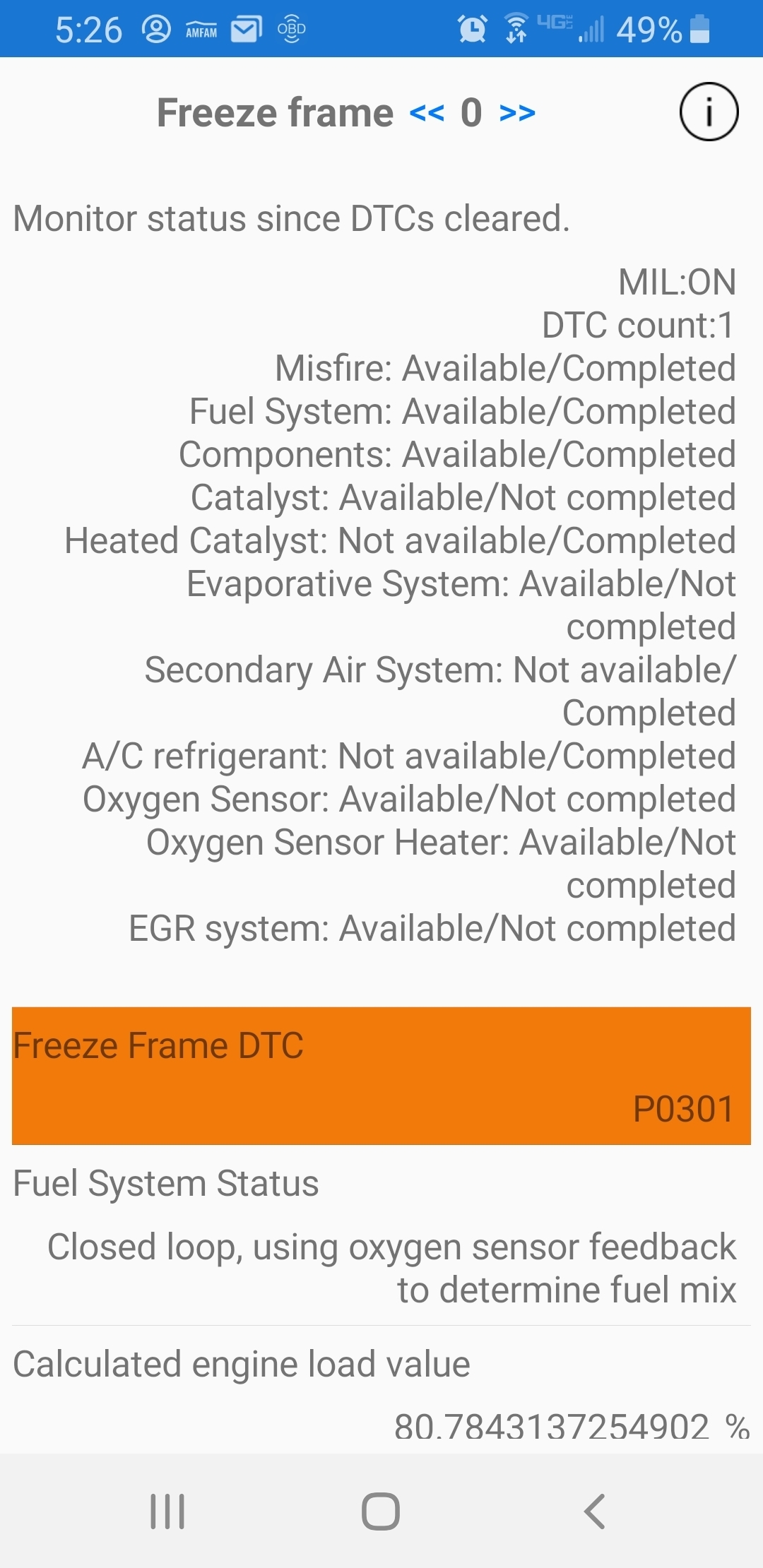

I have been trying to diagnose this issue for six months. P0301 is the only code I get, drives fantastic but at lights (idle) runs very rough. It has a check engine light. I have replaced every sensor on the vehicle except for I the Mass air flow (having to remove the intake manifold). Have replaced fuel injector plugs, both O2's, checked fuel pressure. Still get that rough idle and check engine light. Also did a wet and dry compression test which is withing tolerance. I very much appreciate any help.
Thanks,
Bman
