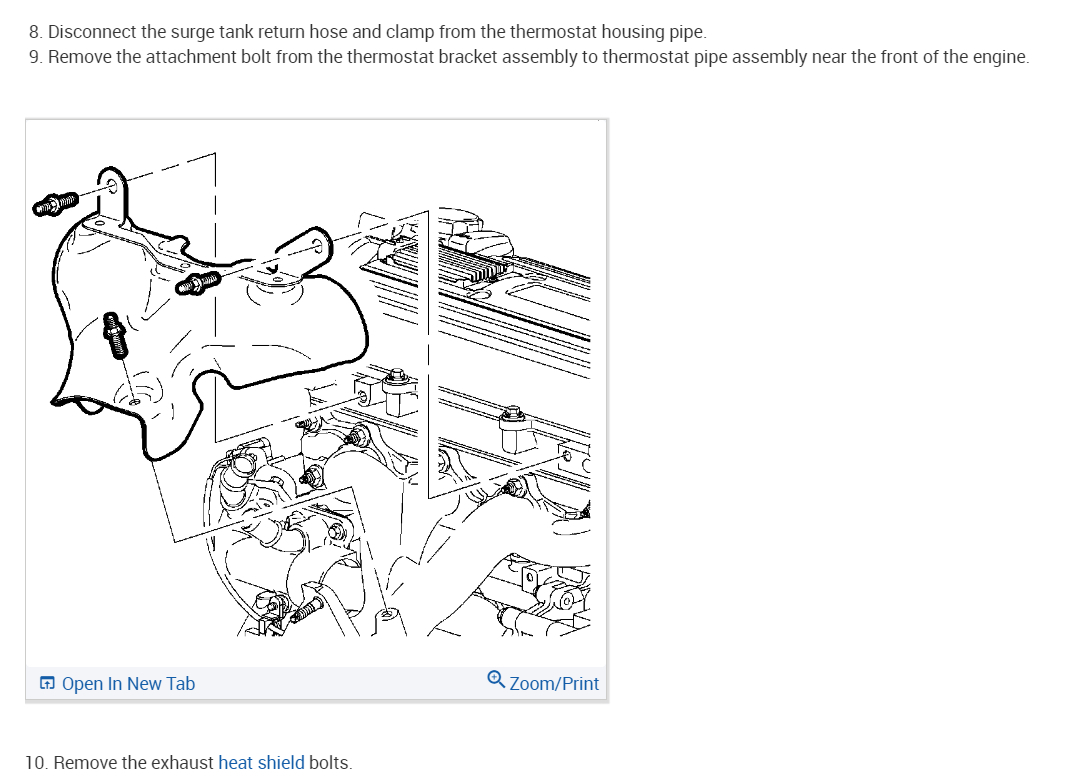

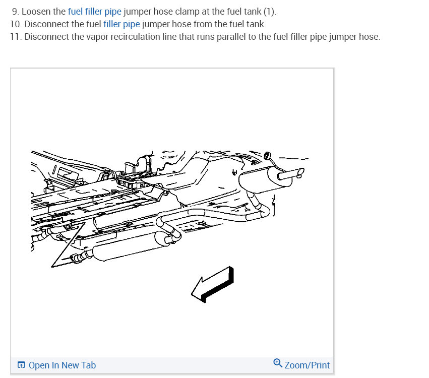

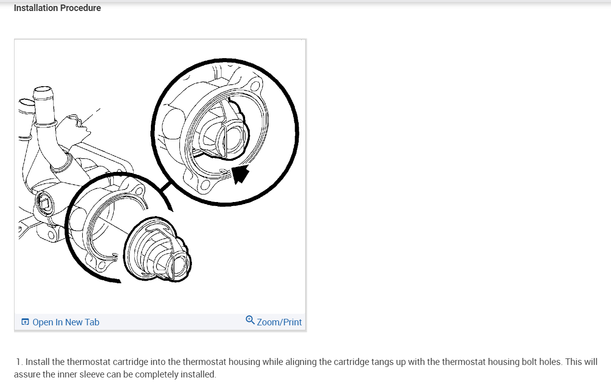

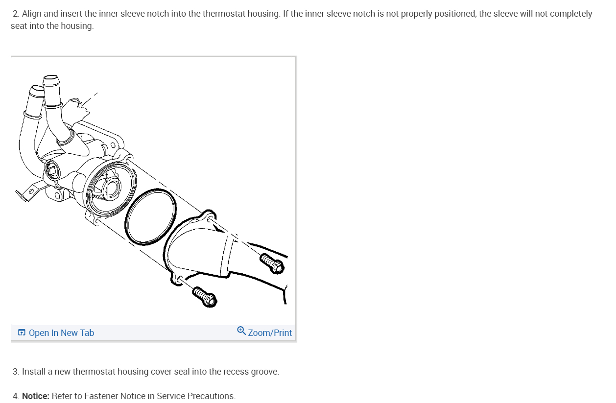

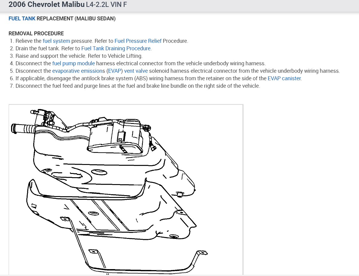

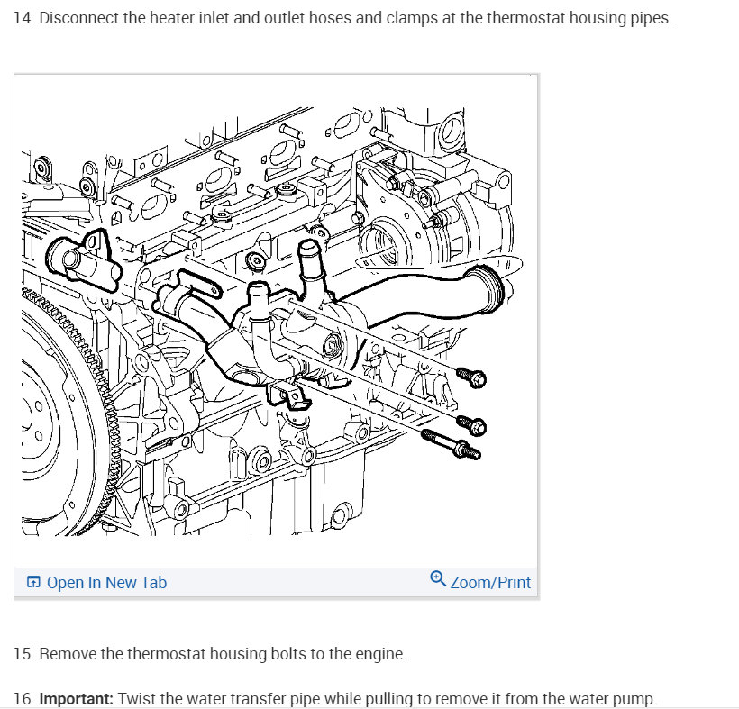

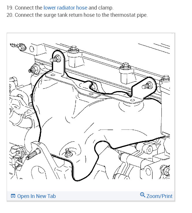

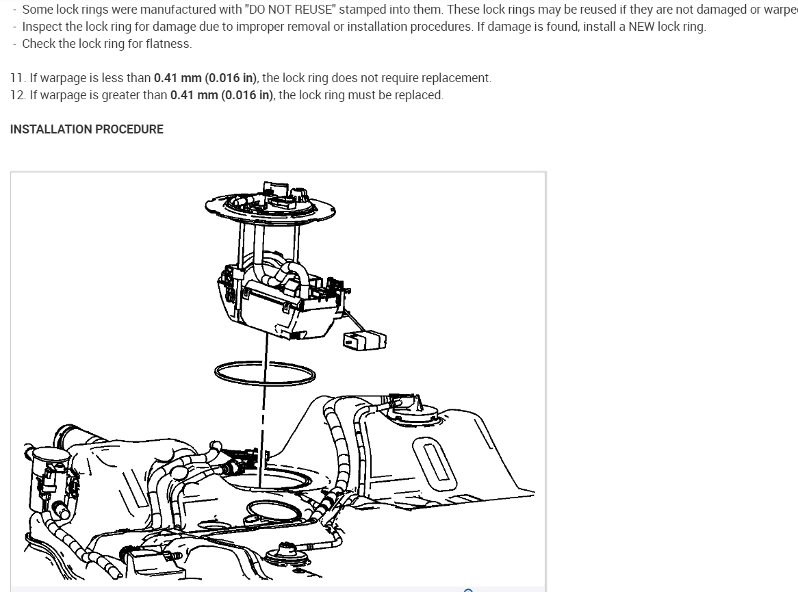

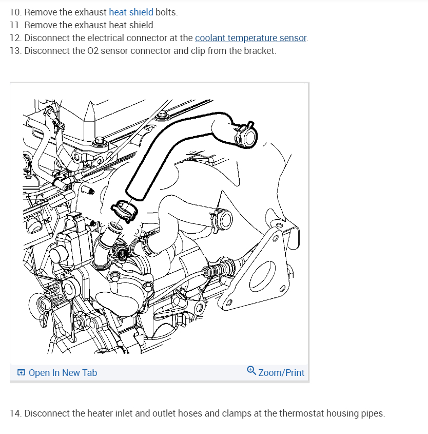

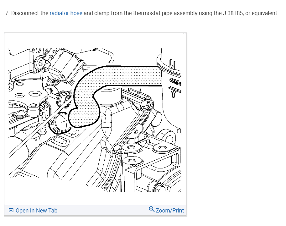

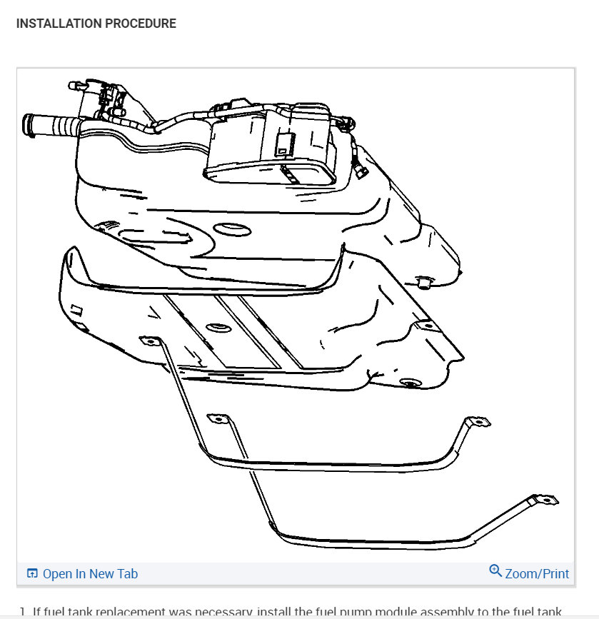

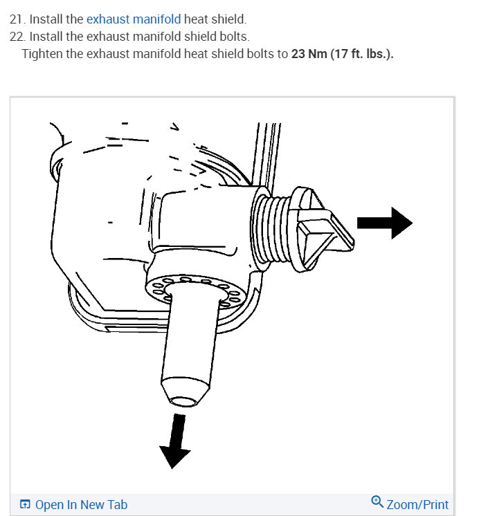

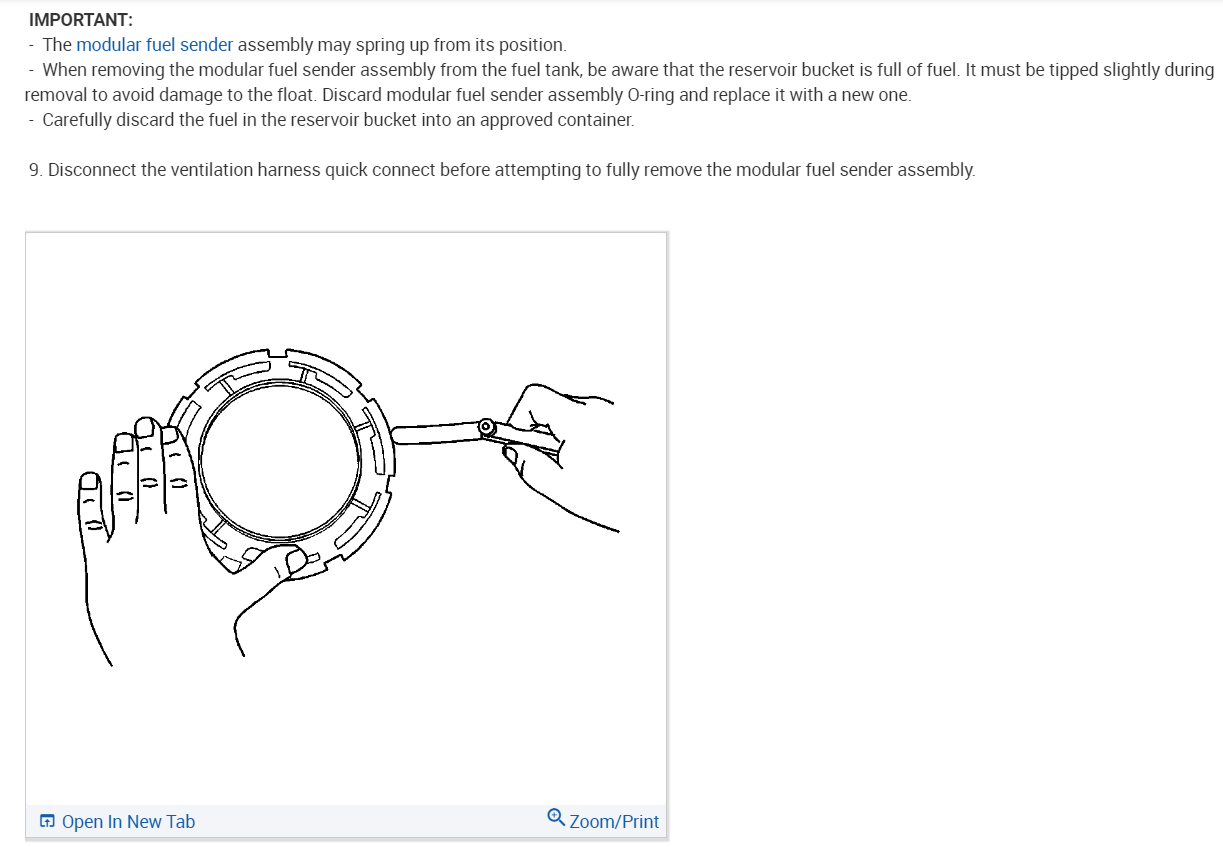

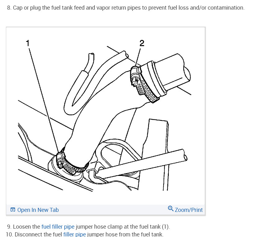

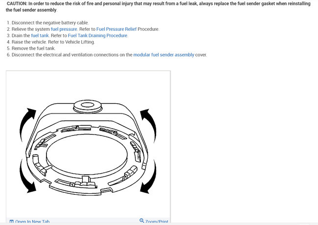

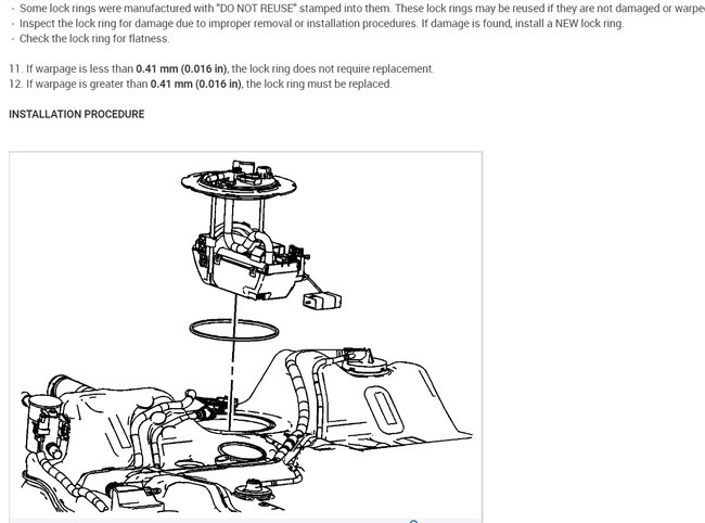

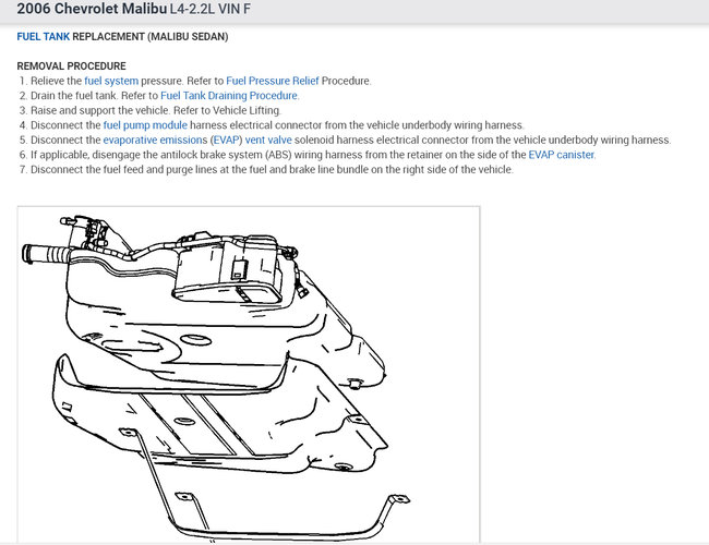

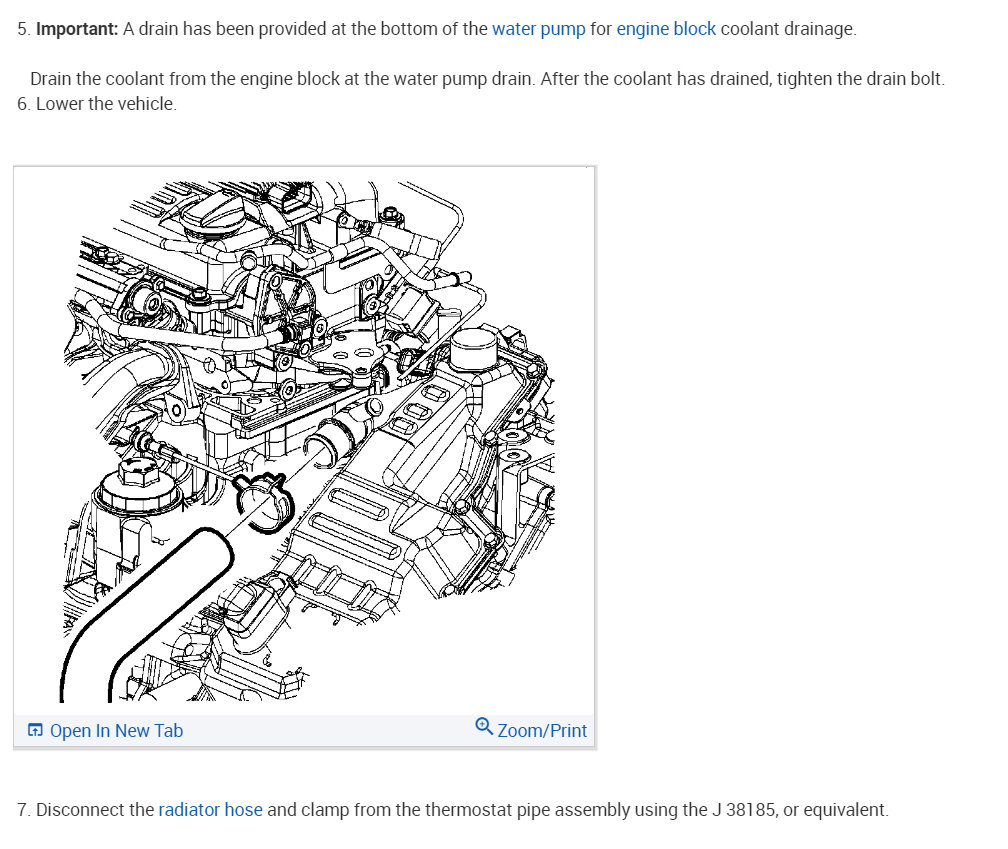

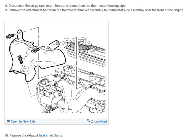

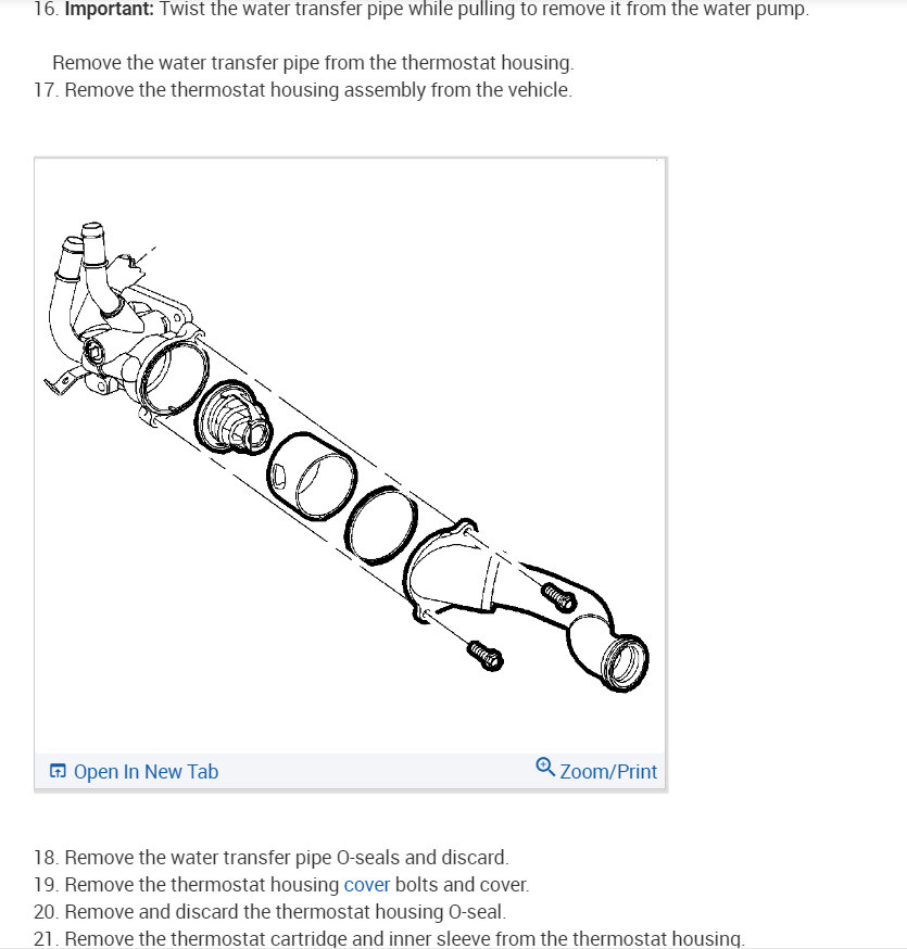

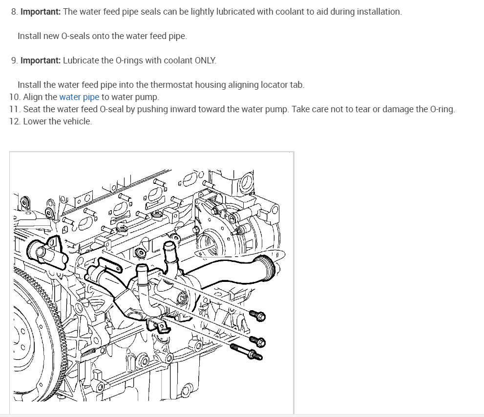

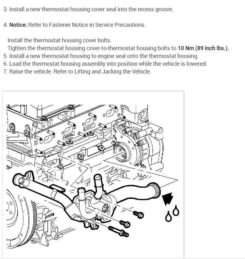

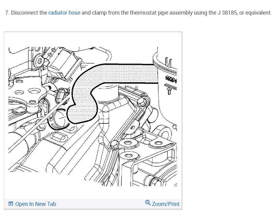

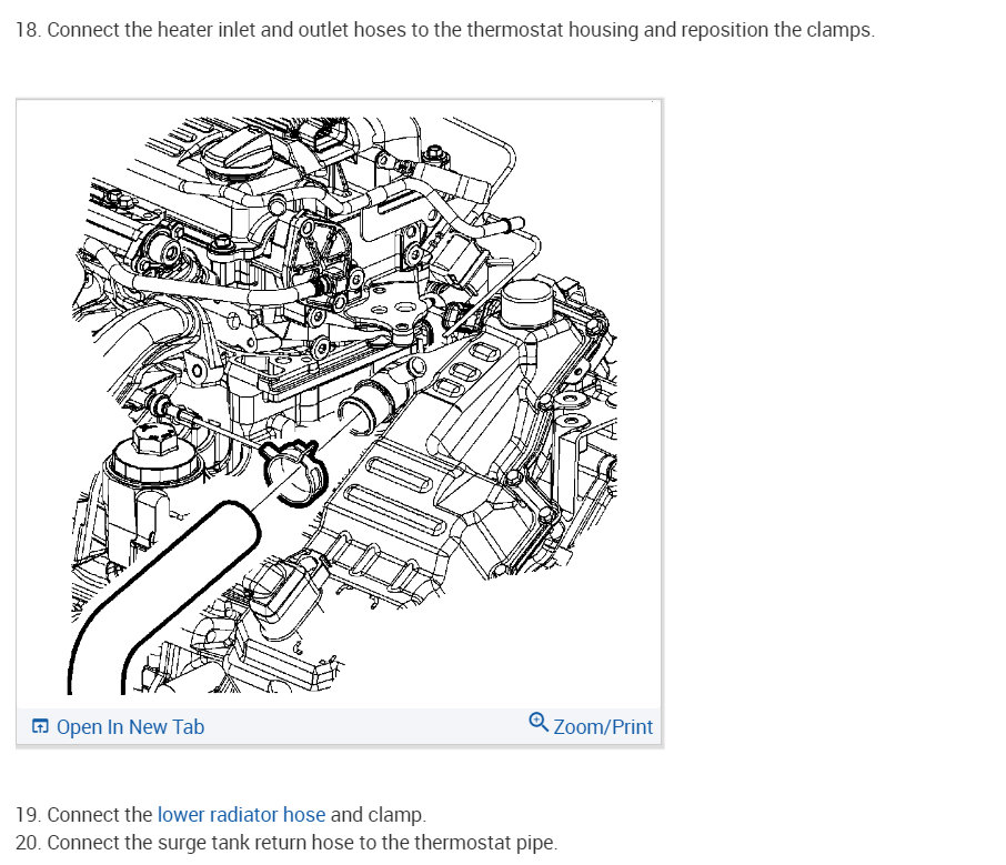

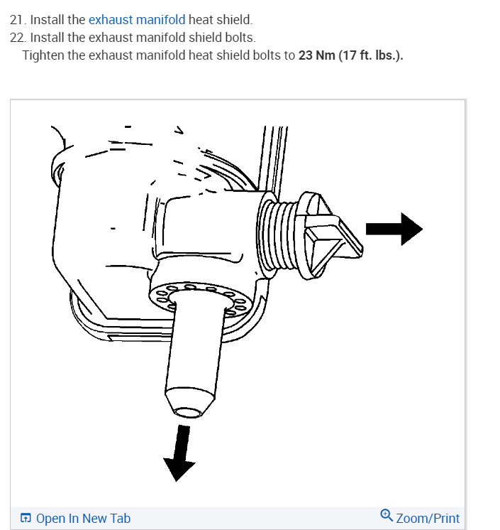

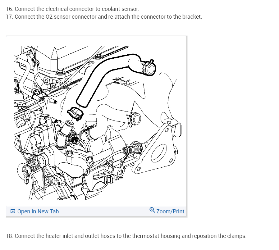

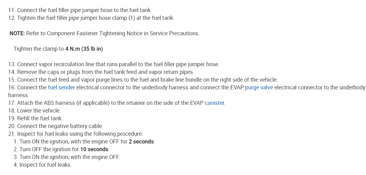

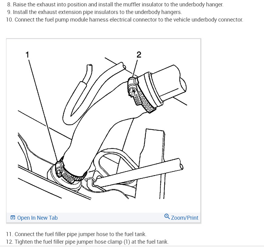

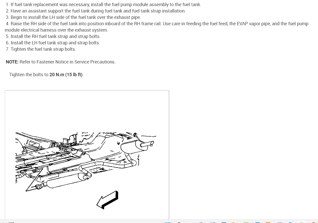

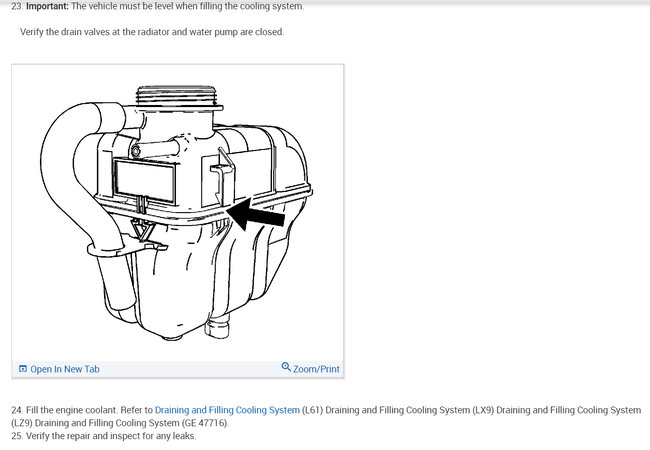

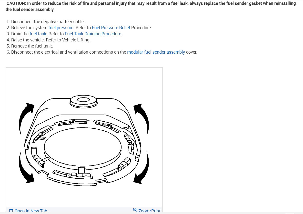

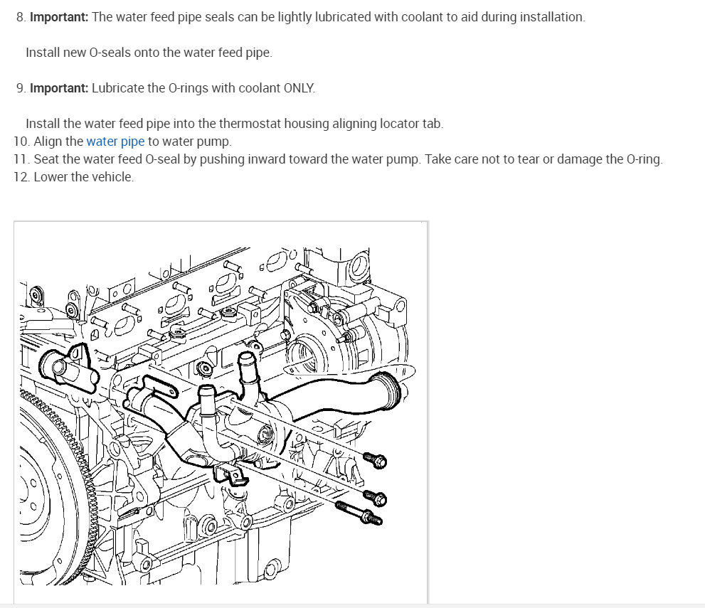

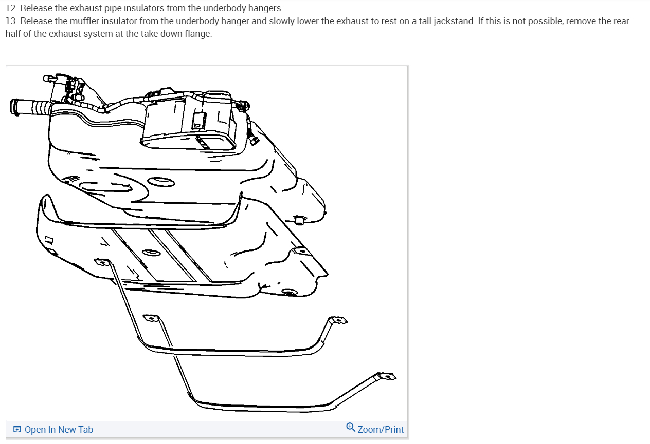

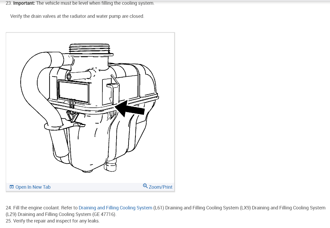

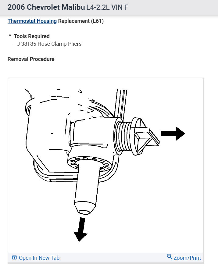

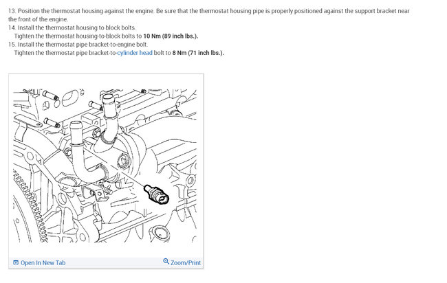

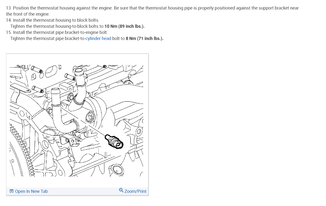

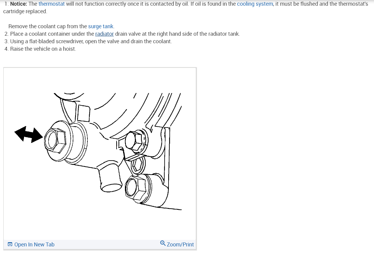

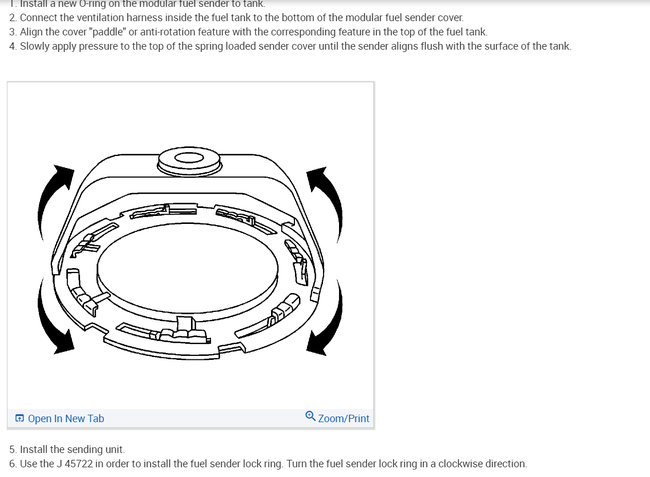

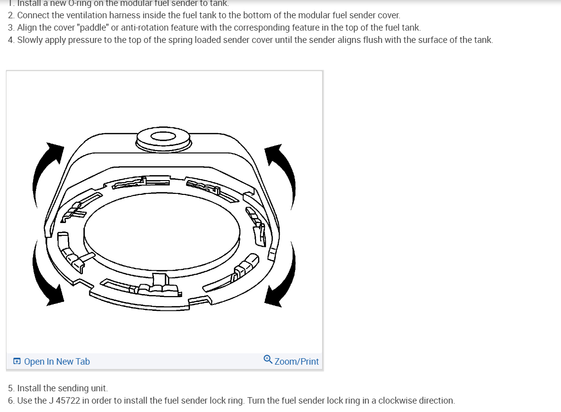

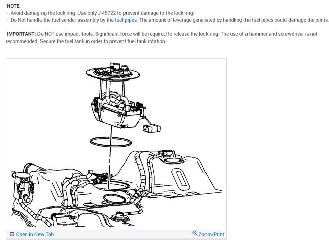

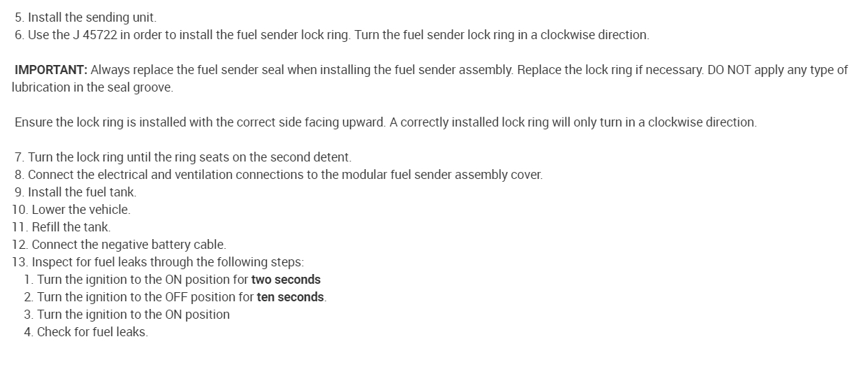

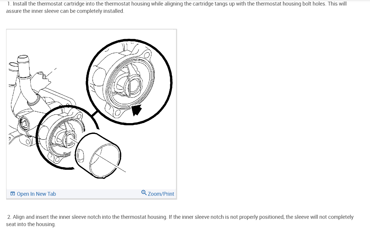

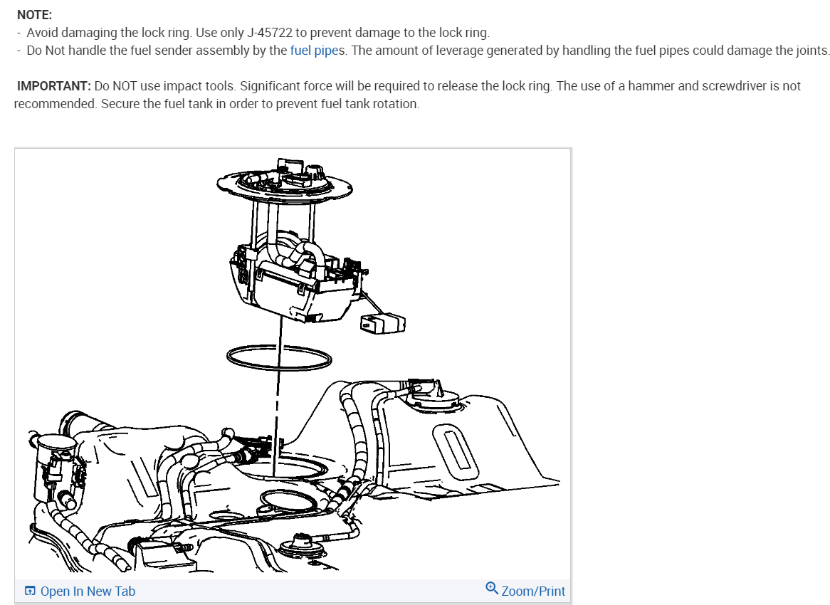

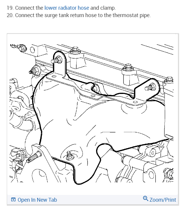

Hello, the P0463 code the fuel pump module, needs to be replaced. I would use an AC Delco unit, also the P0128 code is telling you the engine cooling system thermostat needs to be replaced. Then when the jobs are done, I would clear the codes to see if the P0300 goes away. Check out the repairs in the diagrams below and I have included generic guides as well to help you understand the repairs.
and
You will need to drain the coolant and the gas out of the car before you begin. Here is a video to help show you how:
https://youtu.be/Q5MH2gnyFH0
