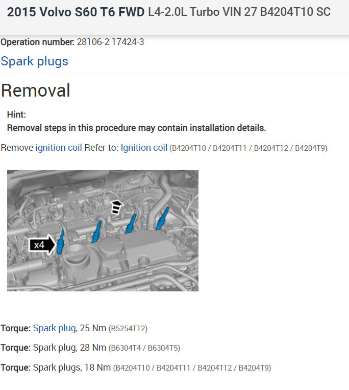

Volvo S60 2015 T5 Drive-E FWD 245KM tuned by Polestar has been getting the abovementioned codes for 2 weeks now. No issues seem to occur; the engine seems to function fine. Since the codes appeared, I fixed a P0442 code by replacing the fuel cap. Additionally, a crankshaft position sensor code was fixed by cleaning the upper one. Also swapped the spark plugs for new ones. I swapped around the coils and the cylinders 1 and 4 code keeps reappearing.
