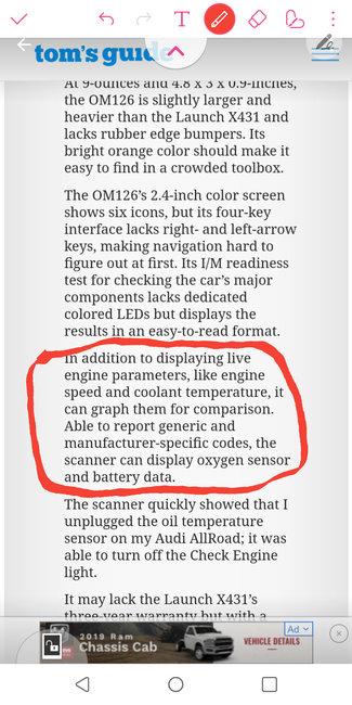

I circled what I am thinking would be what we would need it to do. Is that correct? It is a Autophix Code Reader OM126.
May 16, 2019 at 4:18 PM
The one I mentioned is about $50.00. They range from about fifty dollars to hundreds or thousands. Clearly, you don't need the higher priced ones if you are just looking to read sensors and stuff.
If you get one, just start with sending me the short term fuel trim for both bank 1 and 2 and we can go from there. Thanks
May 16, 2019 at 4:20 PM
