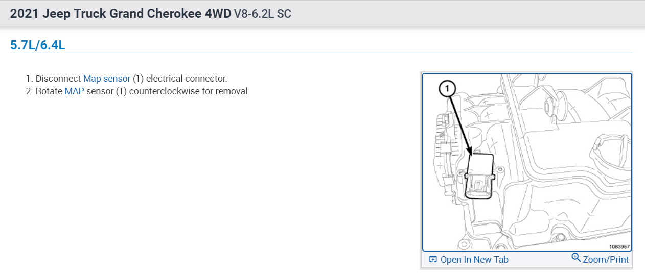

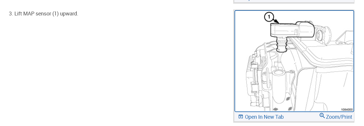

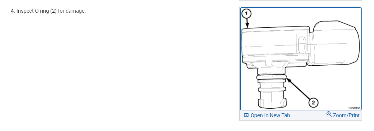

I would try a new MAP sensor it must be off a little. Here are the locations of the sensors in the diagrams below. Check out the diagrams (below). Please let us know what happens.
