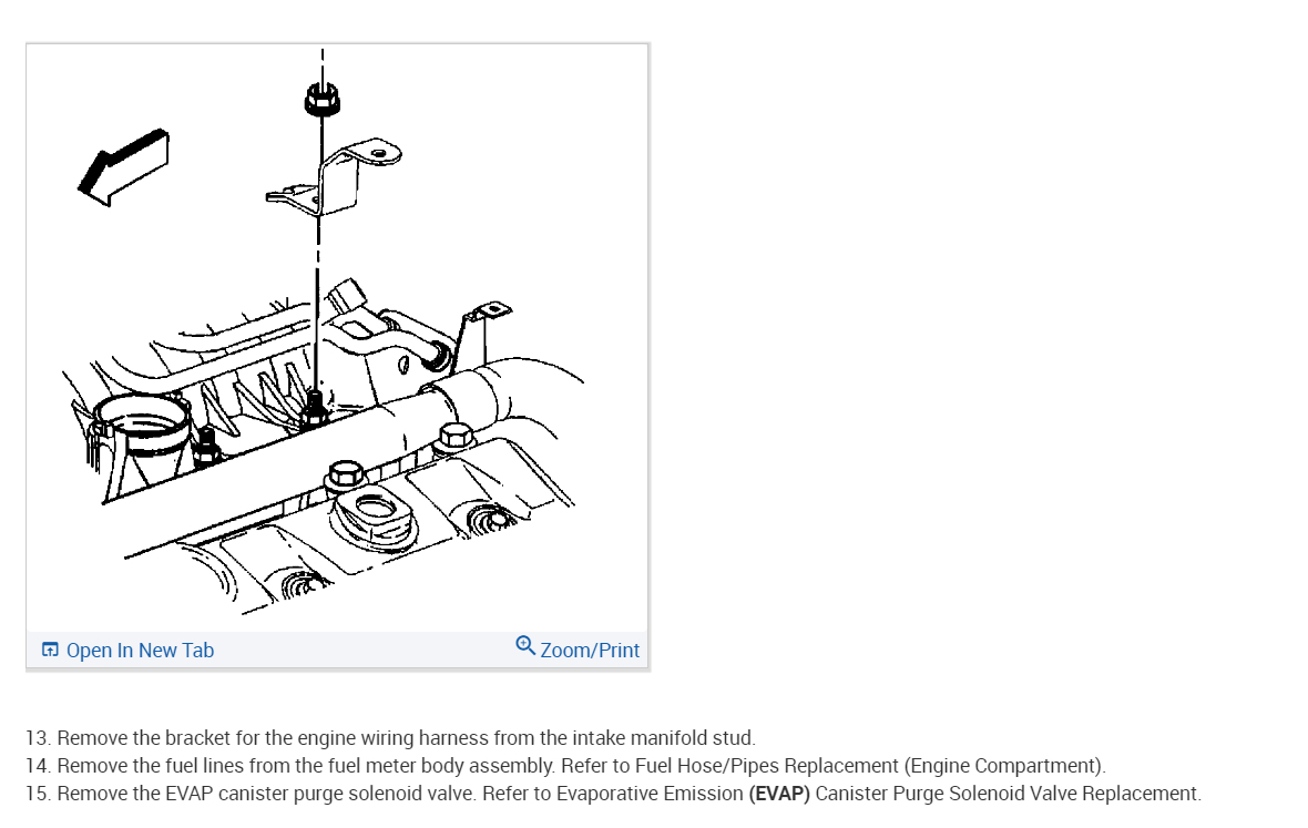

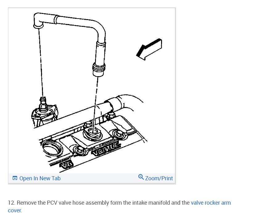

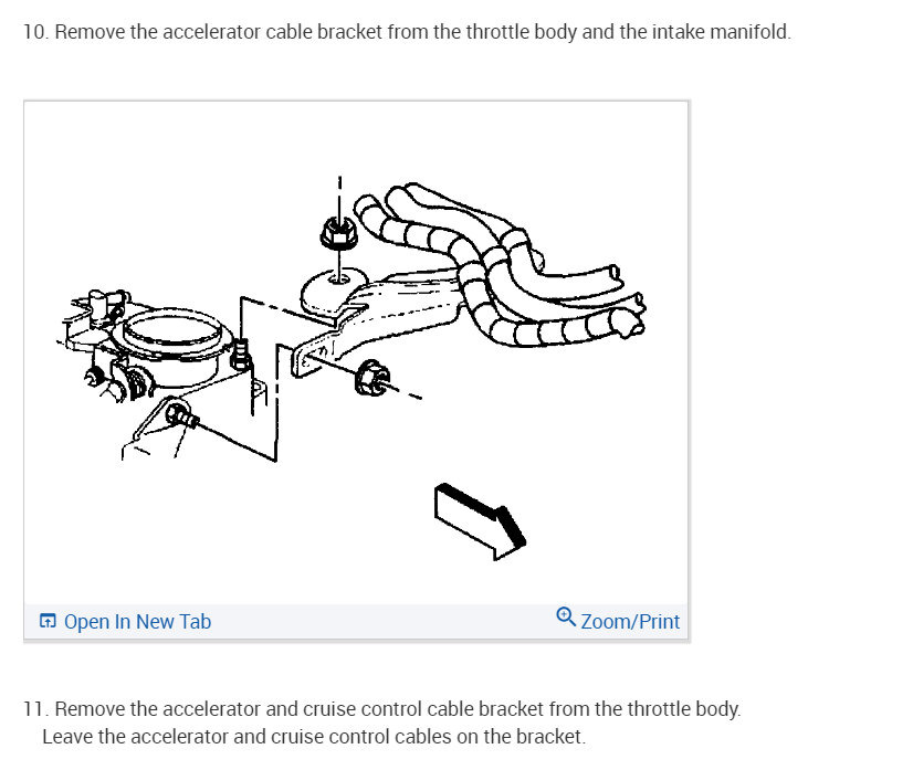

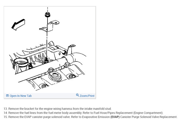

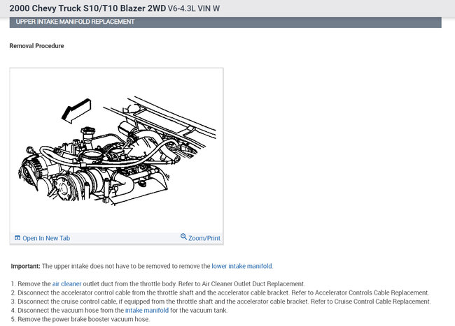

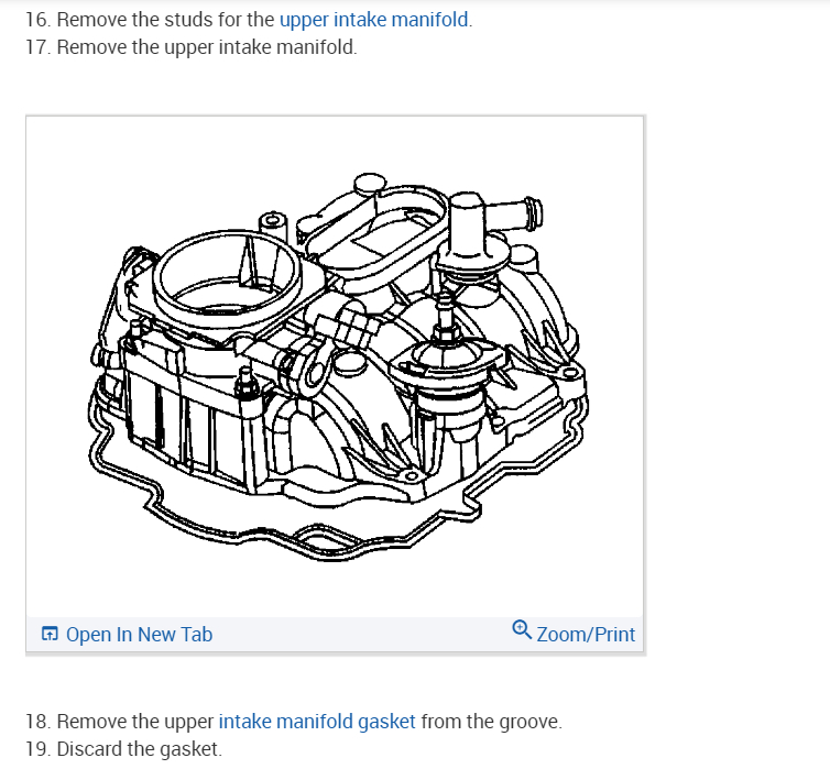

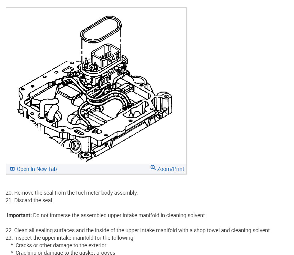

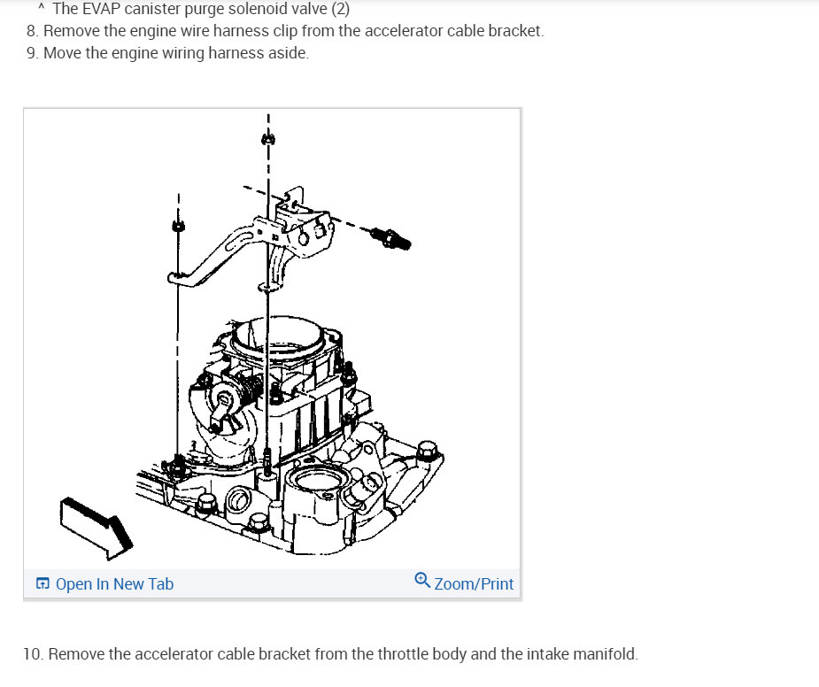

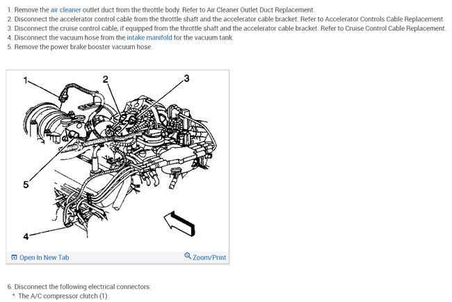

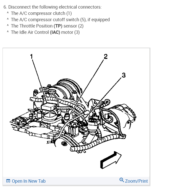

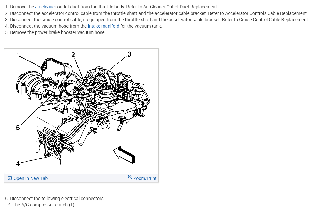

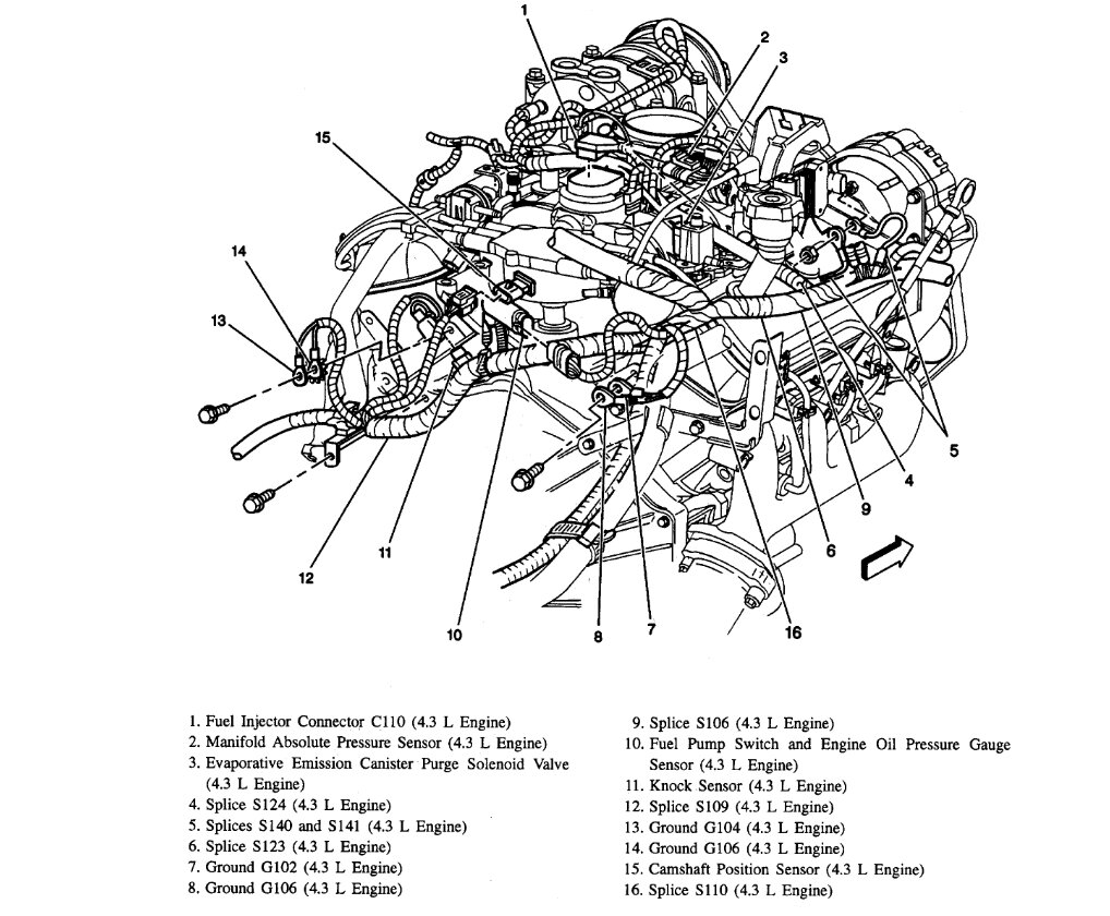

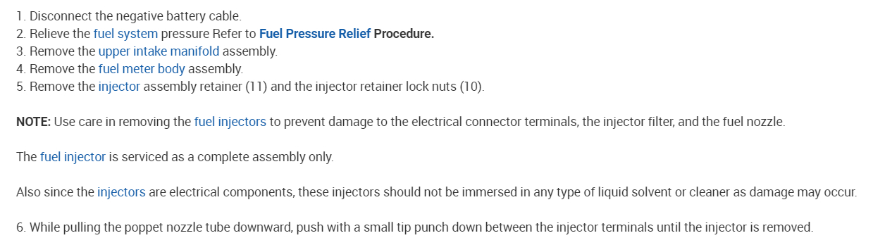

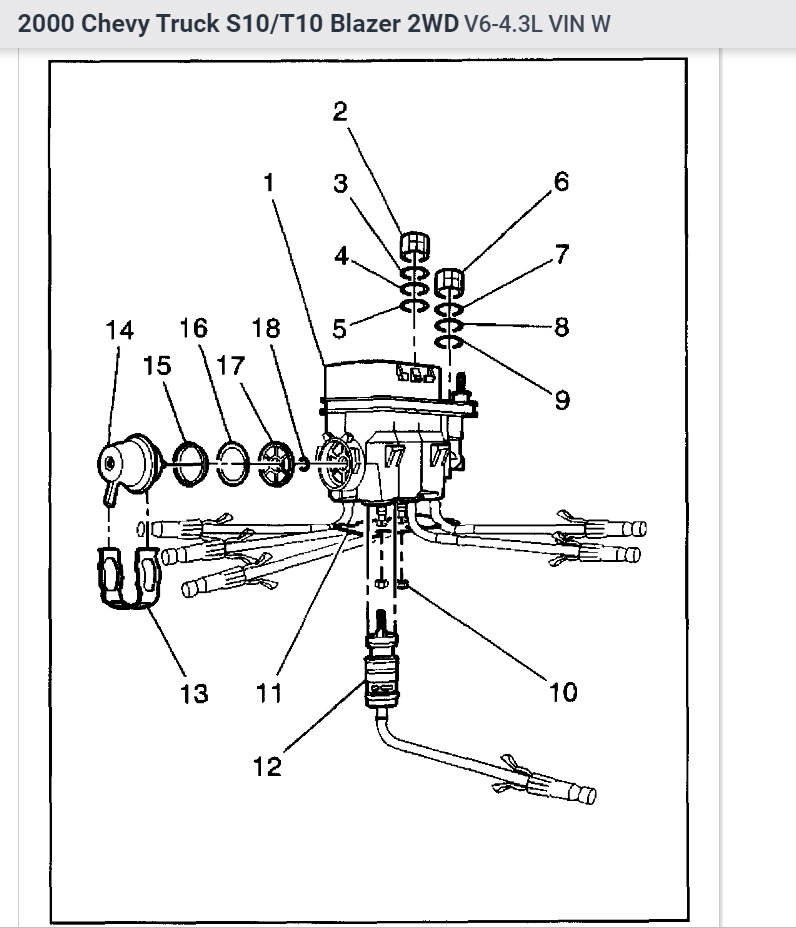

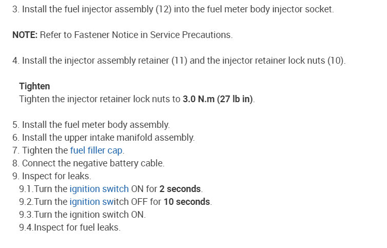

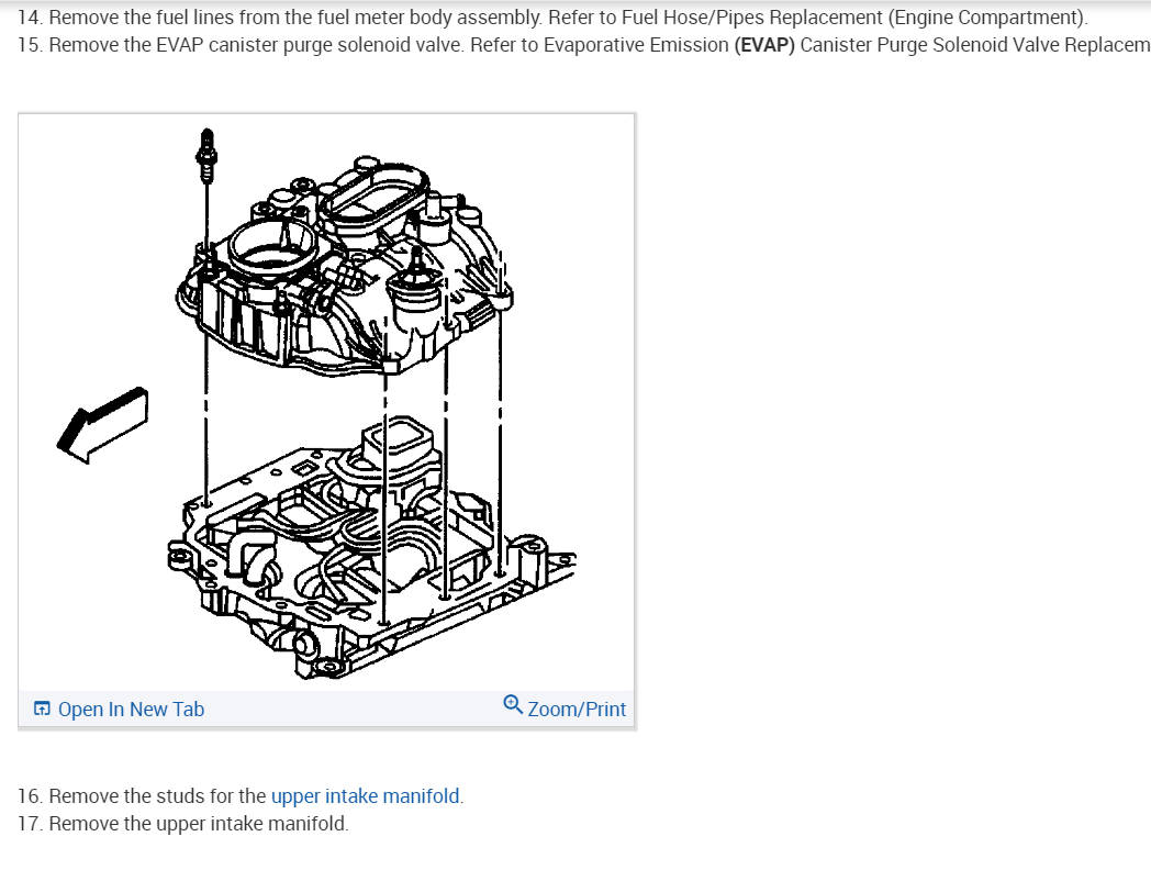

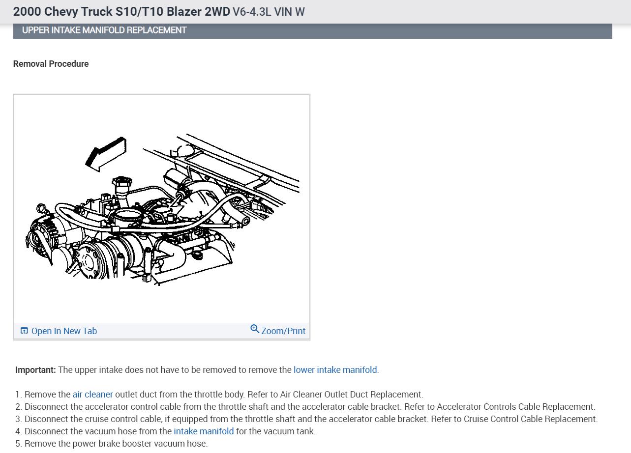

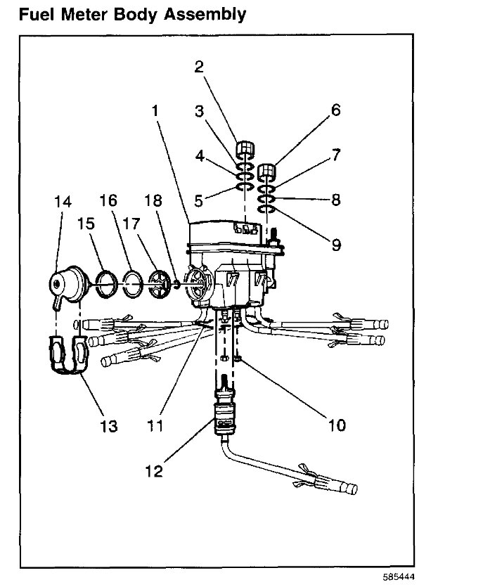

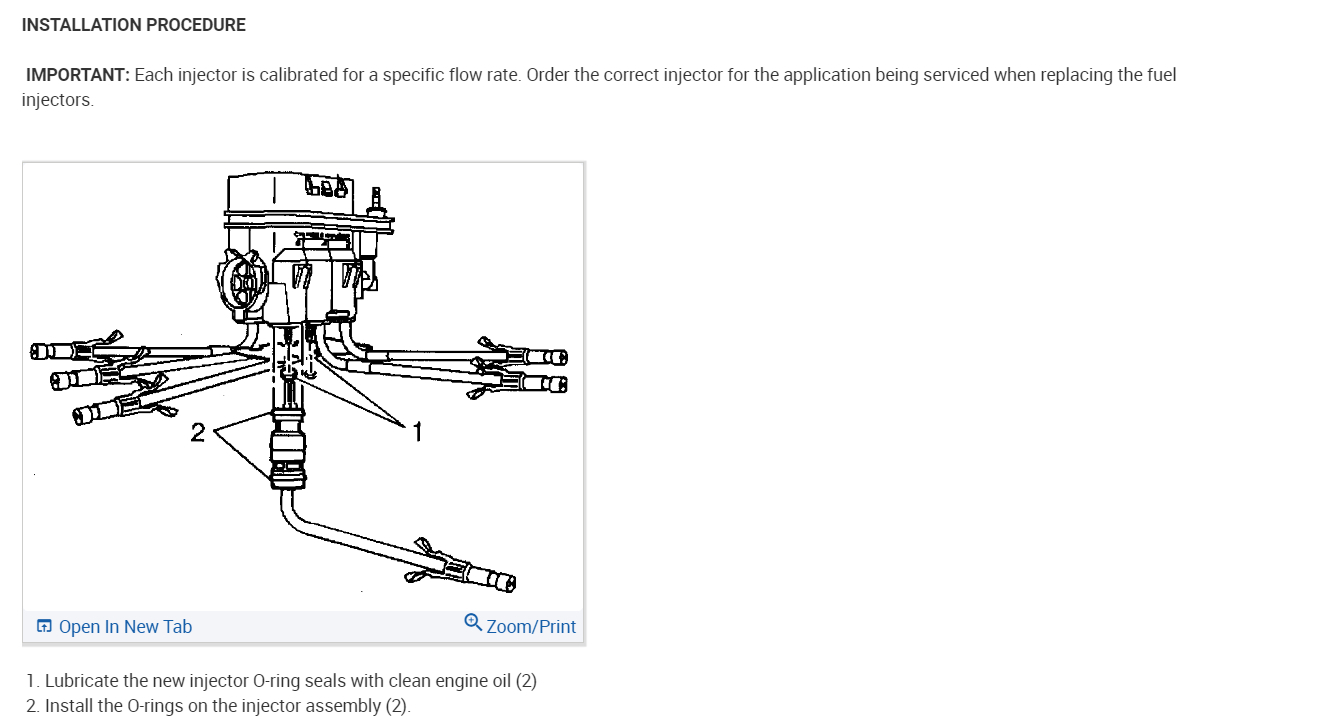

This can be caused by low fuel pressure, a vacuum leak or a bad spider injector which is common.
Here is a guide to help you check for the fuel pressure issue and the specs below:
60-66 PSI (413.7-455.1 kPa)
Use this guide when t engine is cold only:
If all is okay, I would suspect the spider injector inside the intake manifold. Please go over these guides and report back. Check out the images (below). Please let us know what happens.
