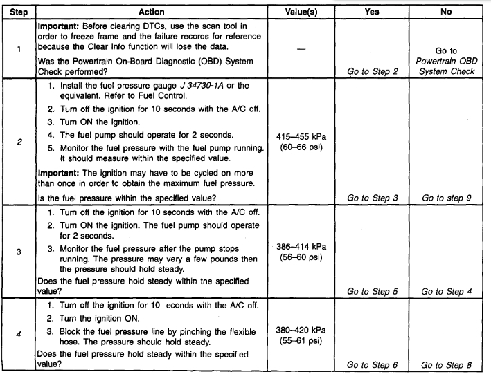

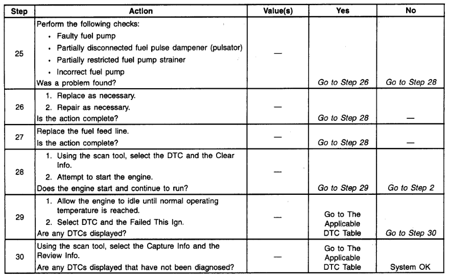

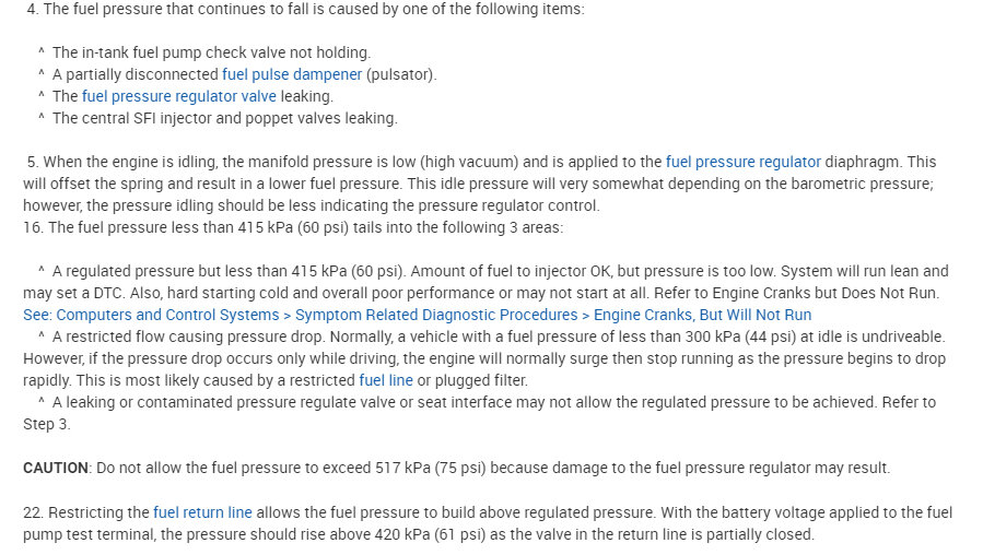

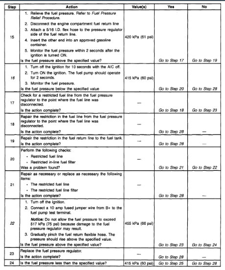

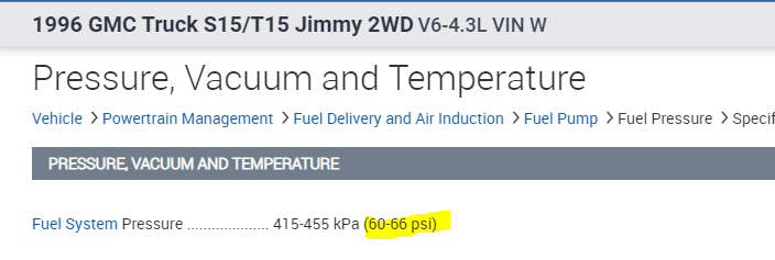

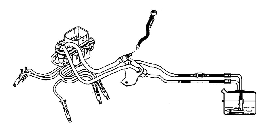

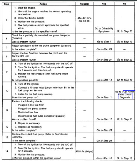

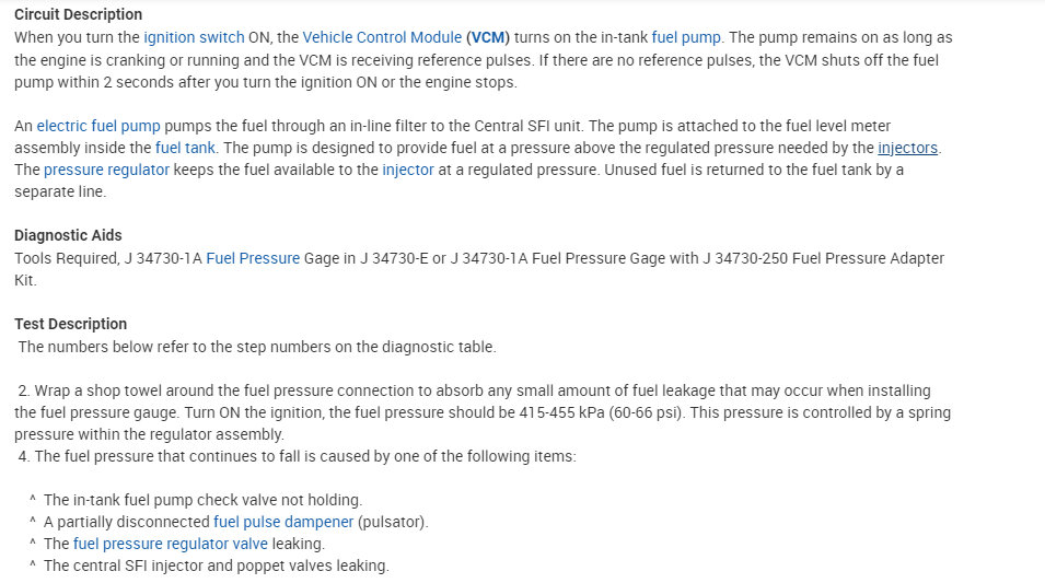

I’ve got the p0300 trouble code for multiple cylinder misfire. I’ve got rough idles, misfires, backfiring especially while driving, engine reviving a few hundred RPMs. I’ve checked, spark plugs, plug wires, distributor cap, rotor button, camshaft position sensor, timing, MAP sensor, and mass airflow sensor, throttle position sensor, and fuel filter and came up empty. My friend suggested checking the ignition coil and ignition control module, but they were replaced within the last year so I’m leaning more towards fuel. any advice?
