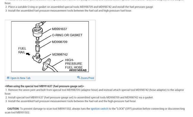

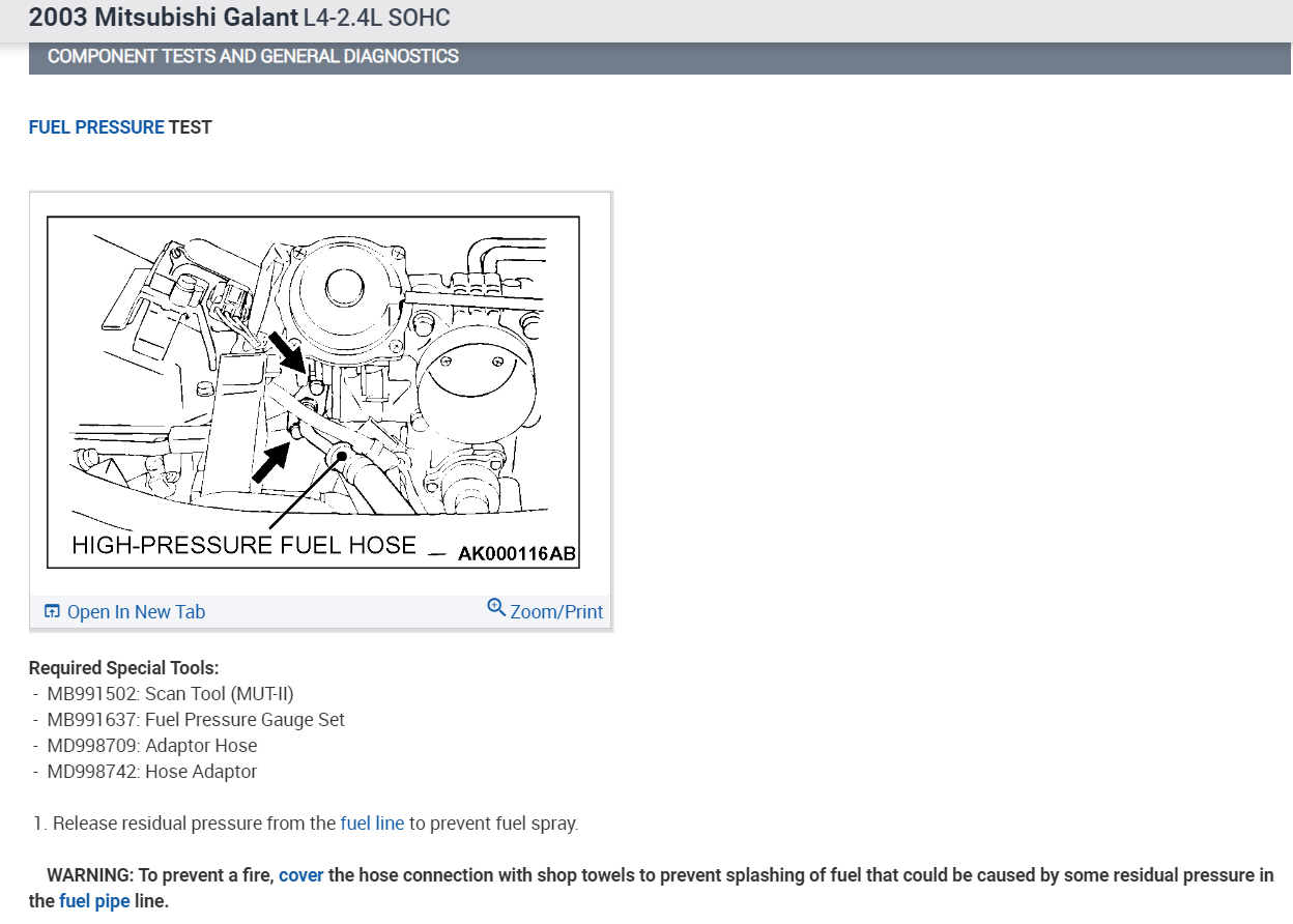

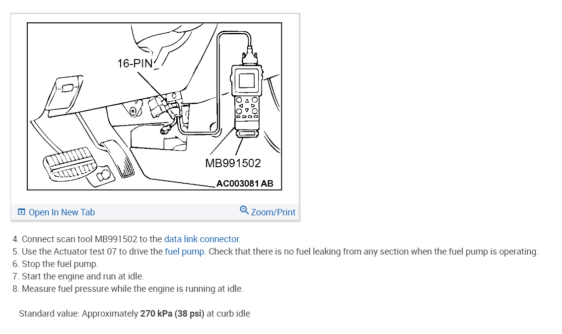

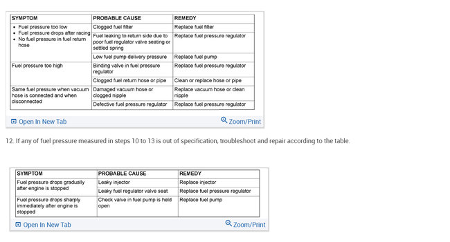

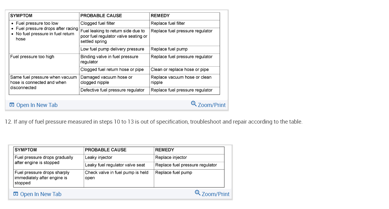

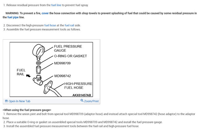

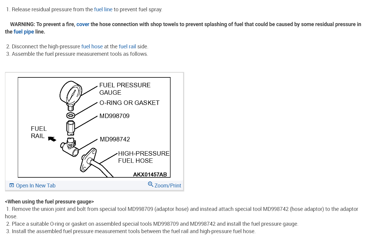

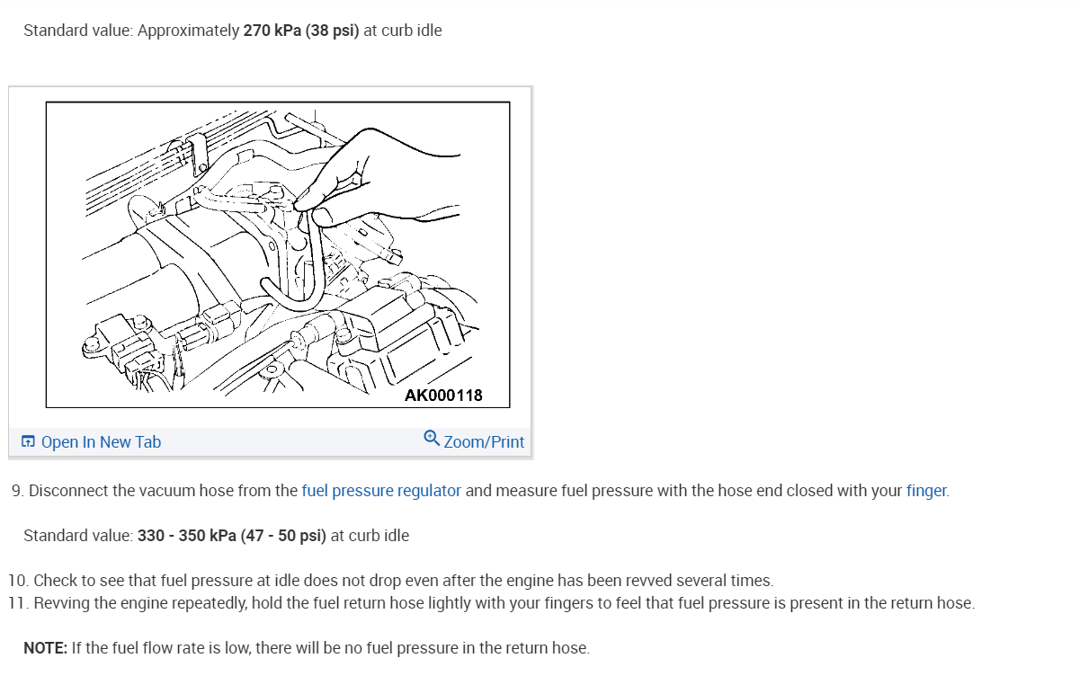

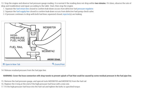

Yep, this is a random engine misfire code, which can be one of two things, either you have a weal fuel pump or the MAF sensor is going out. Let's start with the fuel pressure which you get rent a gauge for at the auto parts store. This guide can help you see how to do the job with diagrams below to help as well:
Fuel pressure
ITEMS .................... STANDARD VALUE
Vacuum hose disconnected .................... 330 - 350 kPa (47 - 50 psi) at curb idle
Vacuum hose connected .................... Approximately 270 kPa (38 psi) at curb idle
Check out the images (below). Please let us know what you find.

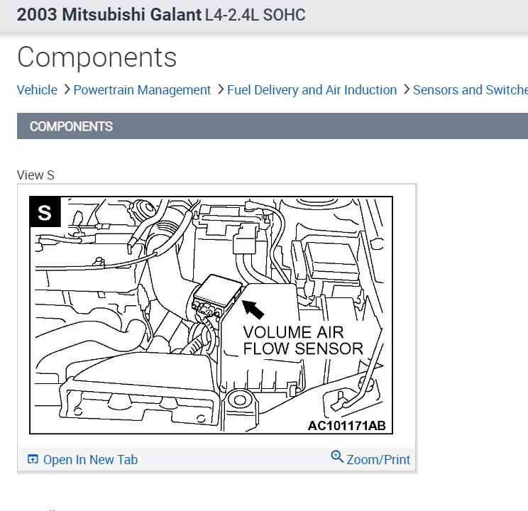

Yes, it could take apart the coils again and looks for bad connections. Also, if you can upload a short video of how the engine runs, I can tell you what's going on. Try to unplug the MAF sensor to see if it changes.
