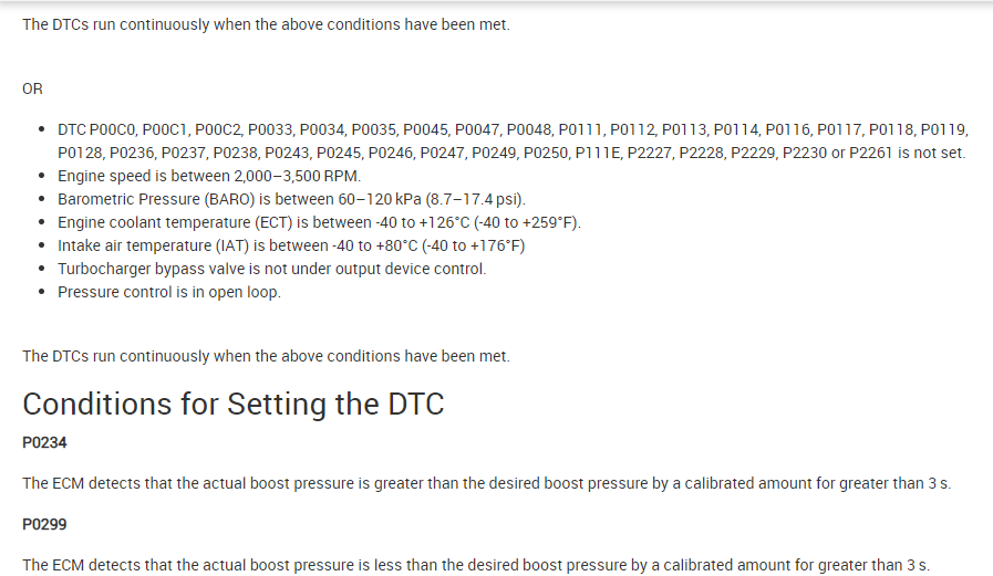

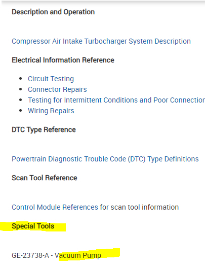

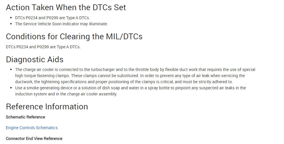

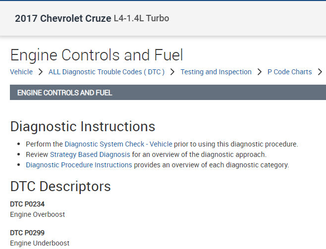

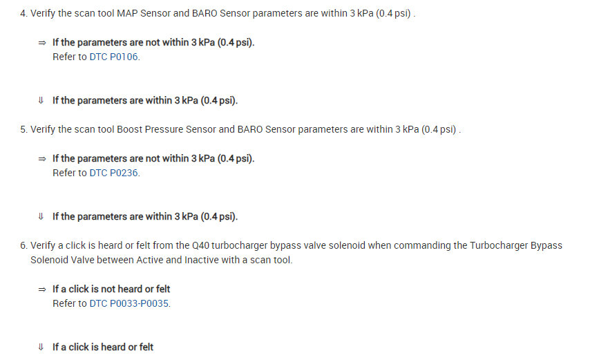

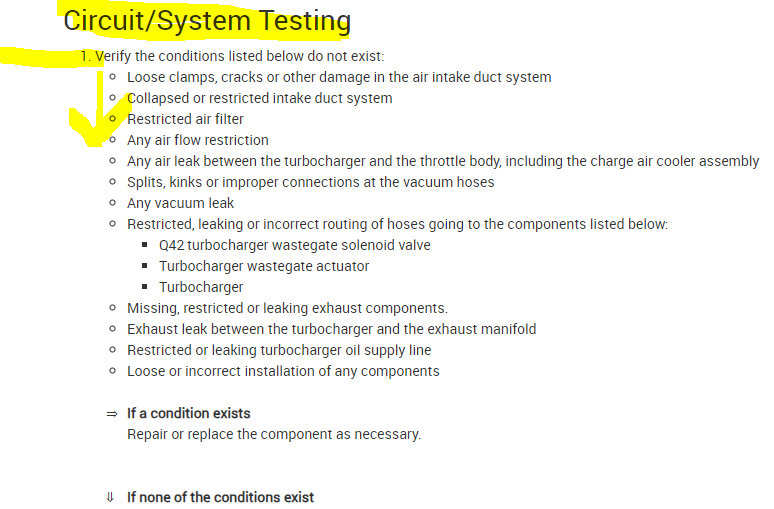

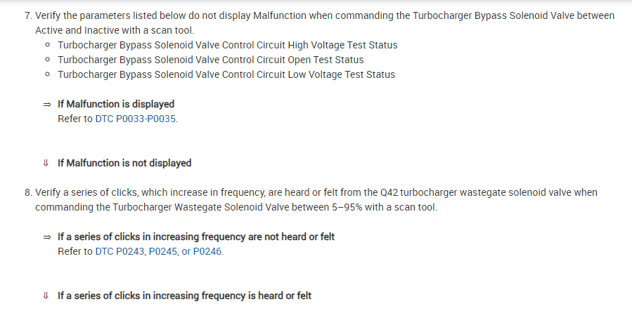

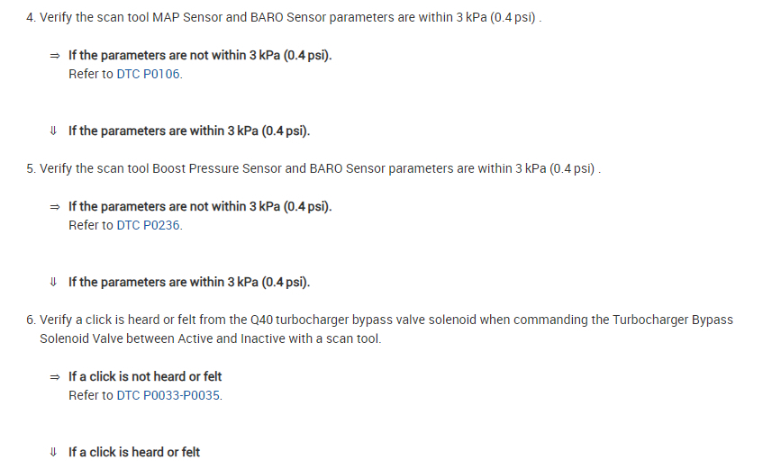

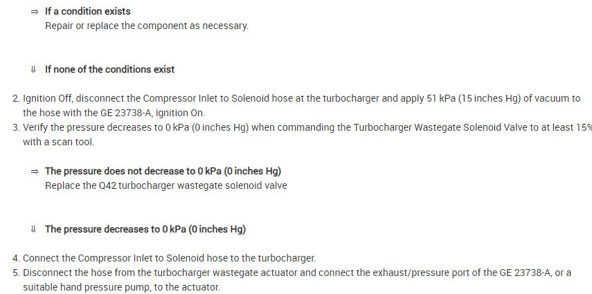

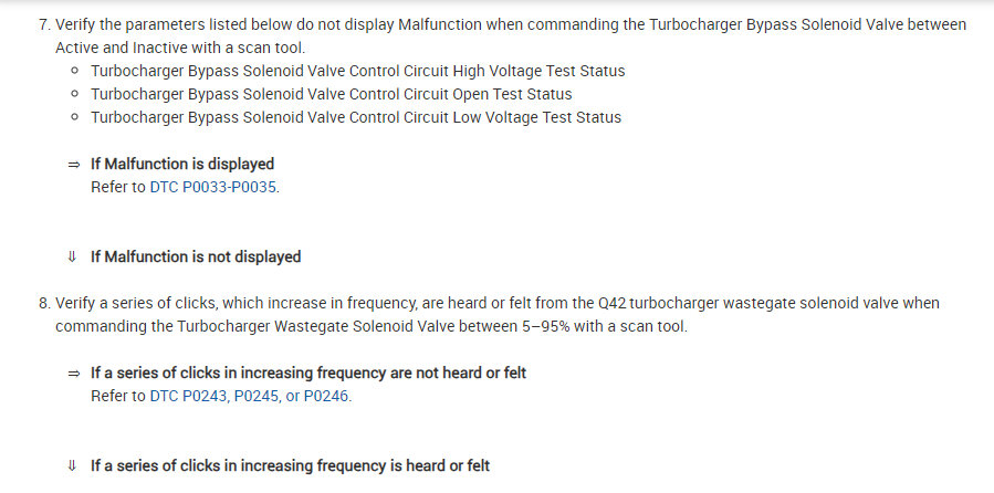

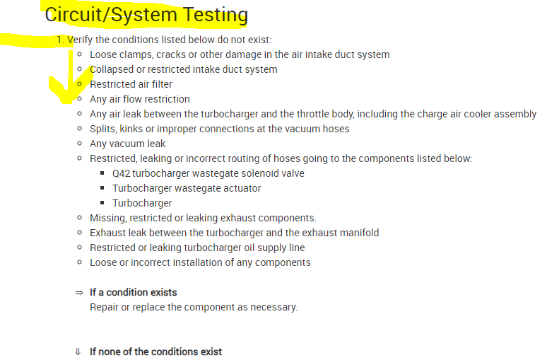

My code has been on for a few months now I drive the car everyday.
When I clear the code it will stay gone until I accelerate past 60mph then the code with come on. I can clear it and then do the same thing and the code will be back on.
Could it be my wastegate actuator? Any sensors?
