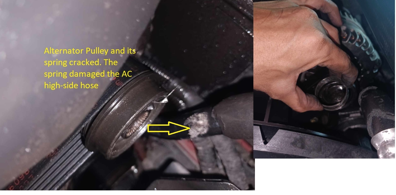

1. Two weeks ago my alternator pulley cracked , the spring inside the pulley 'flew' around the engine. Therefore causing multiple 'damages' to the aircon's high tube.
The following day, I had the pulley, high tube and freon topped up. Here's a picture of the damage before it was repaired.
Before the alternator was repaired, the battery were not charging.

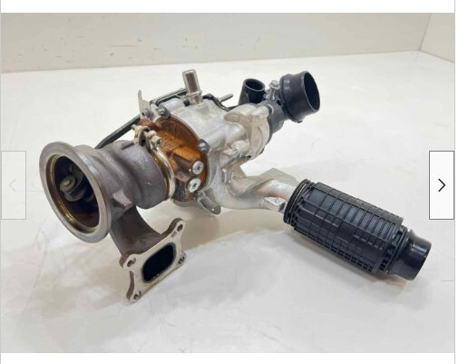

Here's what the code typically indicates and some steps to diagnose and address the problem:
P0299 - Turbocharger/Supercharger "A" Under boost Condition
So, I have seen the wastegate go bad and stay open causing this issue, here is how to change it out to fix the problem. Check out the images (below). Please let us know how it goes.
