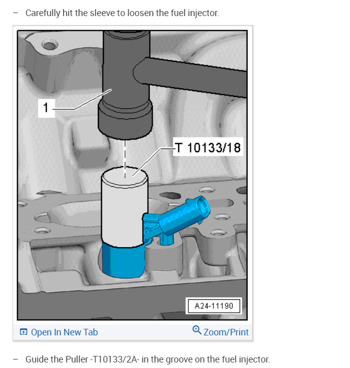

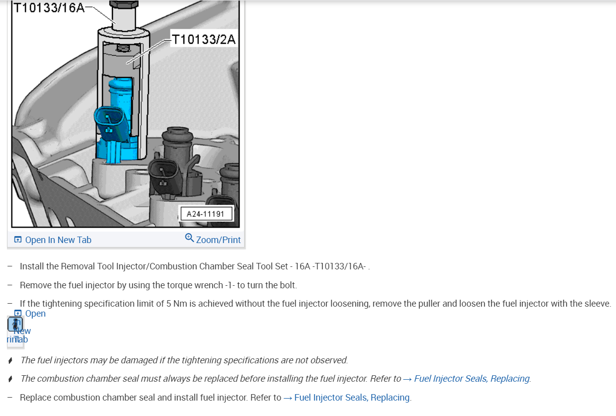

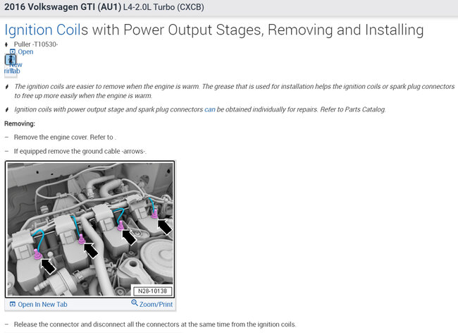

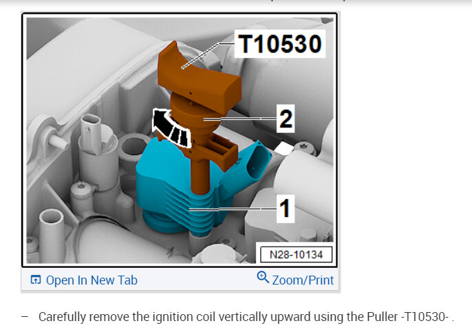

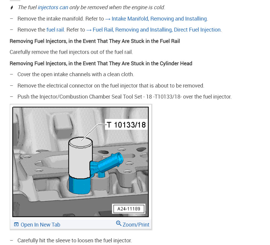

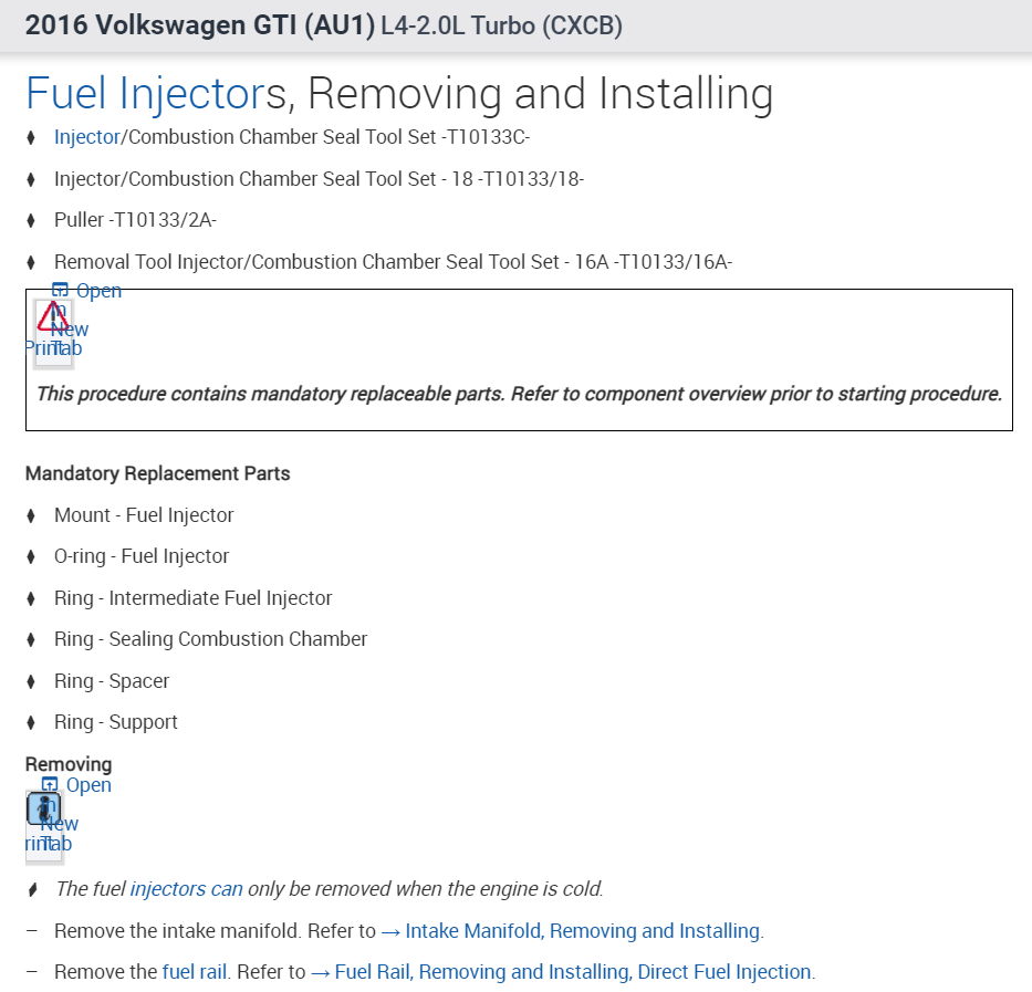

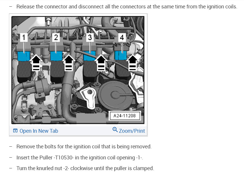

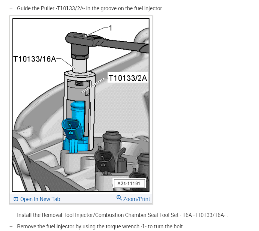

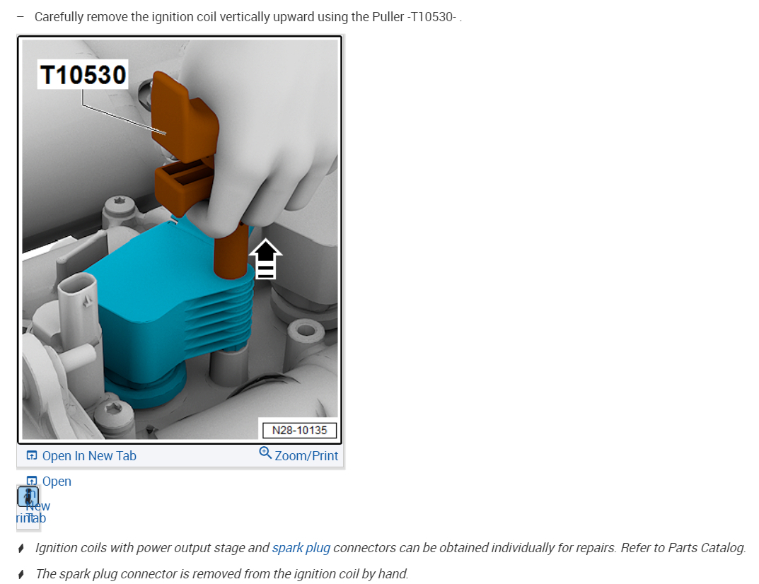

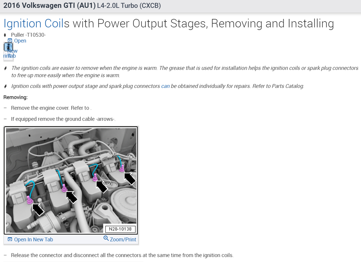

I would start by replacing the #2 spark plug it could be defective/cracked. If that doesn't make a difference the next step would be the fuel injector. Here is how to change it out in case you need it and I have included a guide you should go over as well.
https://www.2carpros.com/articles/engine-misfires-or-runs-rough
