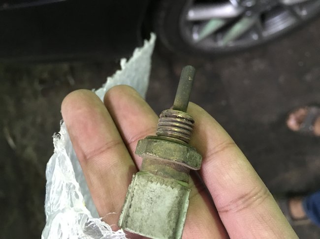

i replaced the sensor
the EOT sensor i got from the dealer is the one installed on the upper thermostat
that is also coolant sensor ??

no the eot sensor is at the bottom by the filter.
the one at the thermostat is the ect or engine coolant sensor.

everyone here told me that is a pressure switch. same which is near the crank pulley.
Jan 4, 2016 at 12:05 PM
it is a sensor which does both jobs
