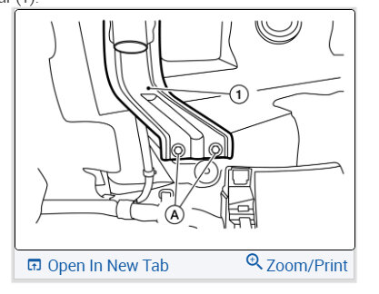

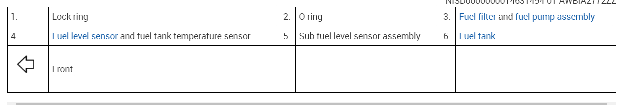

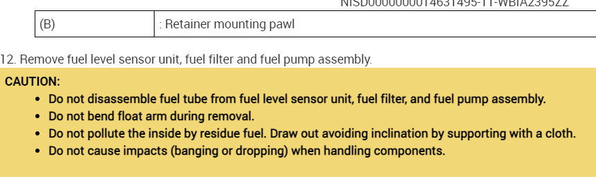

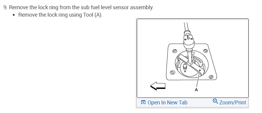

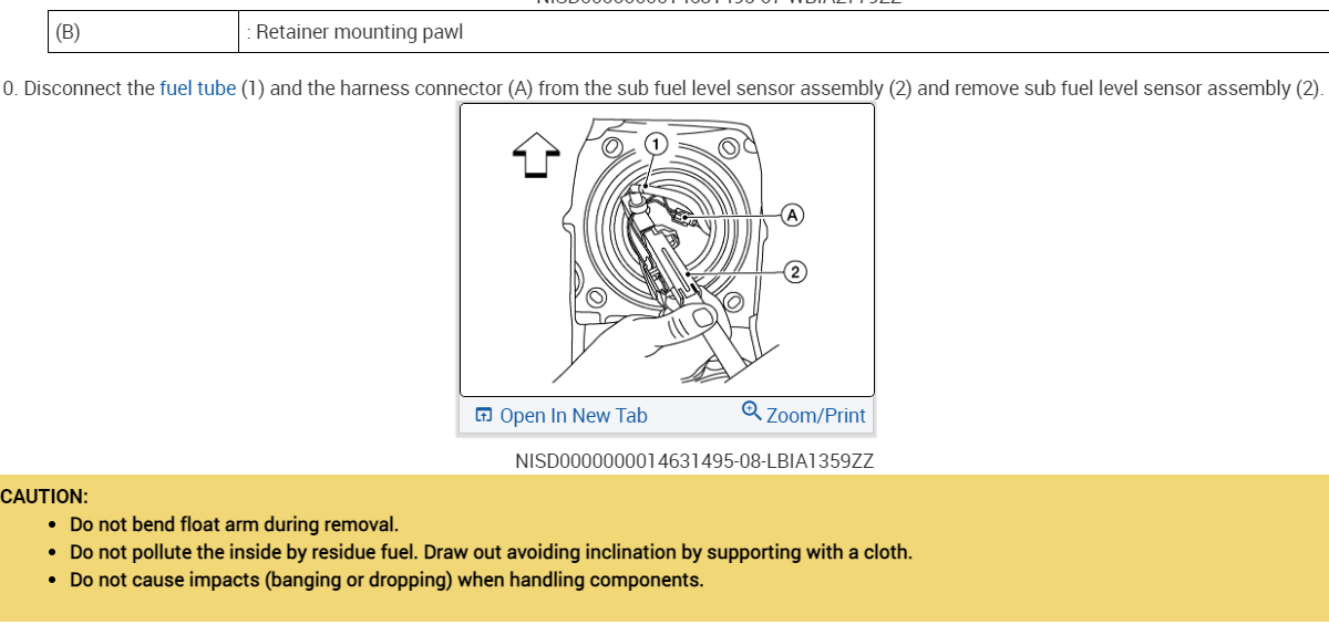

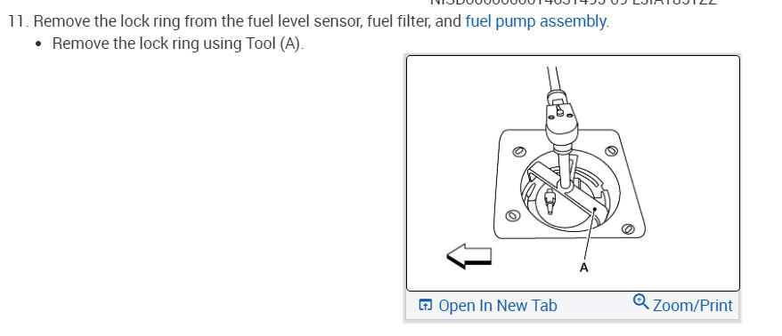

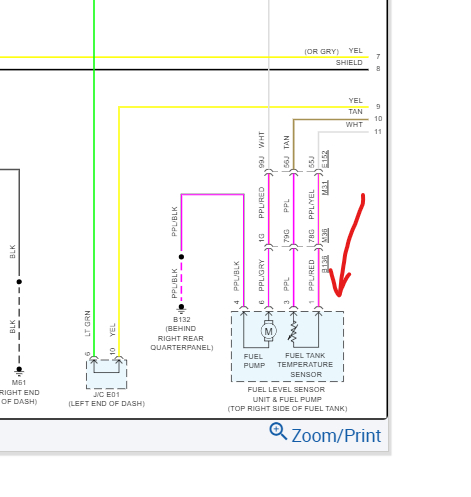

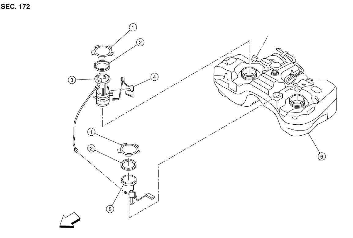

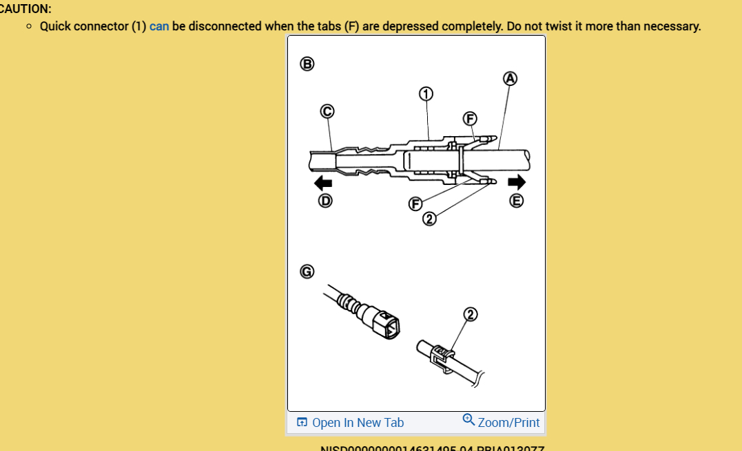

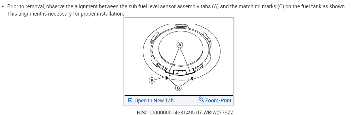

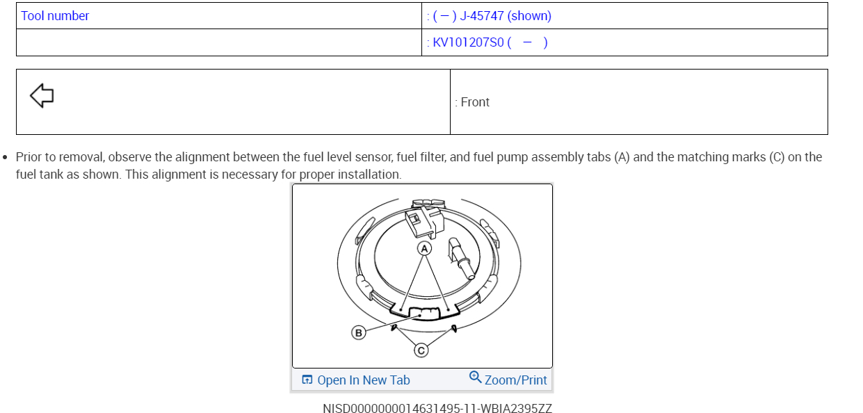

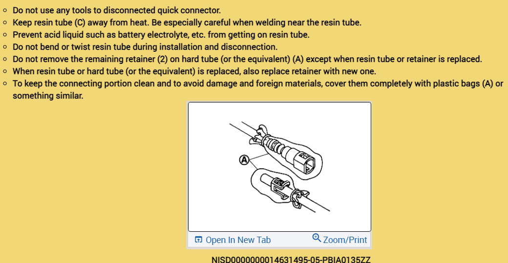

Yep, this is the code definition. P0181 is a generic OBD-II trouble code that stands for "Fuel Temperature Sensor 'A' Circuit Range/Performance".

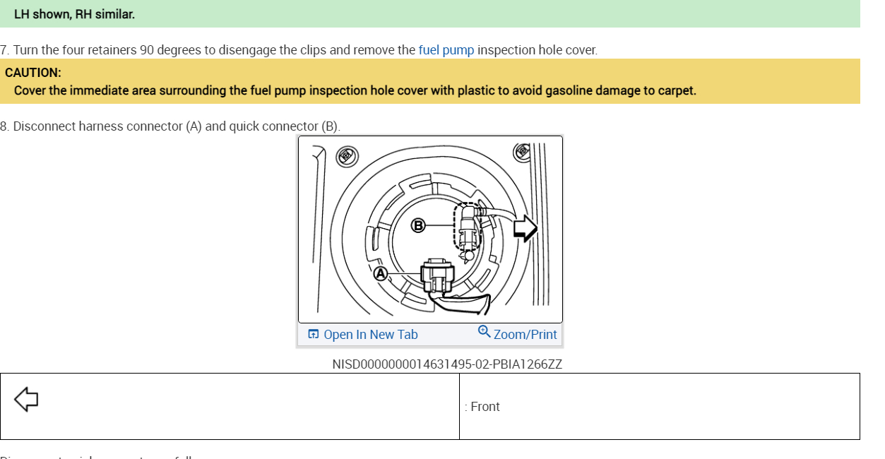

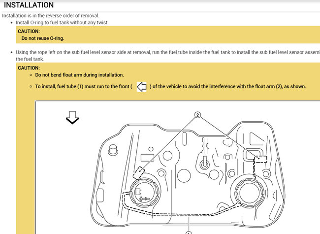

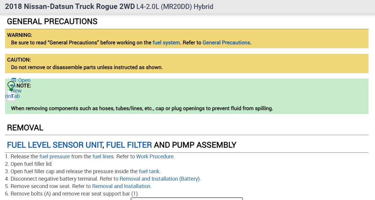

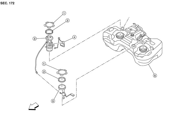

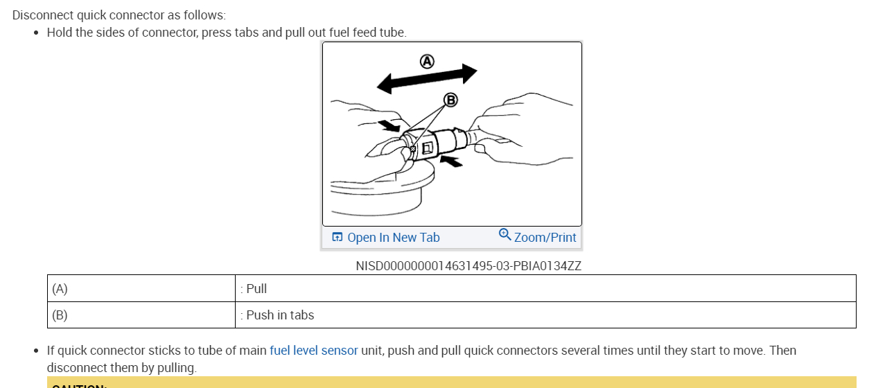

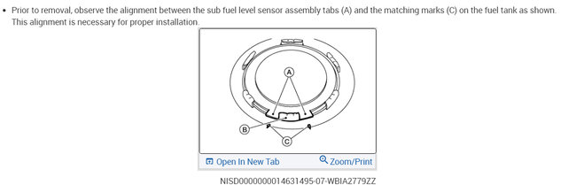

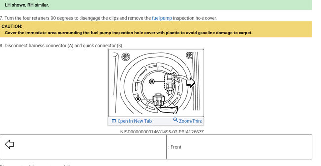

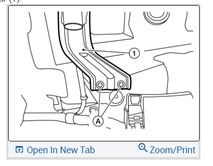

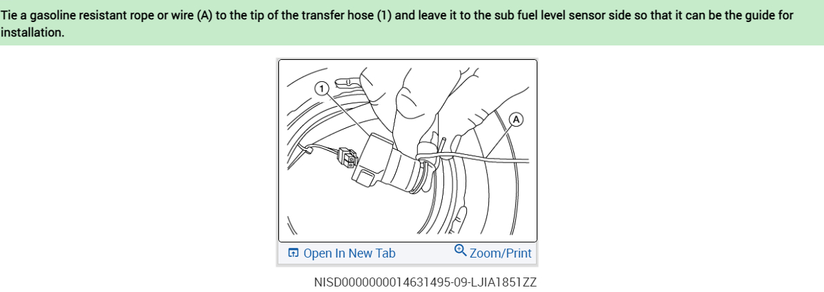

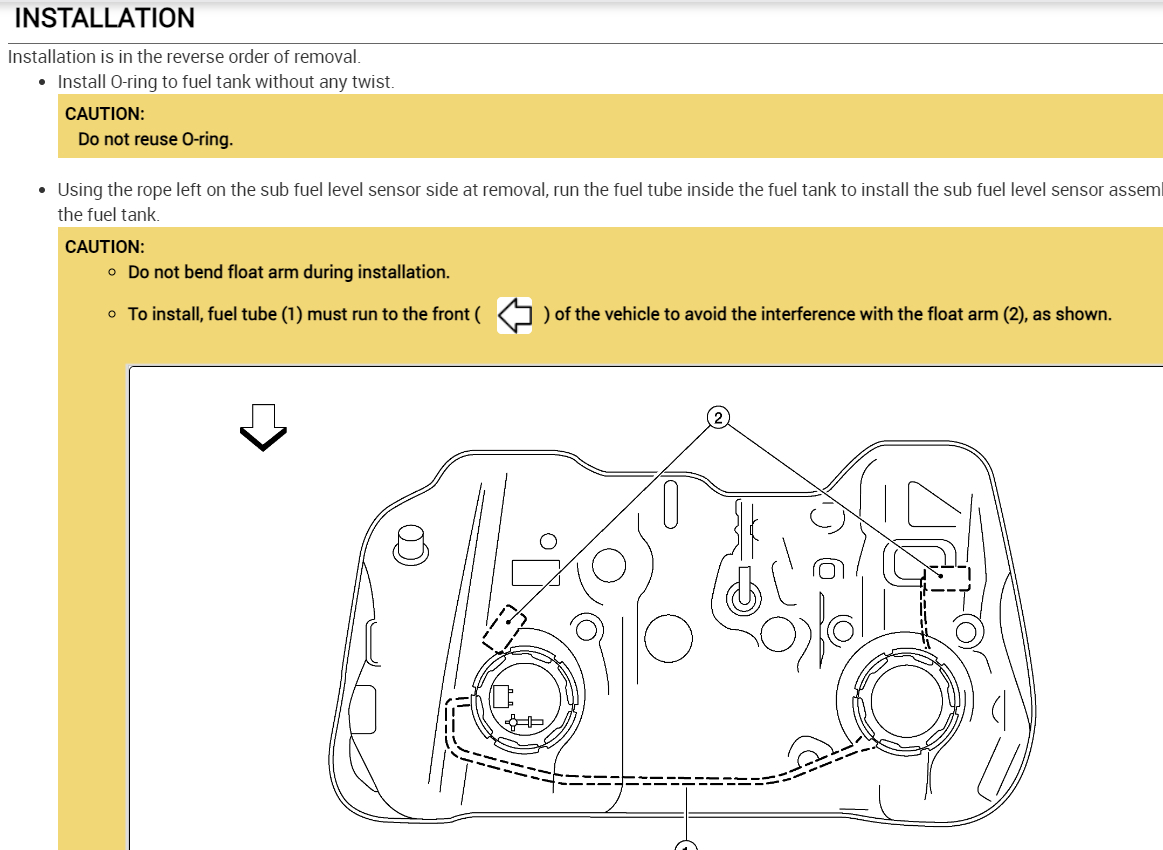

This sensor is part of the fuel pump, here are the wiring diagrams so you can confirm the placement. Here is the labor to do the job and I have included how to do the work yourself as well.
In Tank fuel pump @ 1.5 HRS
Check out the images (below). Please let us know if you need anything else to get the problem fixed.
