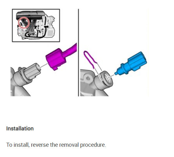

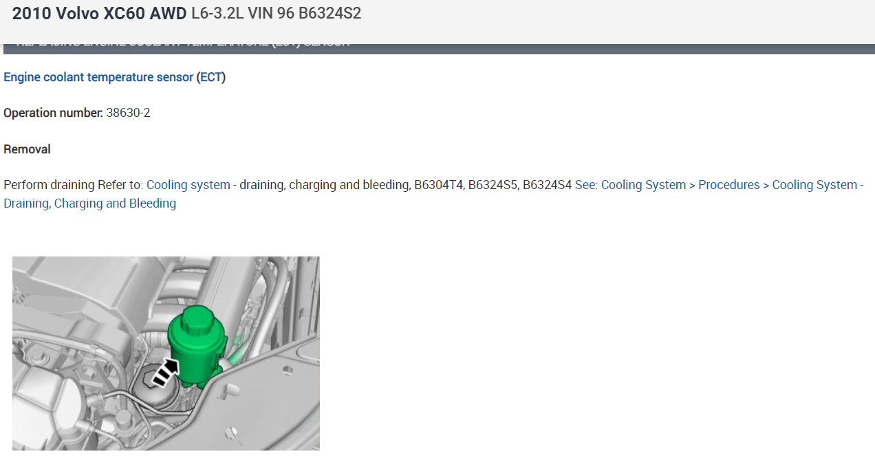

What reading does the scanner say is the temperature of the coolant sensor? Here is the location in case it is way off.

One picture show what looks like a power steering reservoir. Do you mean it's in the coolant reservoir?

That's a good sign it is not an injector, it looks like the coolant sensor is behind the power steering reservoir.
