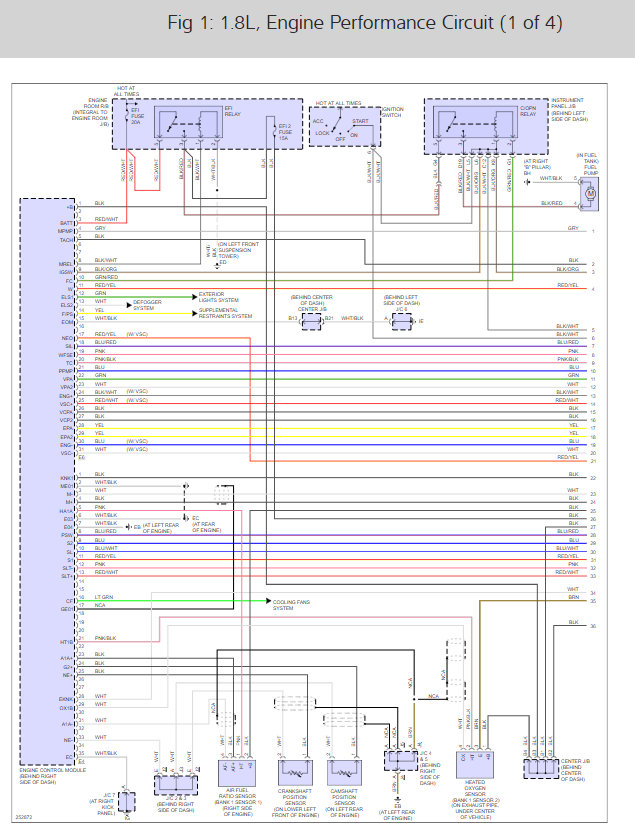

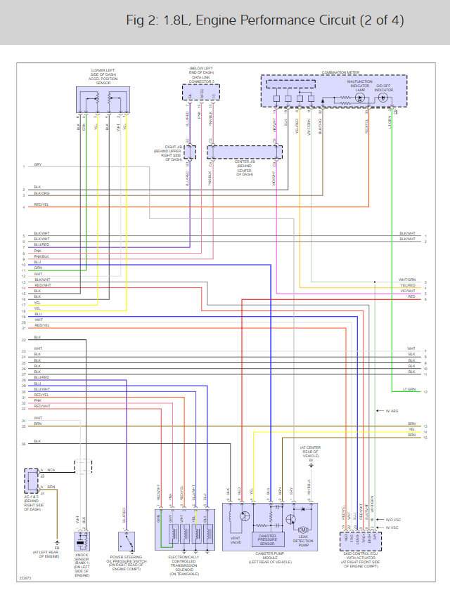

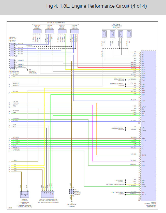

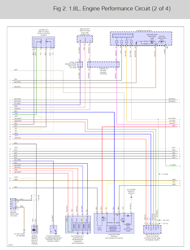

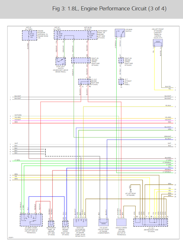

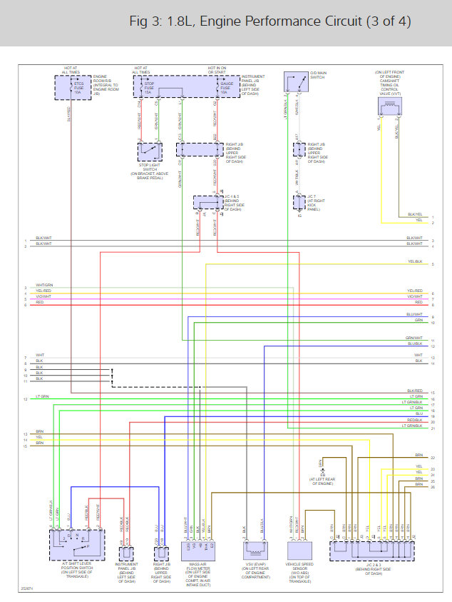

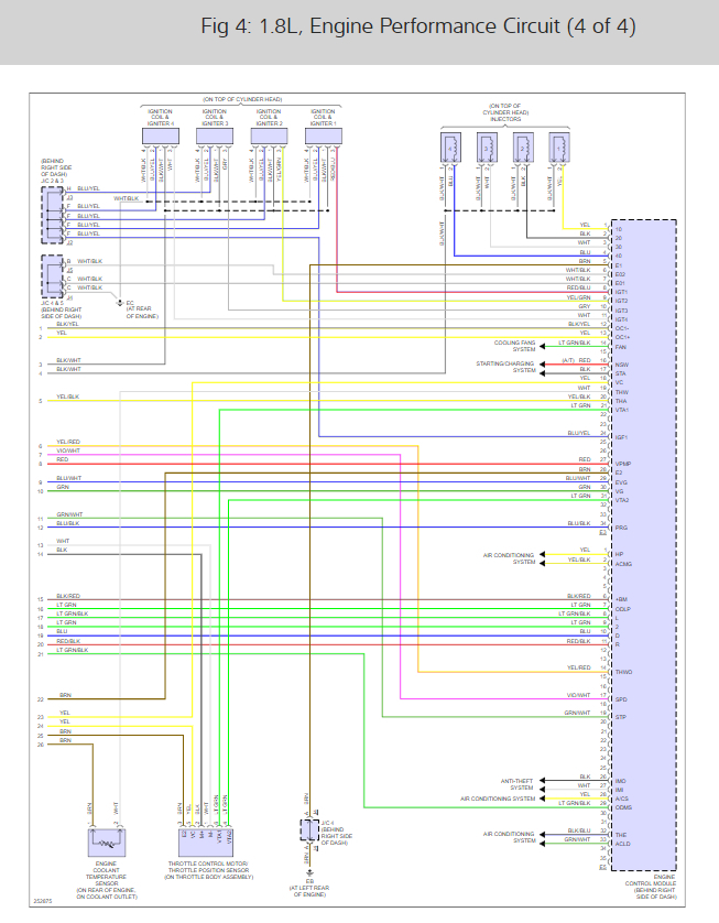

Hello, my car has four fault codes and I am trying to remove them. I bought the camshaft position sensor for the P0340 code and I will be installing that this Thursday when it arrives. The other three codes have been an ongoing problem and is becoming very frustrating. I have done several tests on the MAF wiring according to various sites online and it has come back with good results. I also replaced the MAF with an OEM Denso brand with no results. Is there a wiring diagram that I can look at or something because there has to be an issue with the wires since these codes will not go away? I started to peel back the the tape and the wires just seem to be never ending and it would really help if I knew where the ground was instead of trying to peel back all of the tape. I have had the car smoke tested for a vacuum leak as well and it does not have any. Spark plugs were recently replaced as well as the intake and valve cover gasket. Help!
