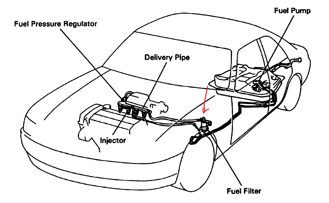

The first thing I would do is change the fuel filter which will restrict the amount of fuel the engine is getting causing the lean code, here is a guide that can help you understand the lean code as well.
https://www.2carpros.com/articles/repair-lean-mixture-codes-p0171-or-p0174-on-some-manufacturers
Here is the location of the fuel filter so you can swap it out. Check out the images (below). Please let us know what happens.
