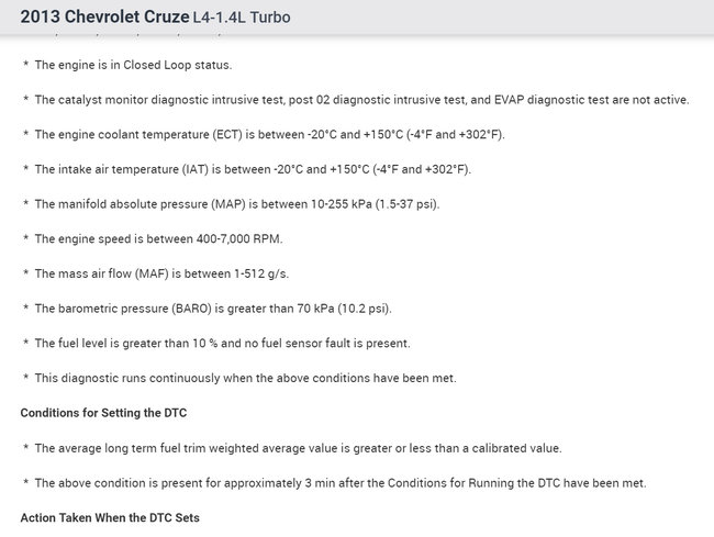

My check engine light started blinking then stopped and doesn't show. I have had a P0171 code before when it came on. Just curious as to what it could possibly be, without buying many different things.

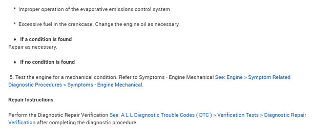

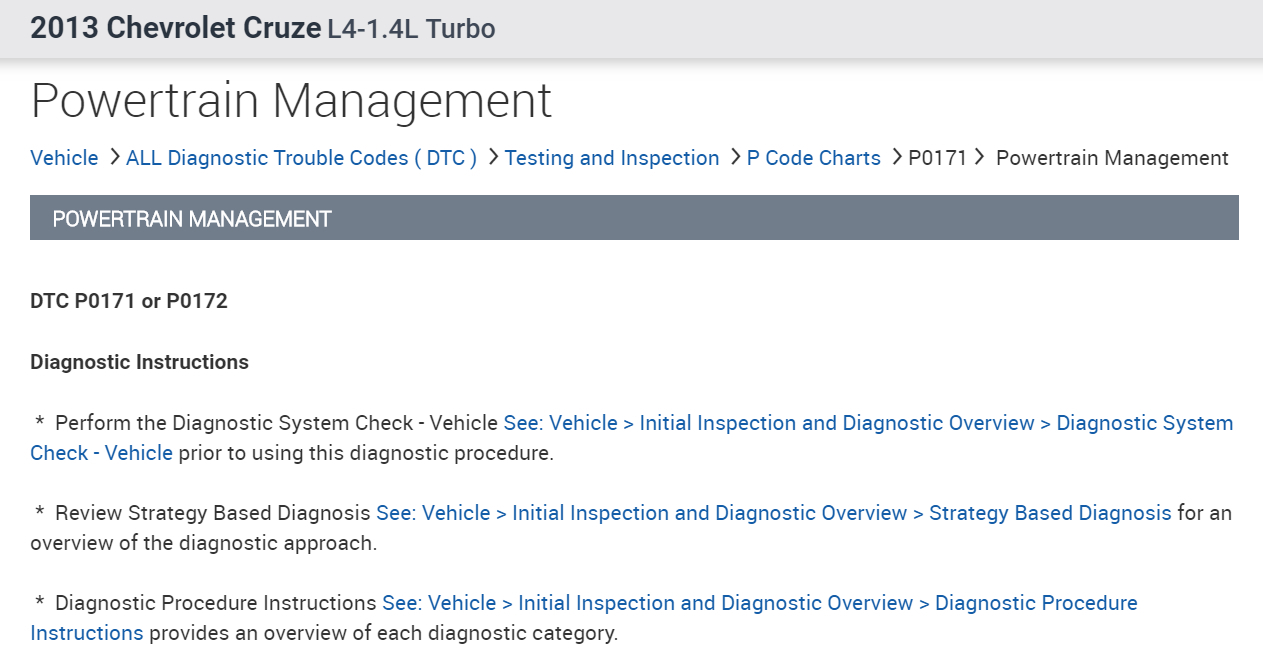

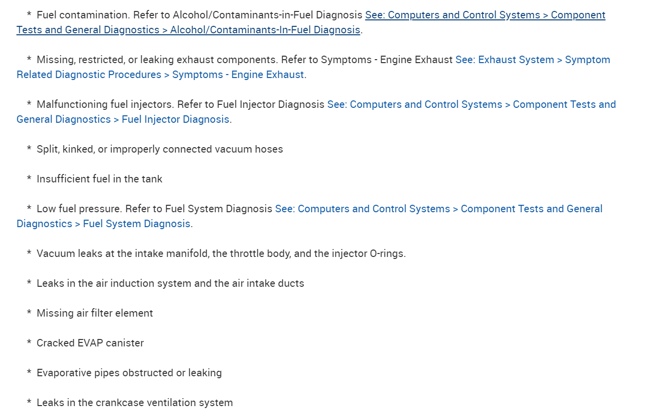

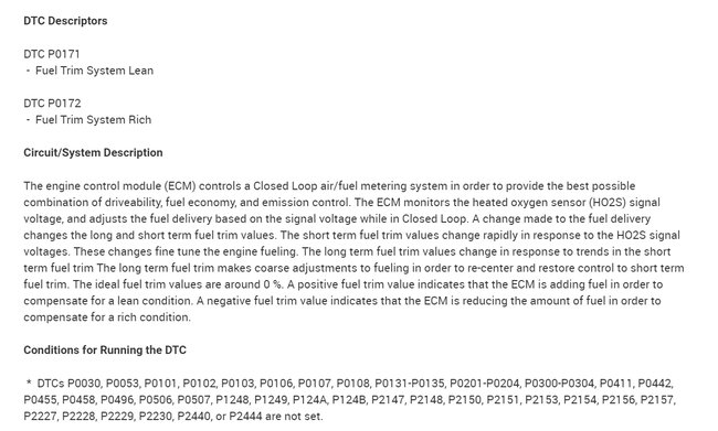

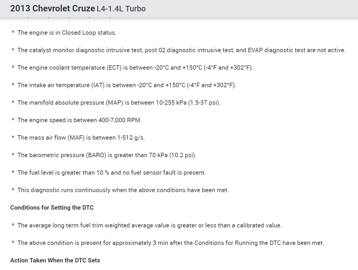

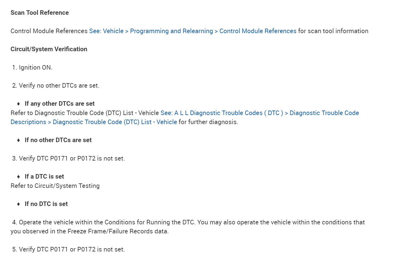

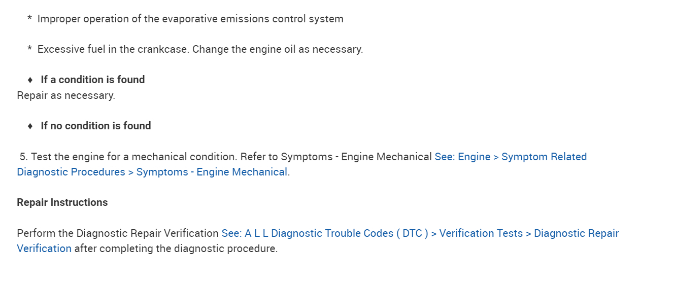

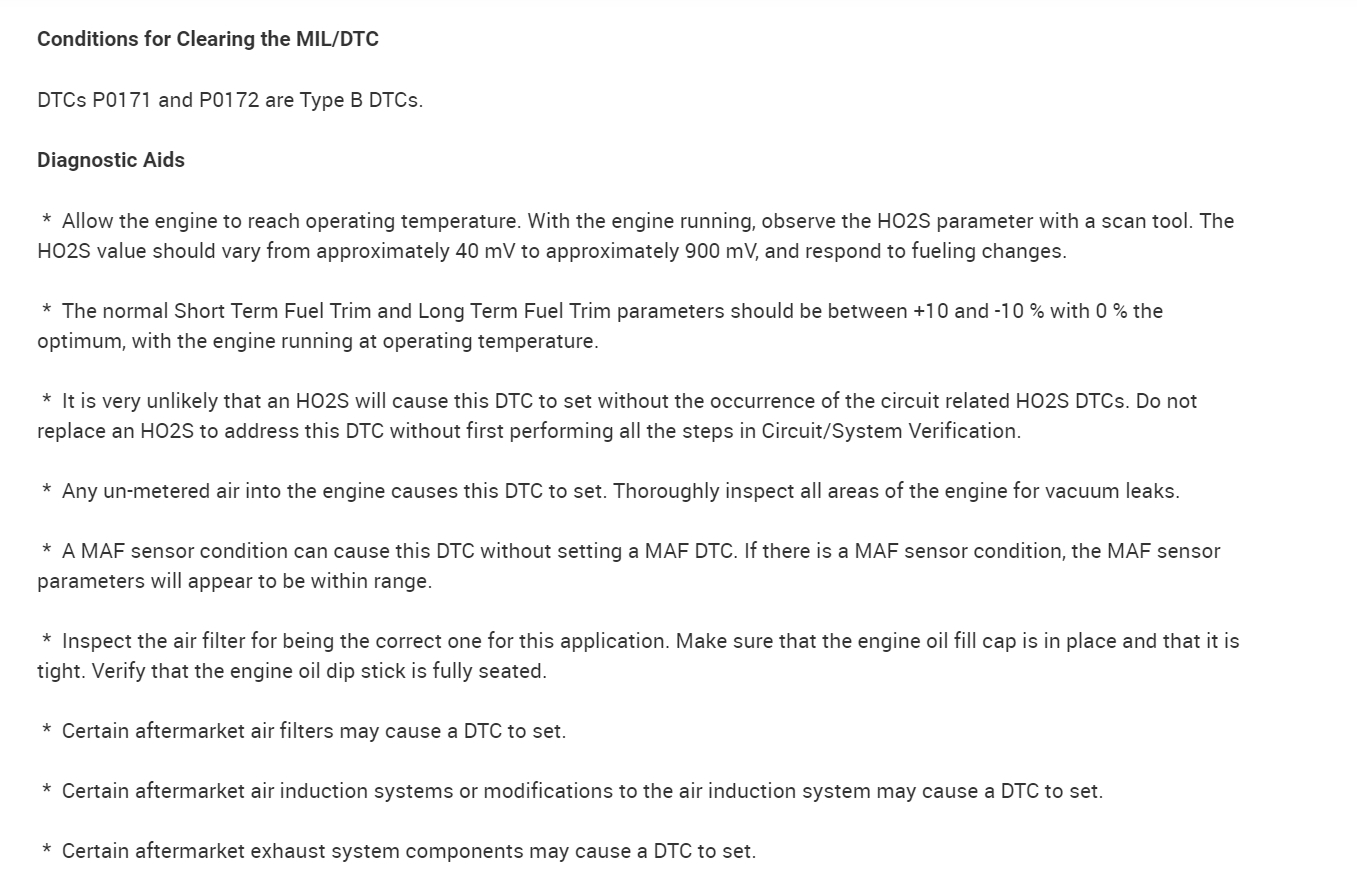

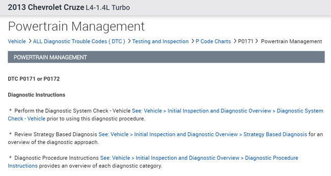

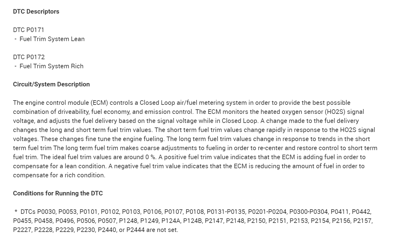

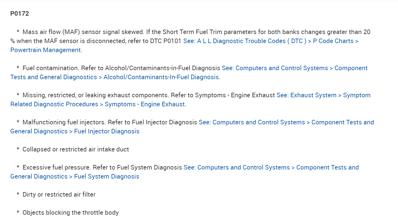

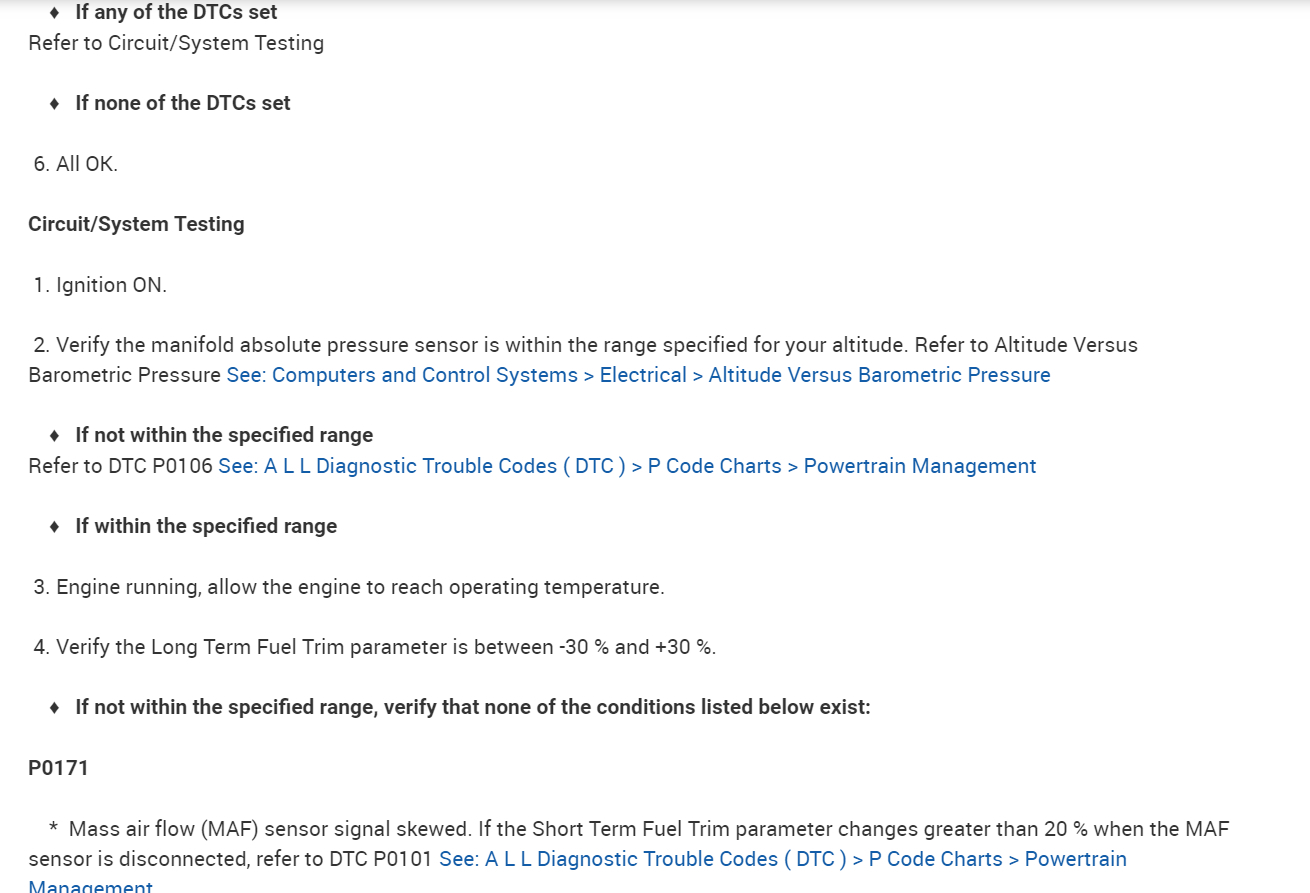

In the diagrams down below I have included the factory diagnostic troubleshooting guide for your vehicle for Direct Trouble Code (DTC) P0171. Please go through this guide and it should lead you to the problem with your vehicle, allowing you to fix it right the first time, without having to throw parts at the problem, wasting time and money. Please get back to us with what you are able to find out.
Thanks,
Alex
