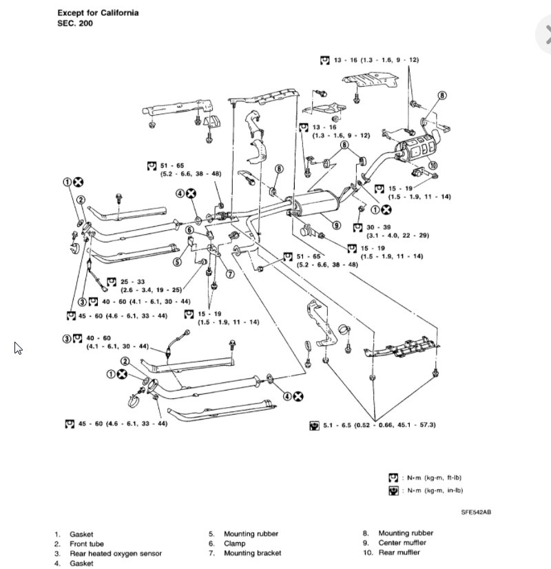

KASEKENNY1: I wrote the following up based on my take on this O2 Sensor Grounding Issue. This is what I'm going to do before spending a lot more to have O2 Sensors installed. I have a 2000 Infinity QX4, but this also applies to certain Nissan vehicles also. If you approve and would like, we can put this in the Nissan section or wherever, there's lots more Nissan's affected by this than Infinity's. Please let me know if you want to make any changes, it’s correct to the best of my knowledge. I'll let you know my results after I install the DIY repair. Thanks, hope this helps someone else.
