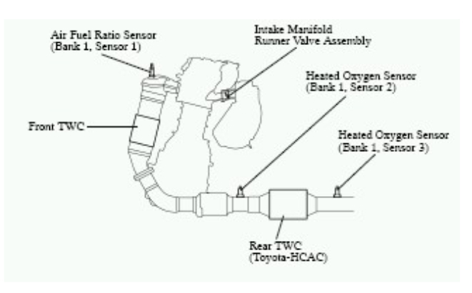

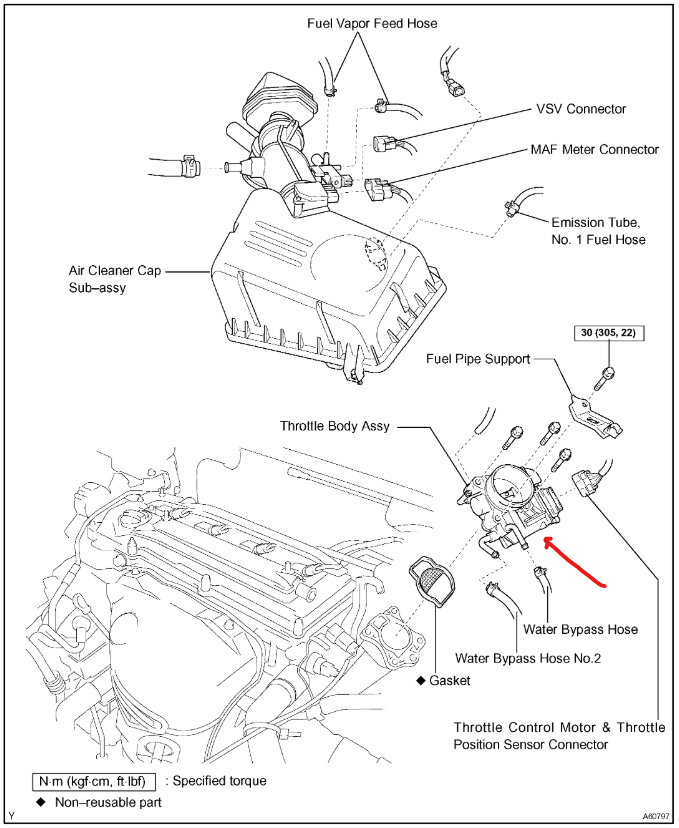

The car listed above 2AZFE, when start in the morning, the car has a hard time starting. When I crank the engine, it struggles to stay on unless I press the gas pedal. After giving it some gas and letting it run for a while, it stabilizes and runs fine. The check engine light is on, and we scanned the ECU with a diagnostic tool and retrieved some error codes p0135 and p0505. We already replaced the oxygen sensor, but the issue wasn't resolved. We also cleaned the idle air control valve, the one that controls the airflow when the throttle is closed during cold starts, but that didn’t fix it either. Now I’m trying to figure out what could be causing the problem, and if there are specific wirings I should check. Can you help me diagnose this?
