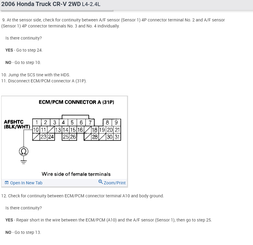

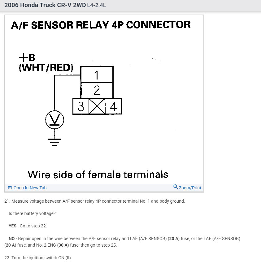

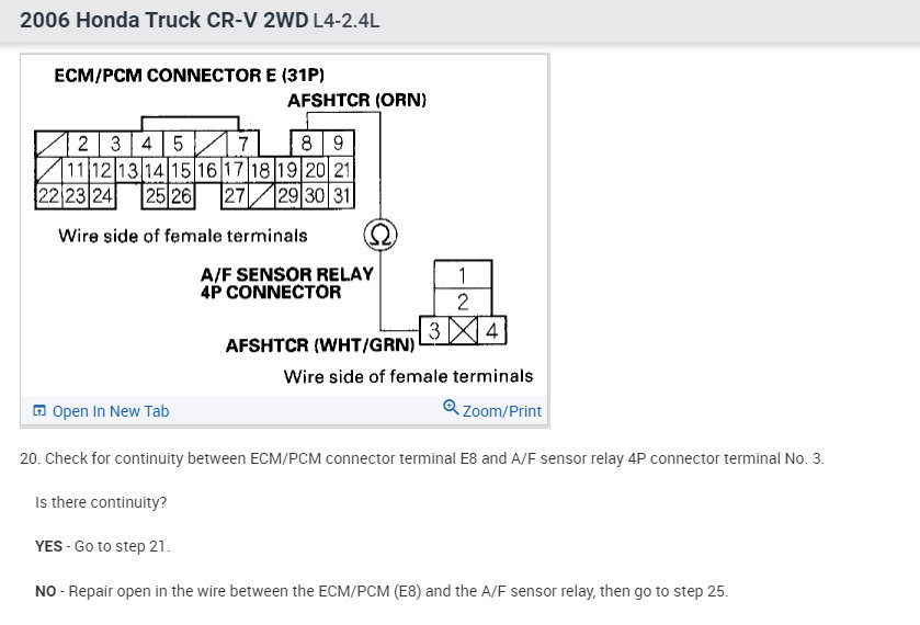

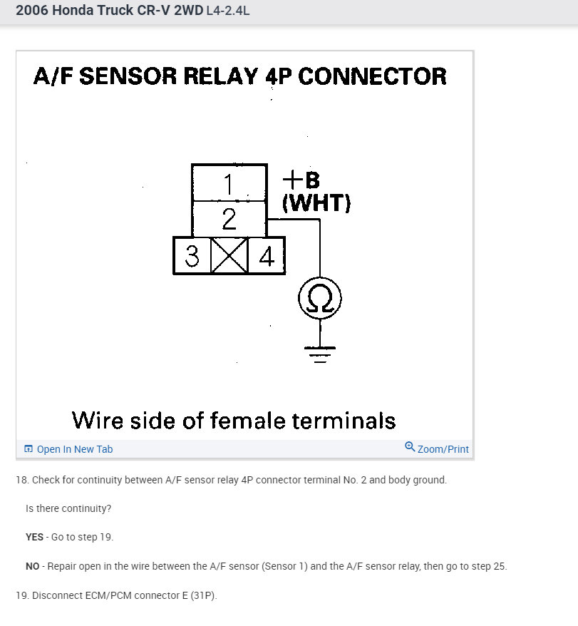

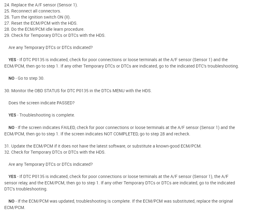

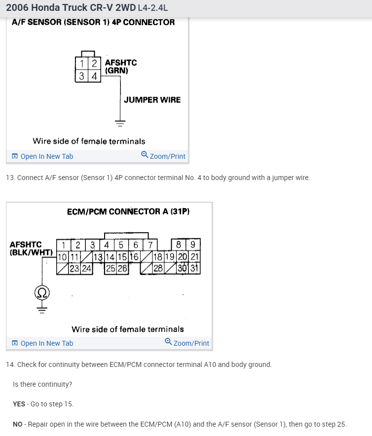

After having my catalytic converter and two O2 sensors replaced (they had been cut out / ripped out and stolen), both the Check Engine Light and the Orange Triangle/! Light will not stop shining. The mechanic hooked it up to their computer and a P0135 code is the result.
