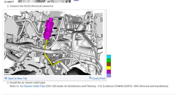

I want to know the location of this sensor so I can replace it.
May 17, 2023 at 8:40 AM

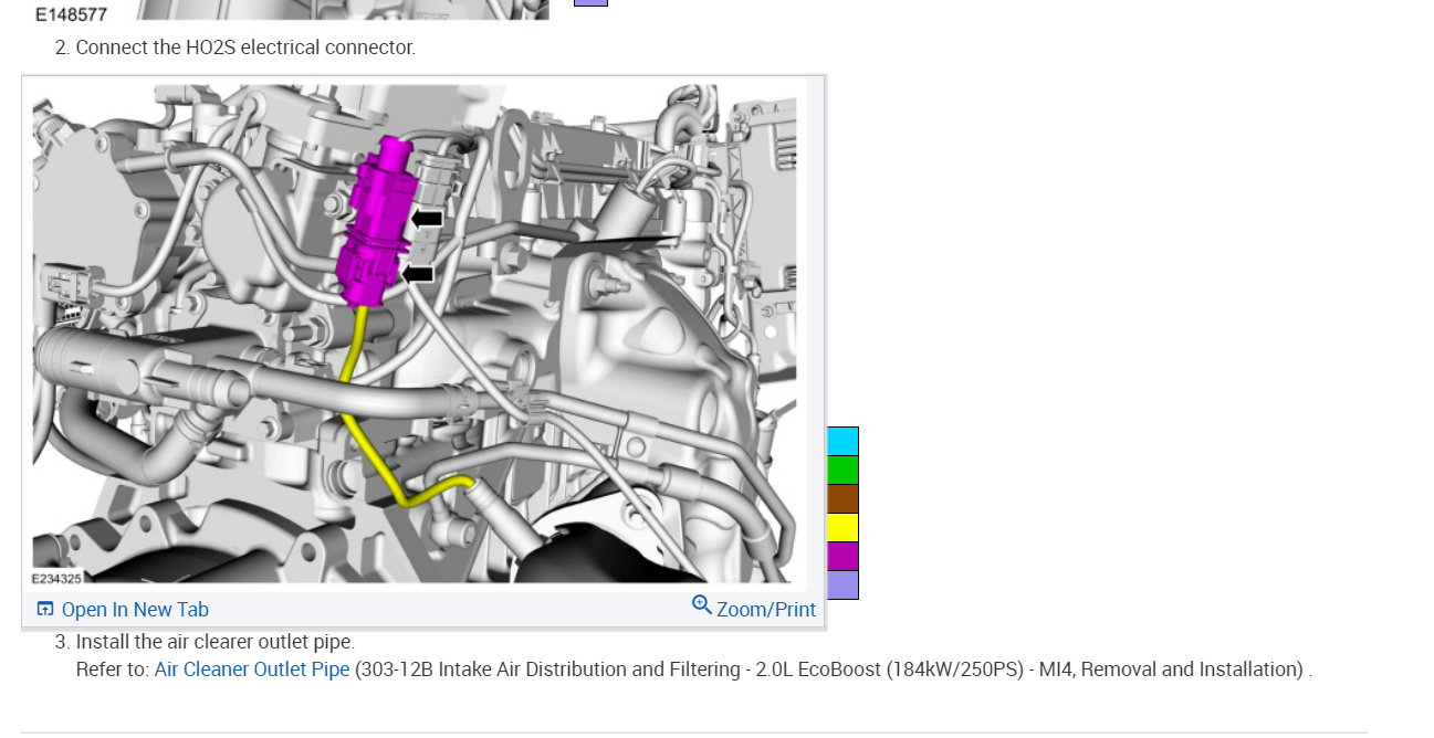

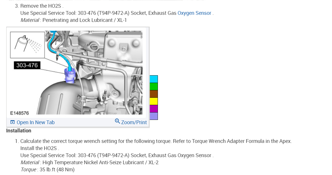

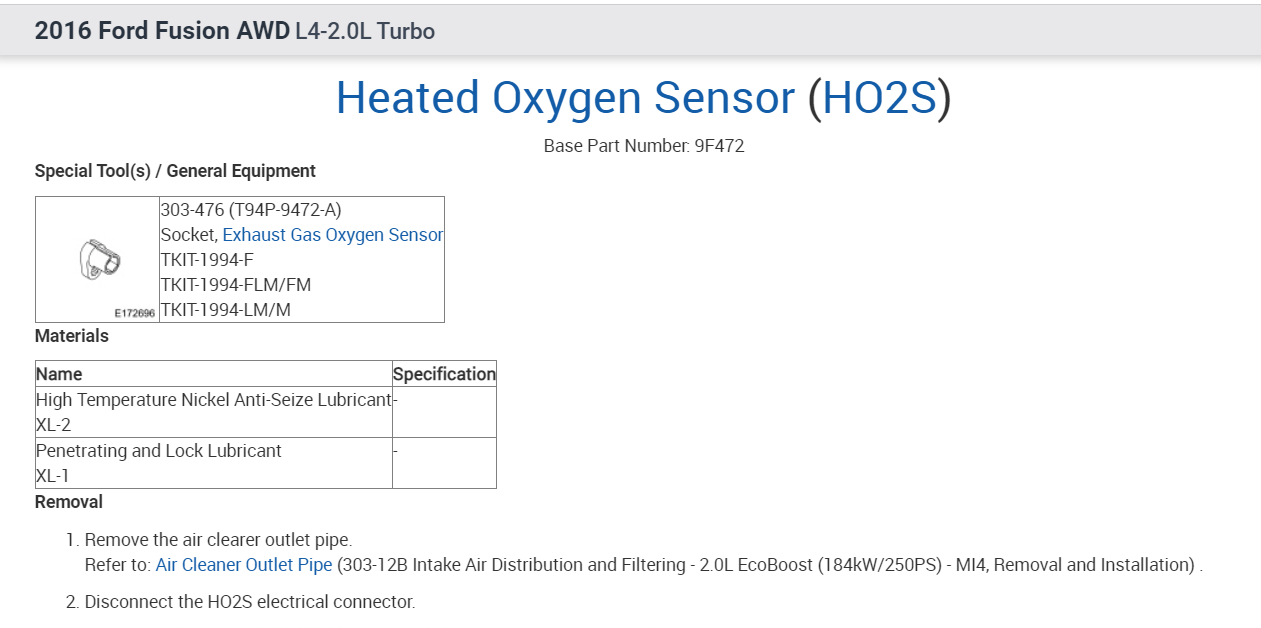

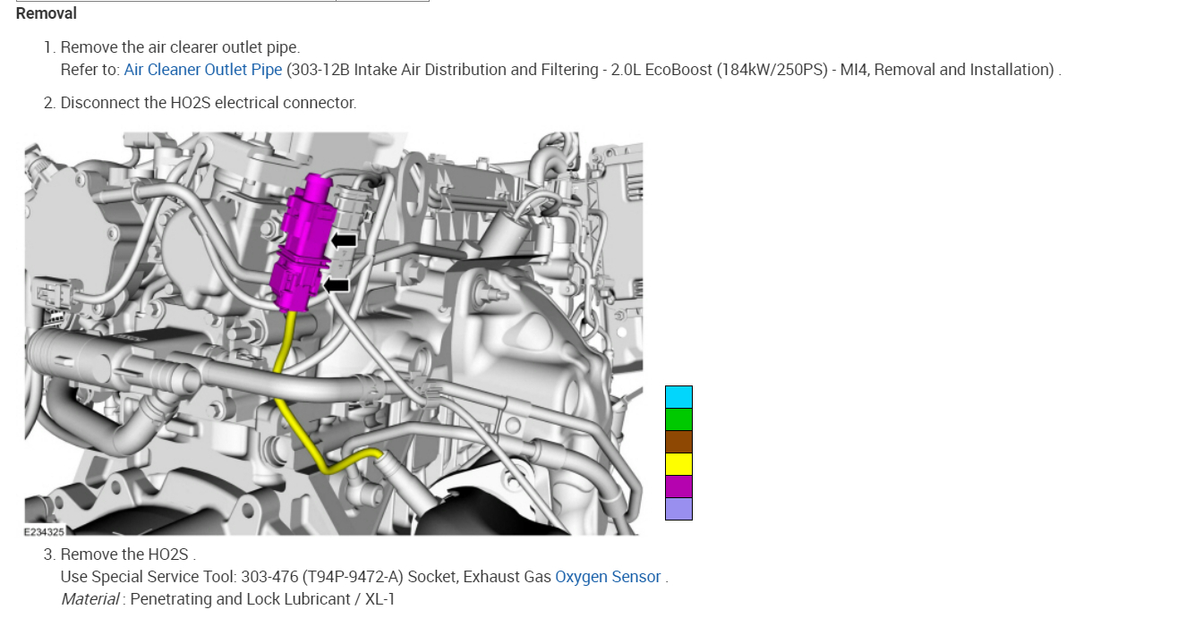

Sure, here is the sensor location so you can change it out.
The P0135 code indicates a malfunction in the oxygen sensor circuit for bank 1 sensor
Check out the images (below). Let us know what happens and please upload pictures or videos of the problem so we can see what's going on.
