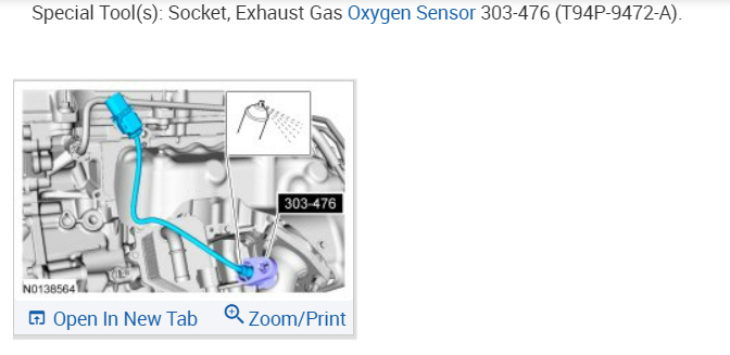

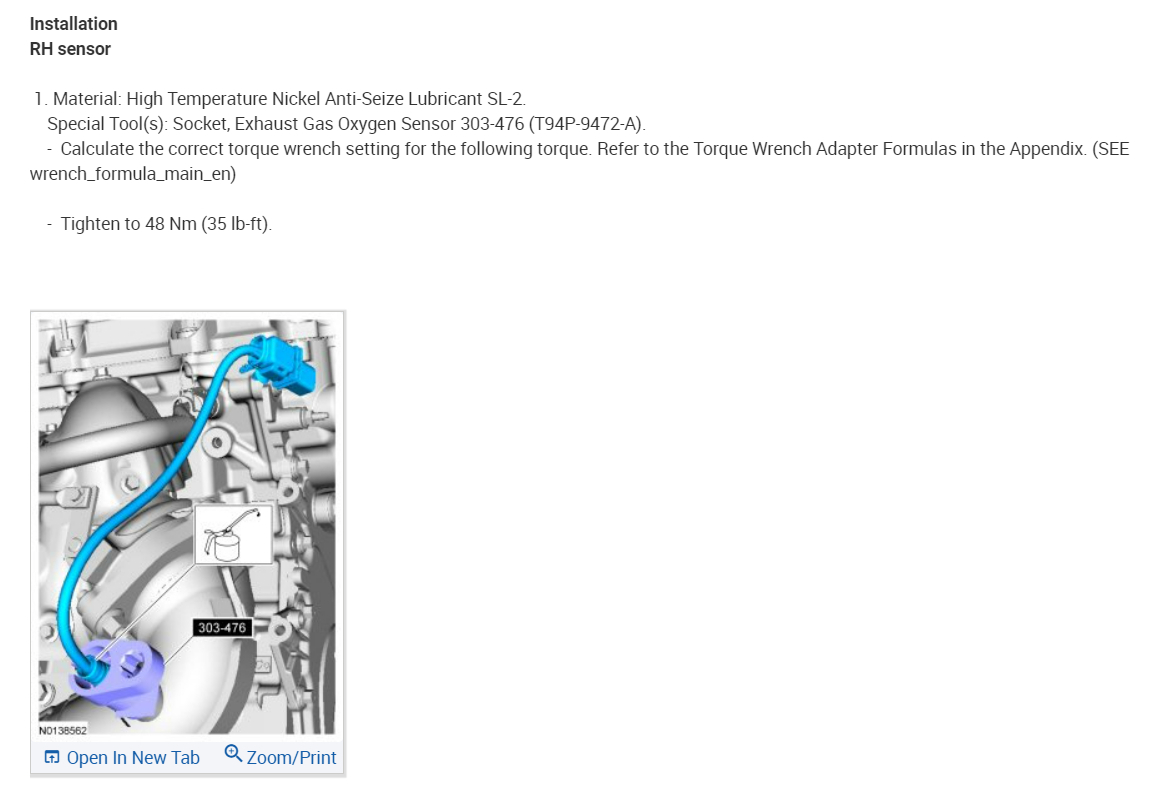

Check engine light p0131. Where is bank1 sensor1 located?
Aug 3, 2023 at 10:37 AM

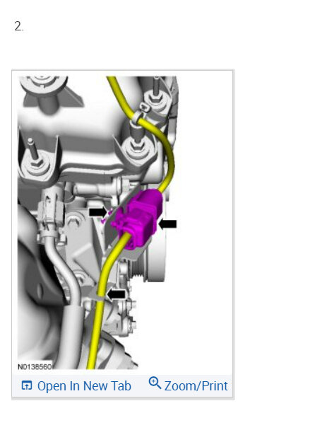

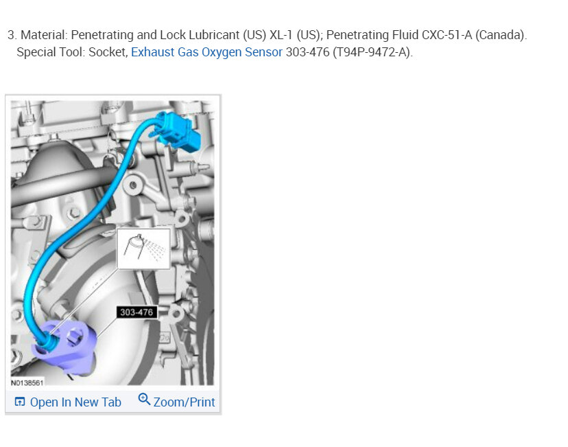

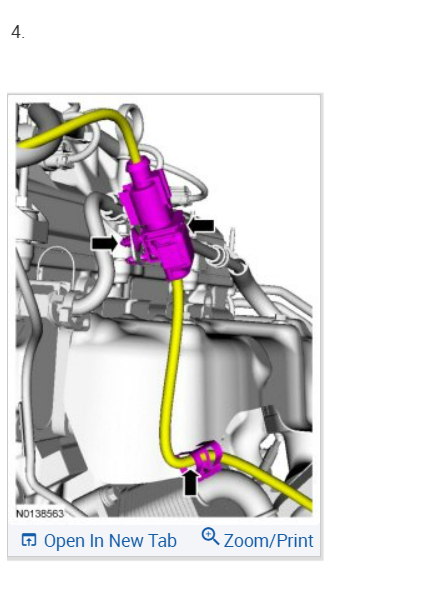

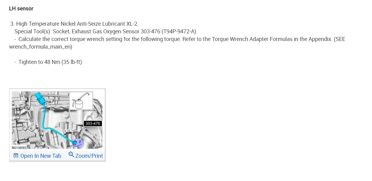

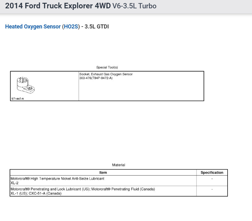

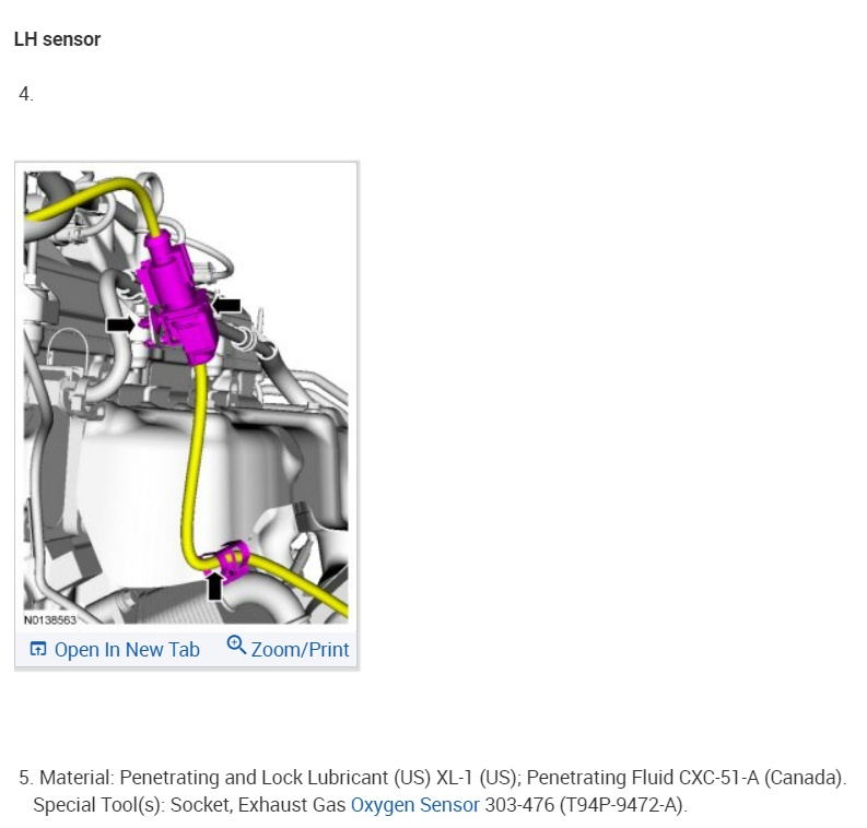

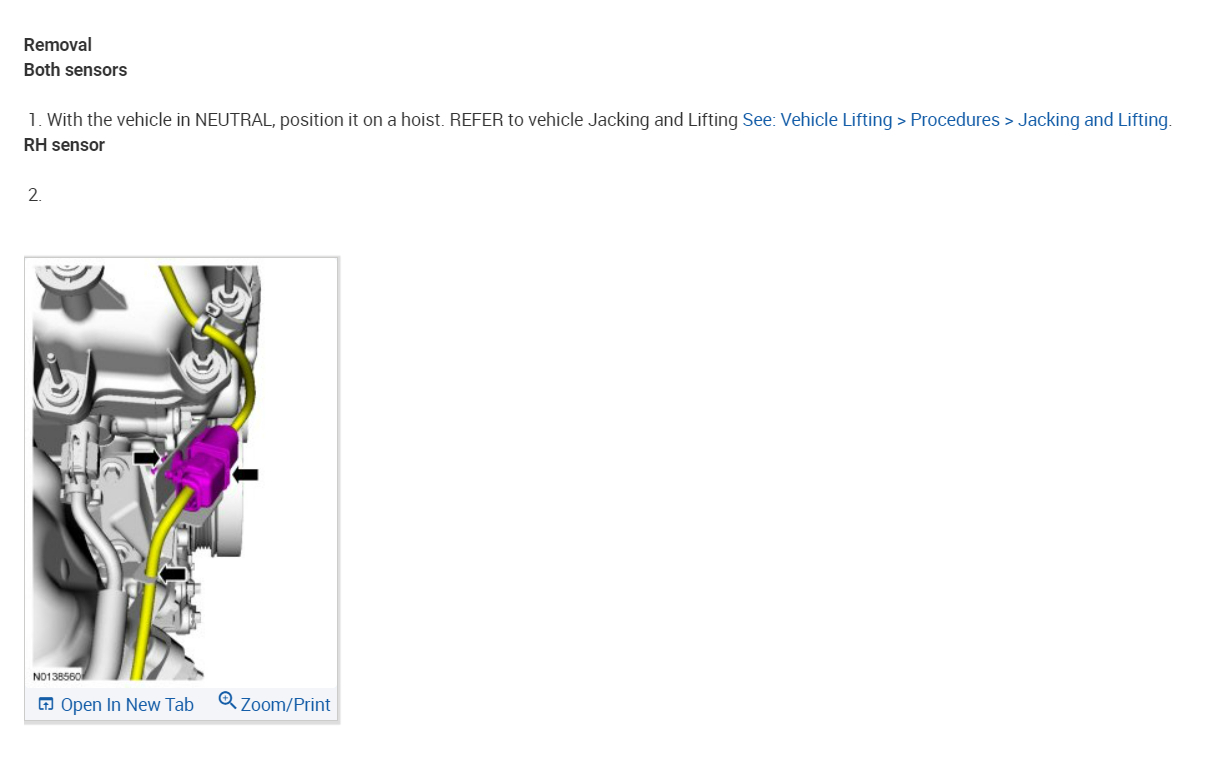

The bank one sensor one is on the right side of the engine. Here is a generic guide to help you step by step with instructions in the diagrams below to show you how on your car:
https://www.2carpros.com/articles/how-to-replace-an-oxygen-sensor
Check out the images (below). Please let us know if you need anything else to get the problem fixed.
