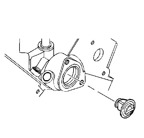

pic 1

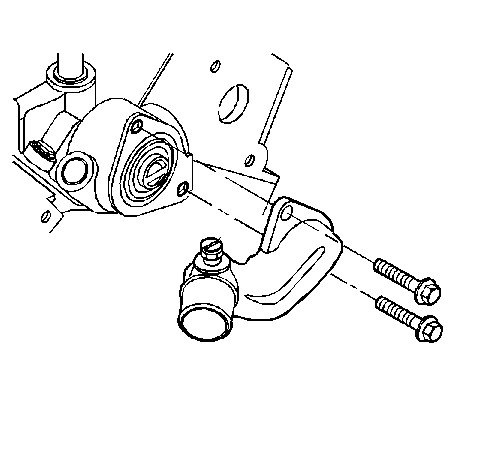

1. Remove the air cleaner intake duct.
2. Partially drain the cooling system.
3. Use the J38185 in order to reposition the hose clamp from the thermostat housing.
4. Remove the radiator inlet hose from the thermostat housing.
5. Remove the thermostat housing bolts.

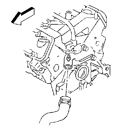

pic 2
6. Remove the thermostat housing.
pic 3
7. Remove the thermostat.
8. Clean and inspect the thermostat housing gasket mating surfaces.

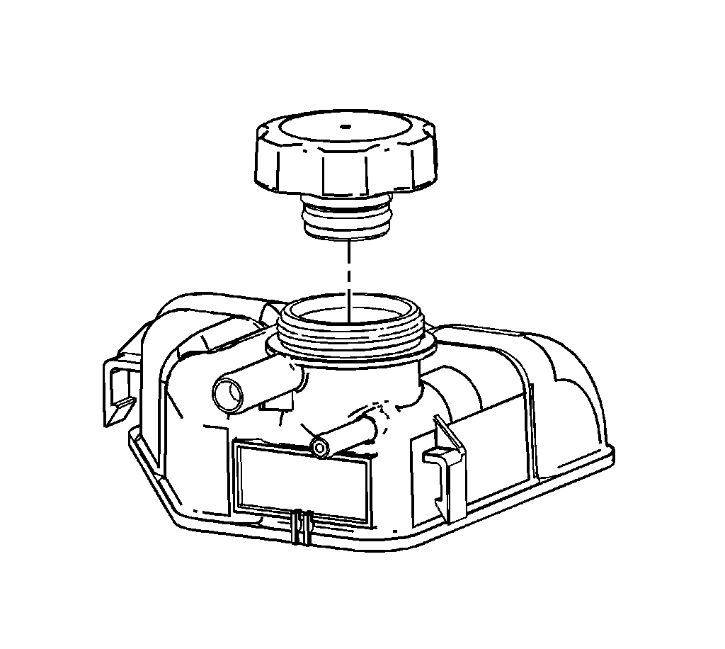

pic 4
1. Install the thermostat.

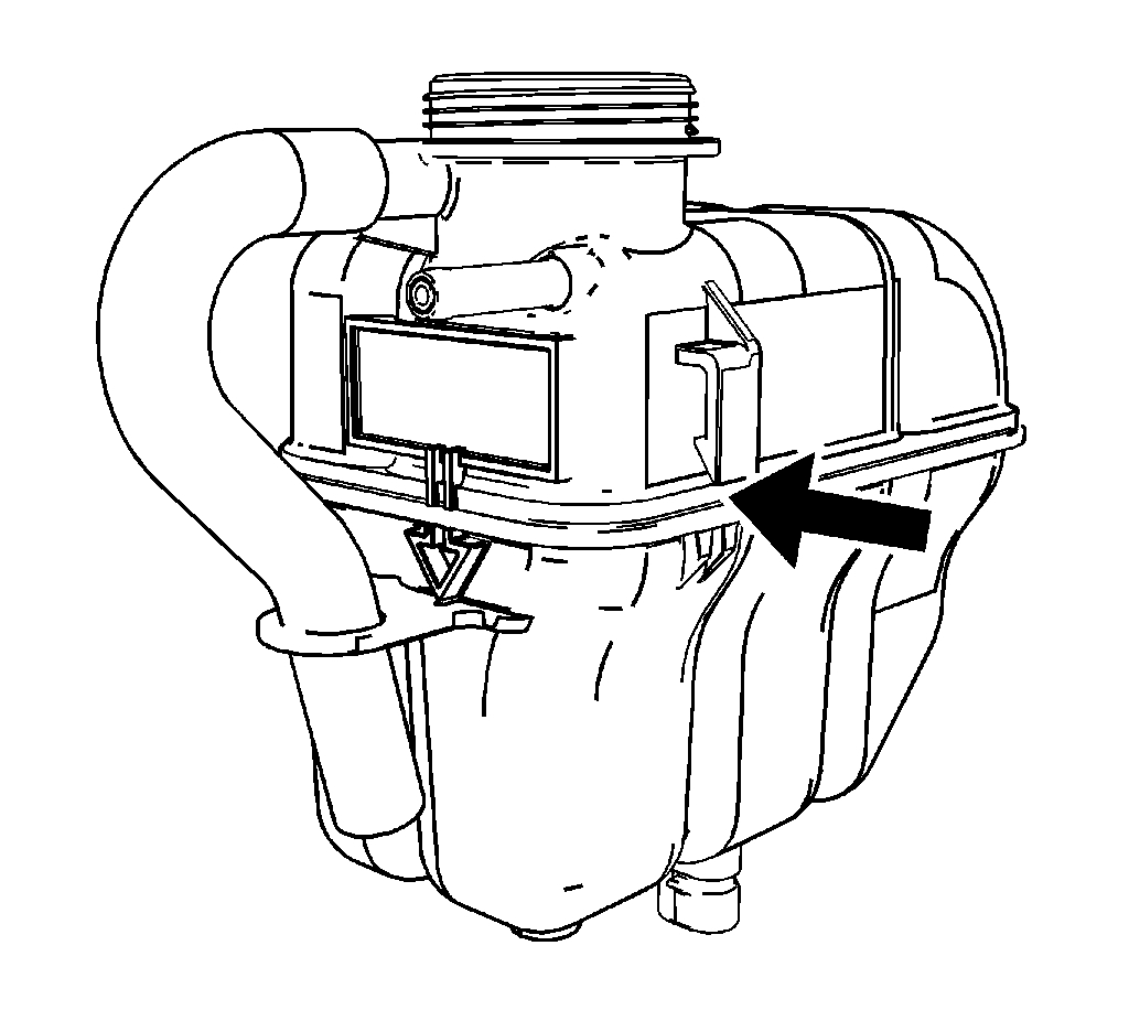

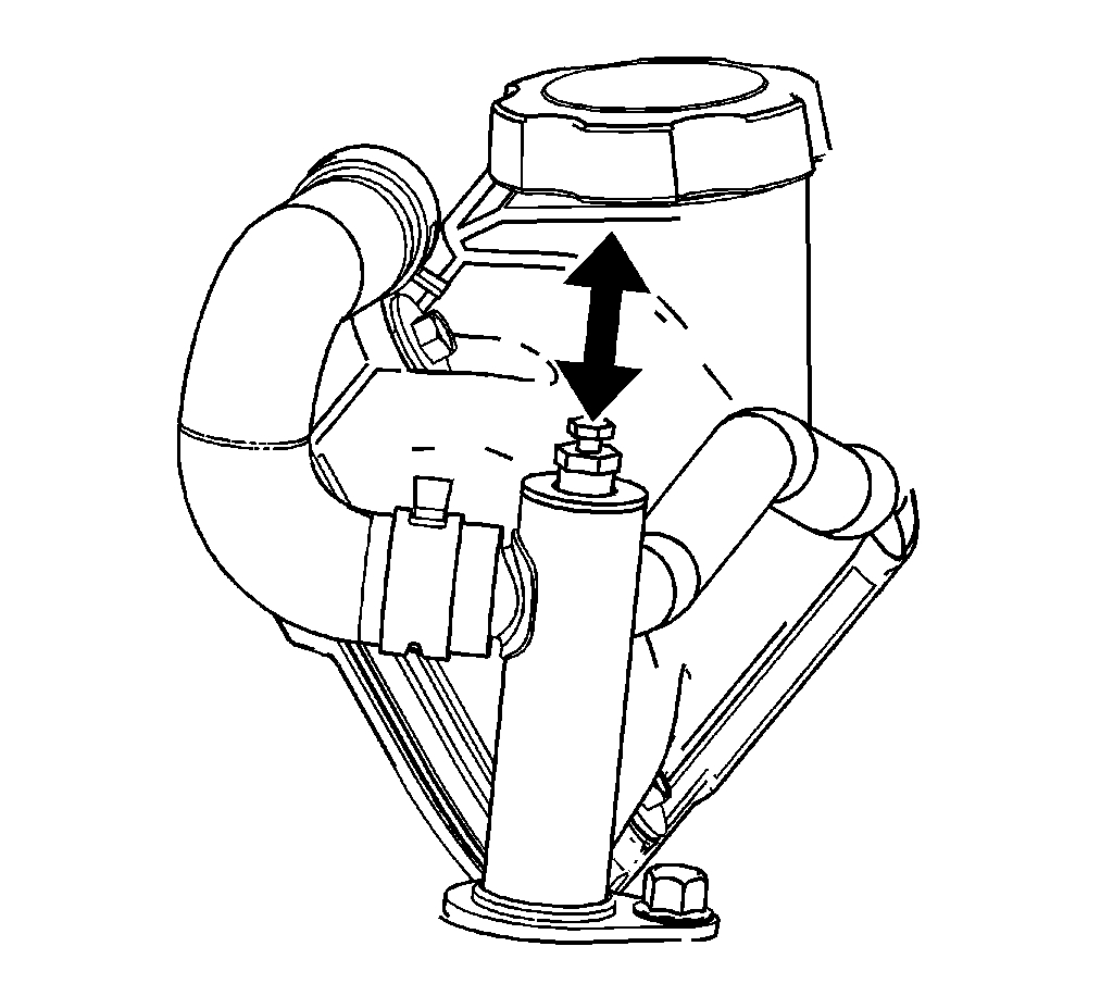

pic 7
5. Add a mixture of 50/50 DEX-COOL(R) antifreeze and clean drinkable water until the level stabilizes at the weld seam on the surge tank.
pic 8
6. Unscrew the coolant bleed screw on the engine until coolant comes out of the bleed screw.
7. Close the bleed screw.
8. Add coolant until the level stabilizes at the weld seam on the surge tank.
pic 9
9. Install the surge tank cap.
