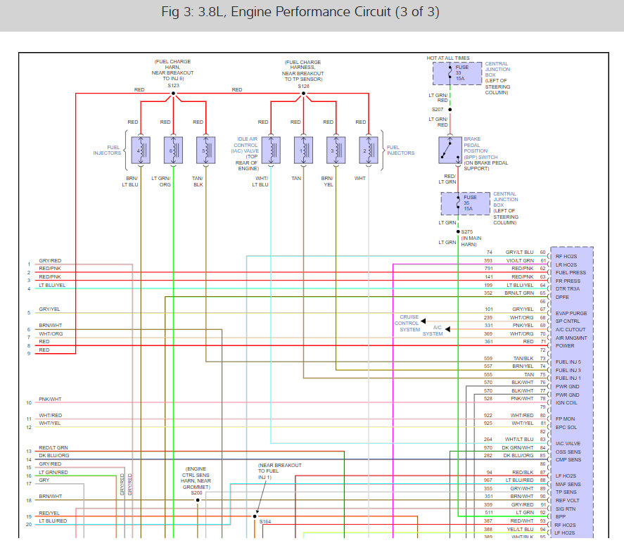

I keep getting a P0122. I have changed the TPS several times. I have a solid 5v on the harness but can't seem to get a variation of voltage when I turn the throttle. Needing help figuring out what is going on.
