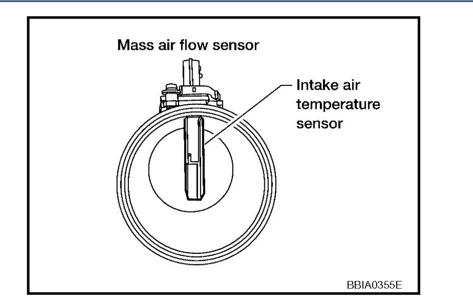

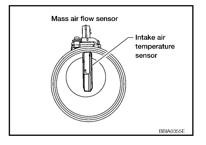

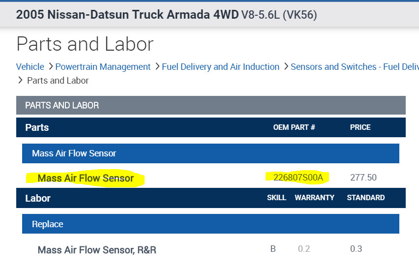

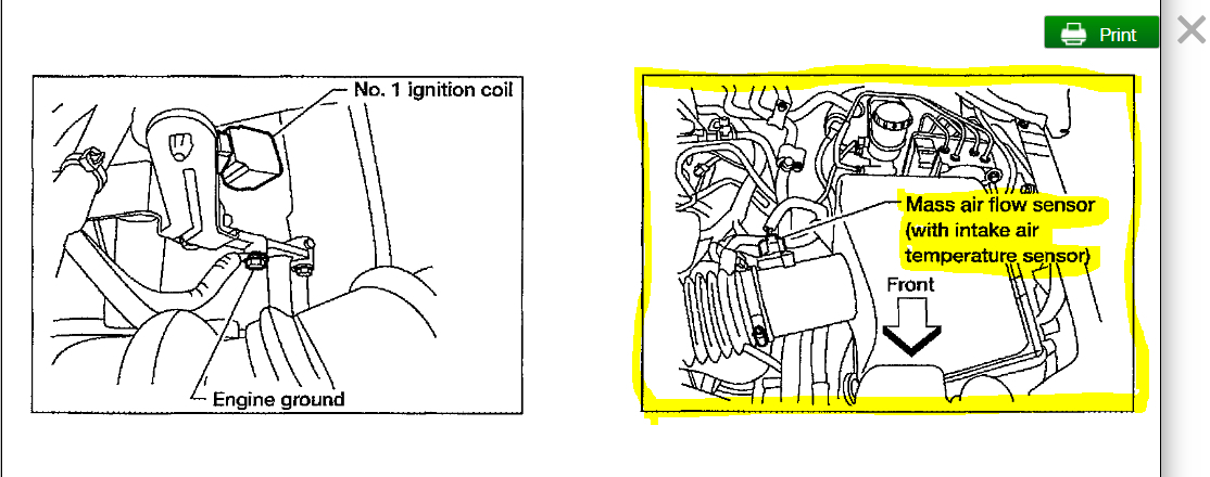

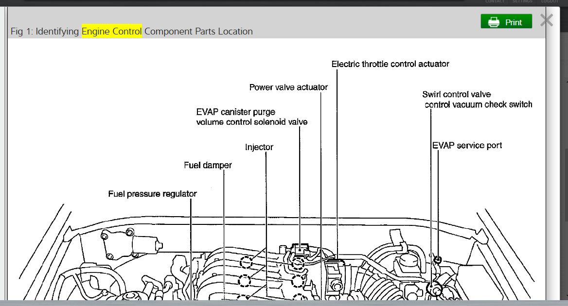

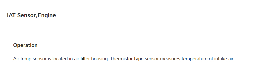

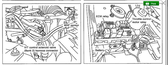

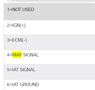

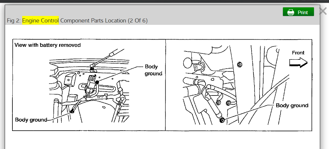

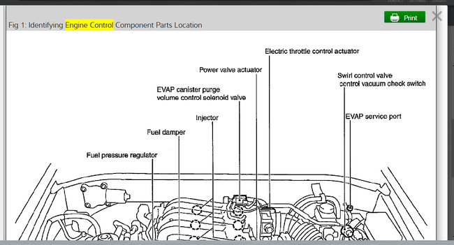

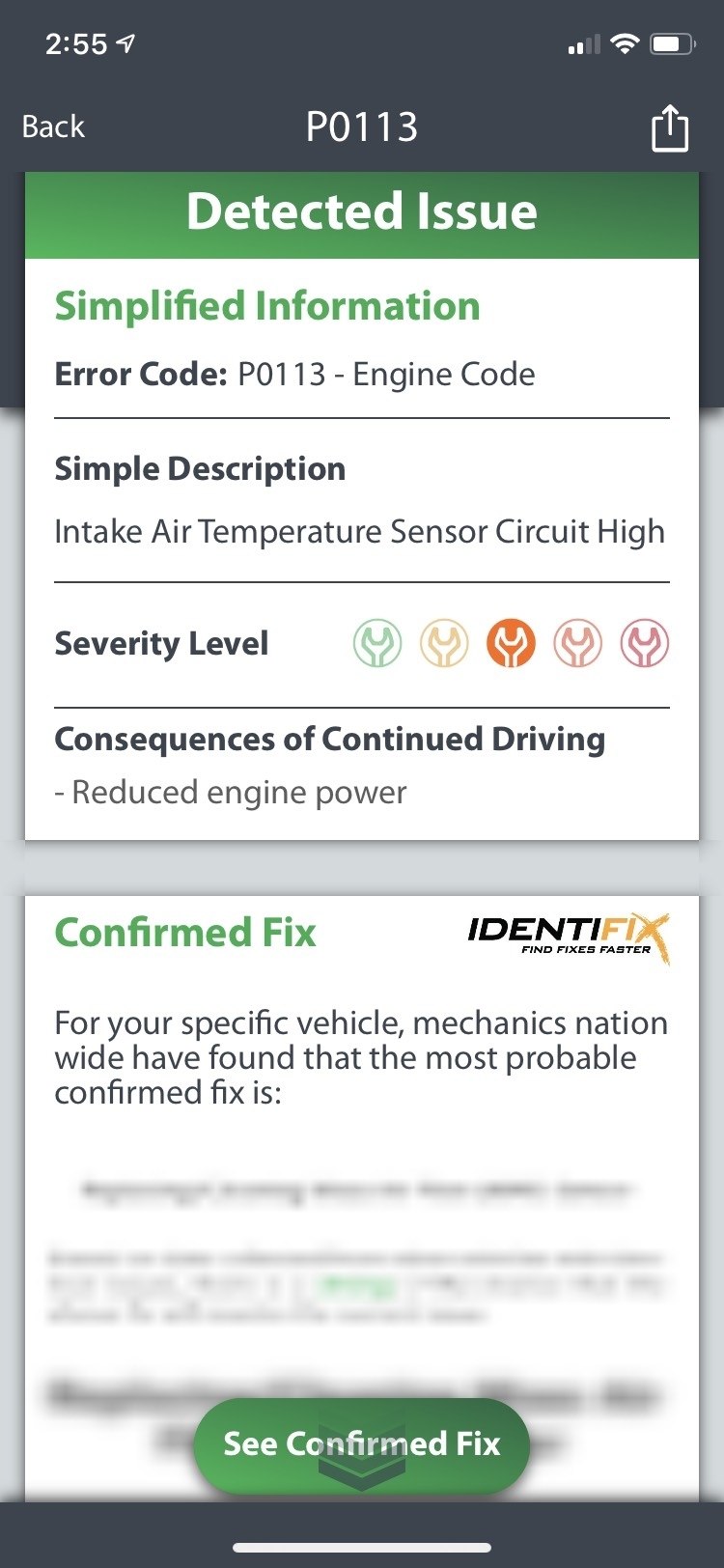

Recently, my vehicle started acting up. It turned off on me a few times when I came to a stop at a streetlight then the "Check Engine Light" came on. I used my FIXD OBD-II Code Reader and it gave me a P0113 trouble code as you can see in the title. I also took a screenshot of the trouble code on the app. I have looked online for the Intake Air Temperature sensor and I have found a few different versions of it for my specific vehicle. I am not very sure which is the correct part and also exactly where this sensor is located on my truck as I cannot seem to find that information online. Note that a while back a "Check Engine Light" came on and it was for the mass air flow sensor which I have replaced and that trouble code light was removed. I also have attached images of the three different IAT Sensor from AutoZone for this specific truck and I do not know which one is the correct part. Help!
