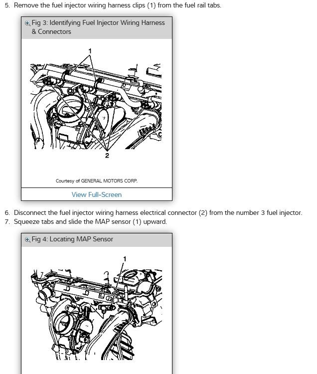

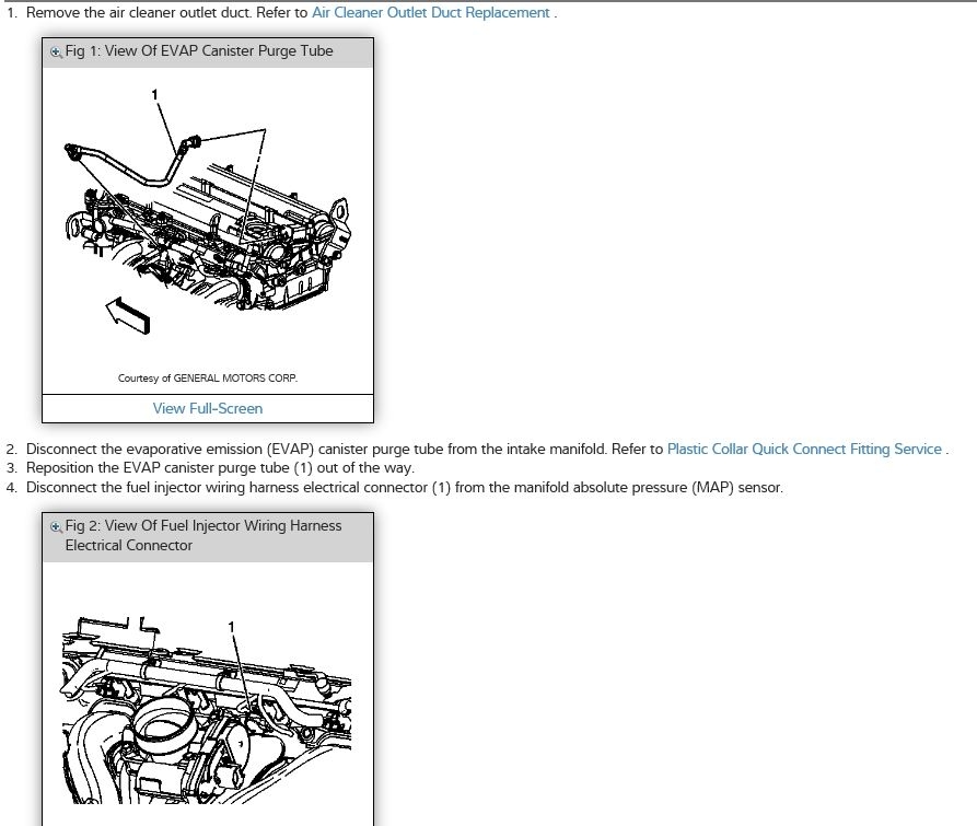

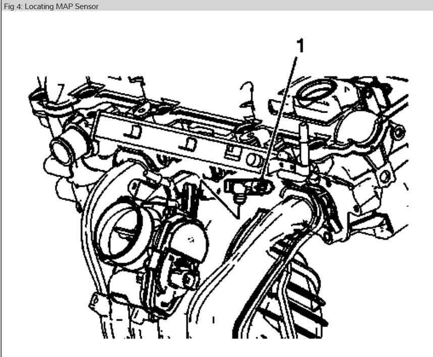

Code P0107 refers to Manifold Absolute Pressure (MAP) Sensor Circuit Low Voltage and here is where that map sensor is located.
And how to remove it. Check out the diagrams (Below). Please let us know if you need anything else to get the problem fixed.
