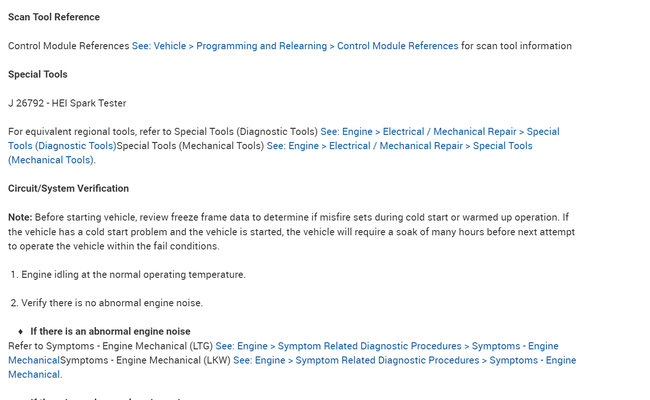

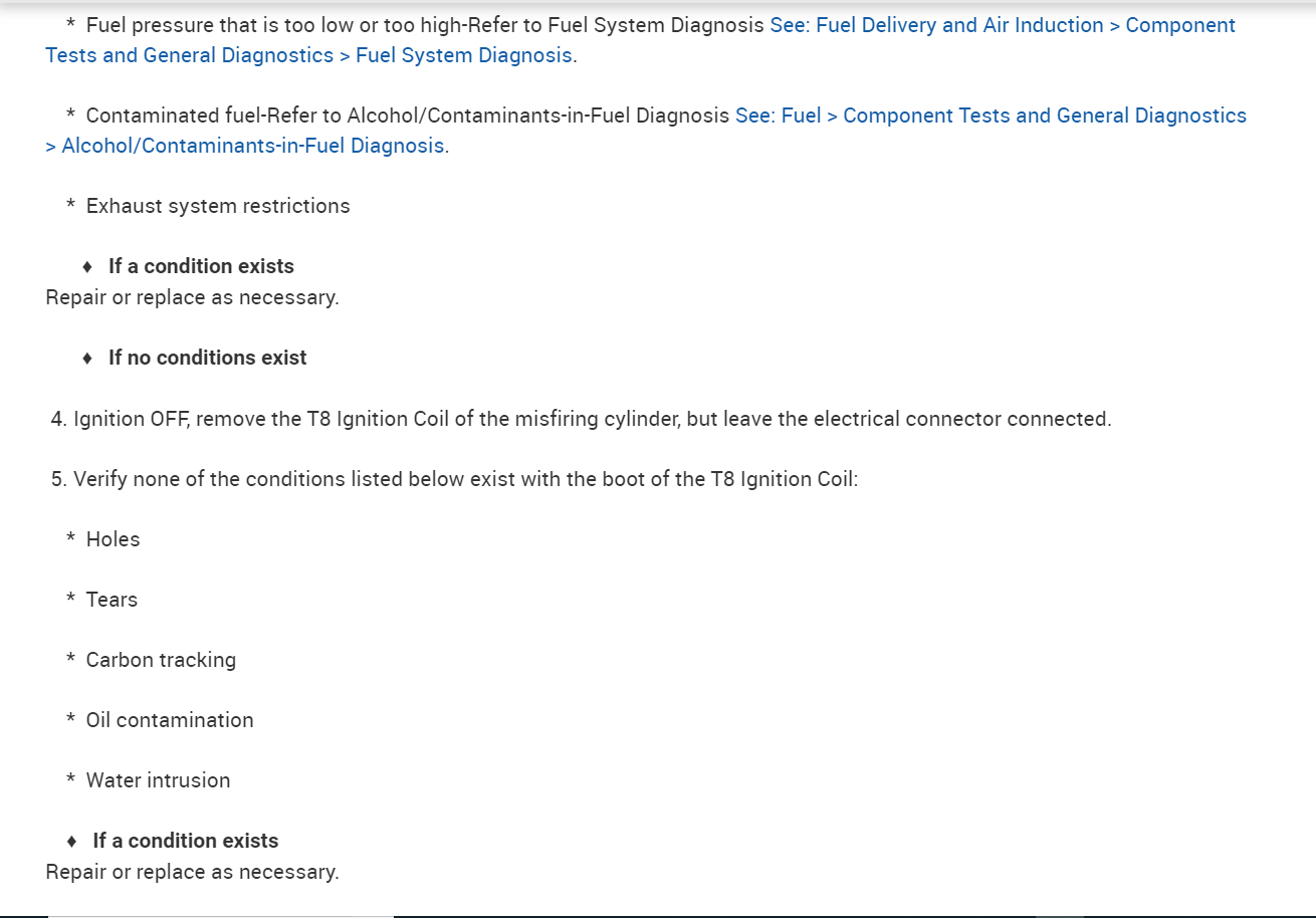

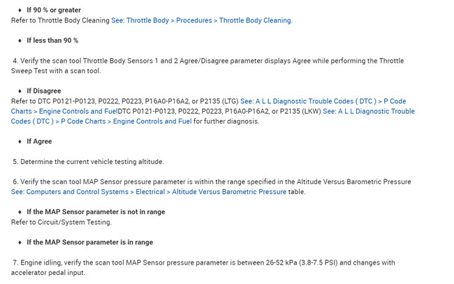

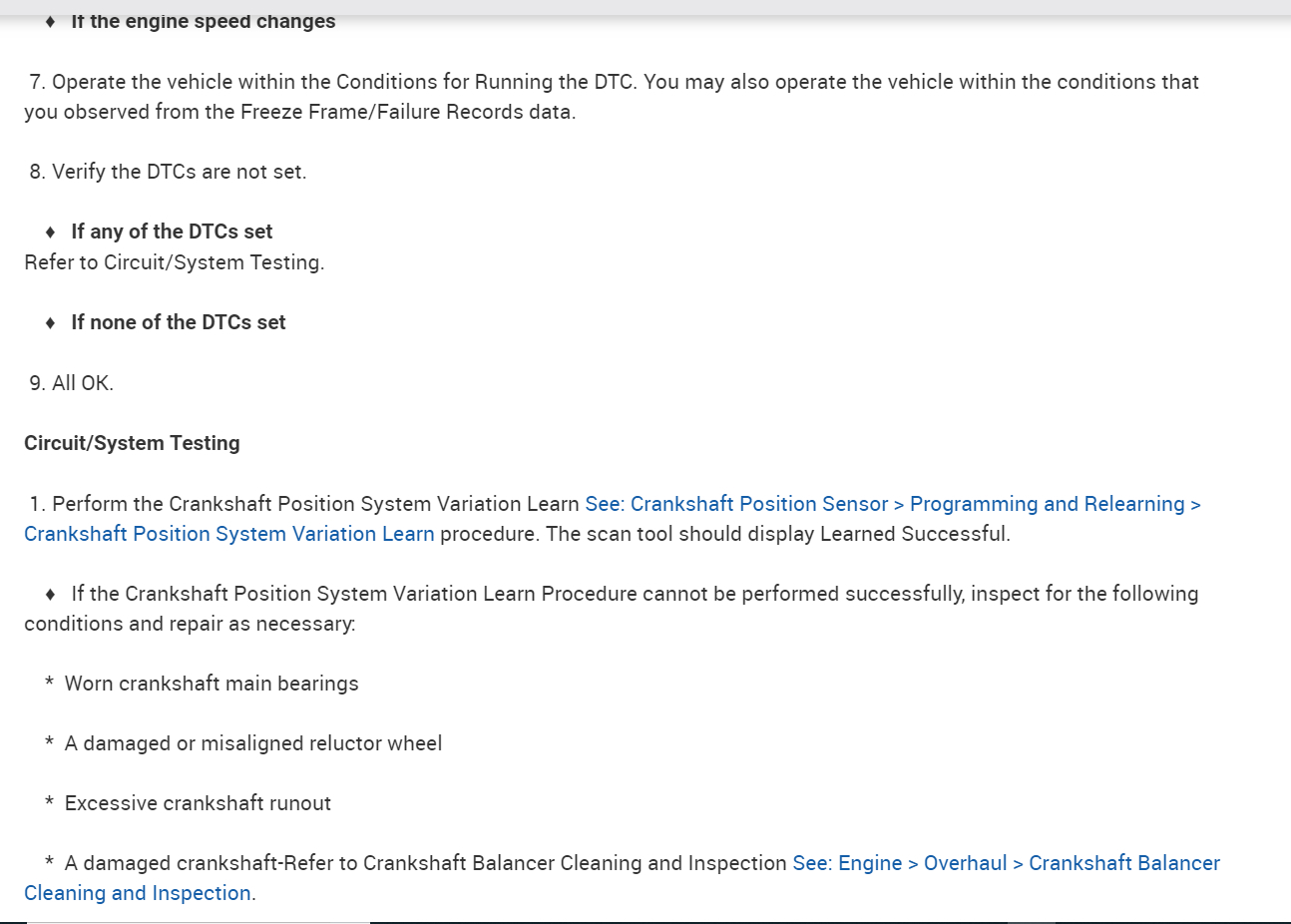

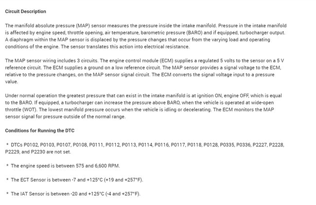

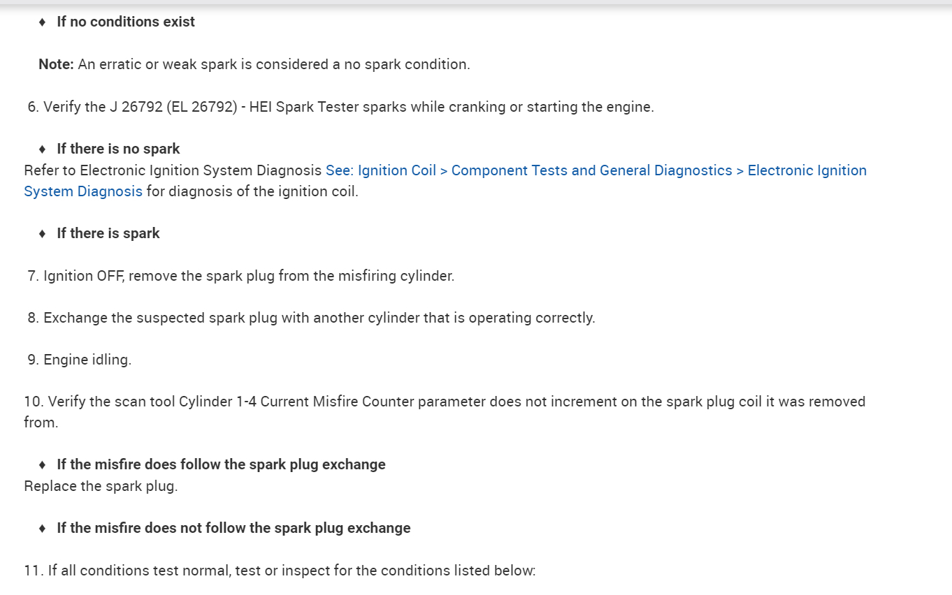

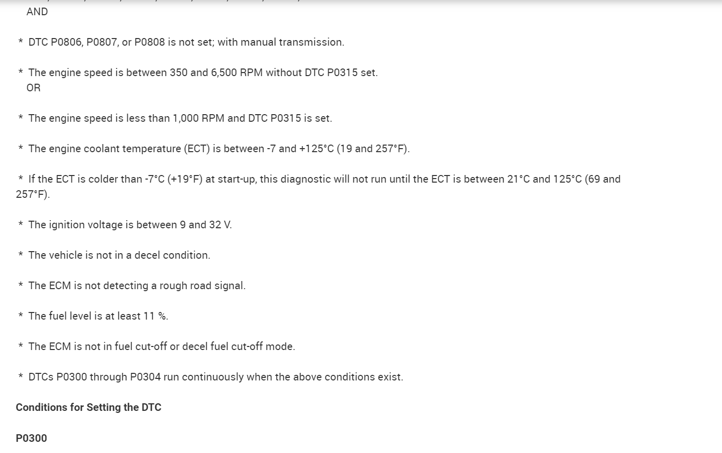

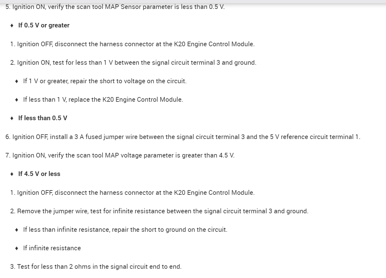

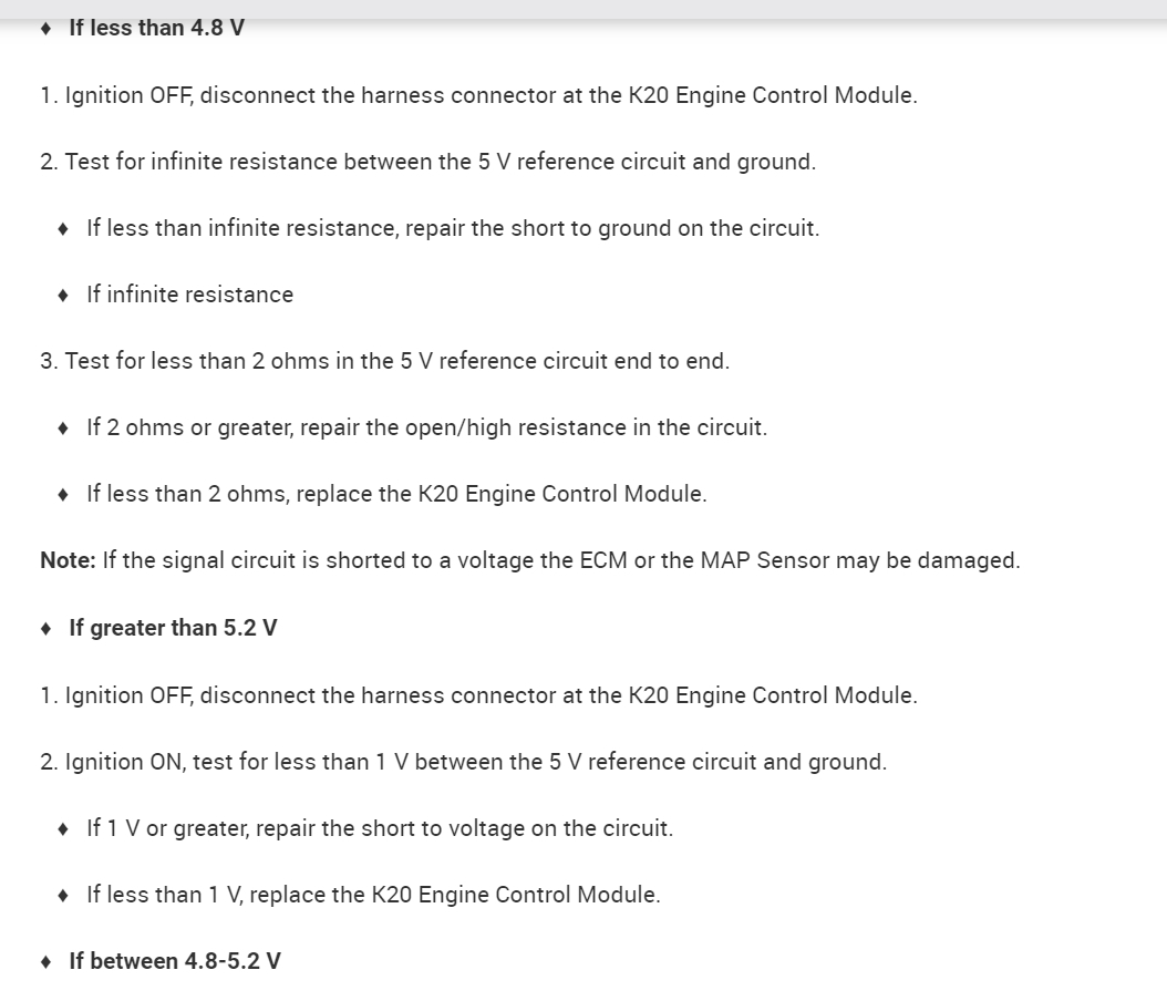

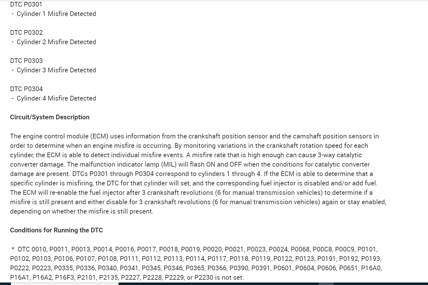

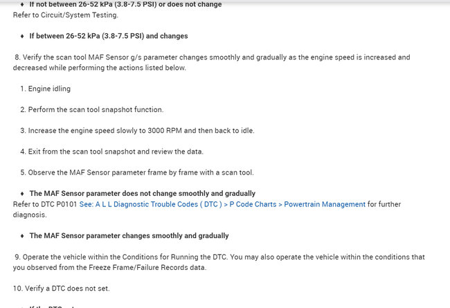

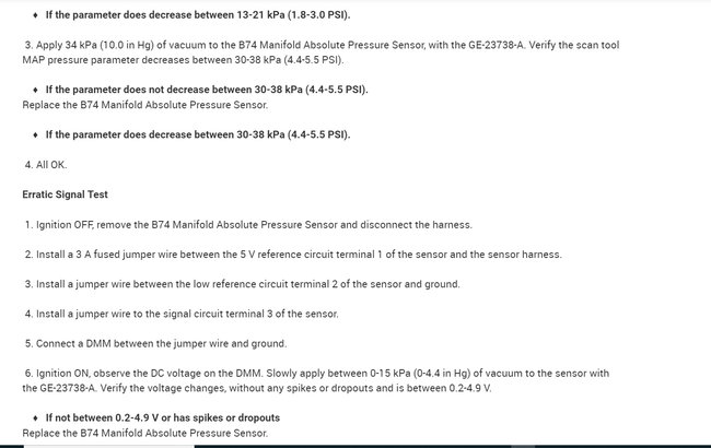

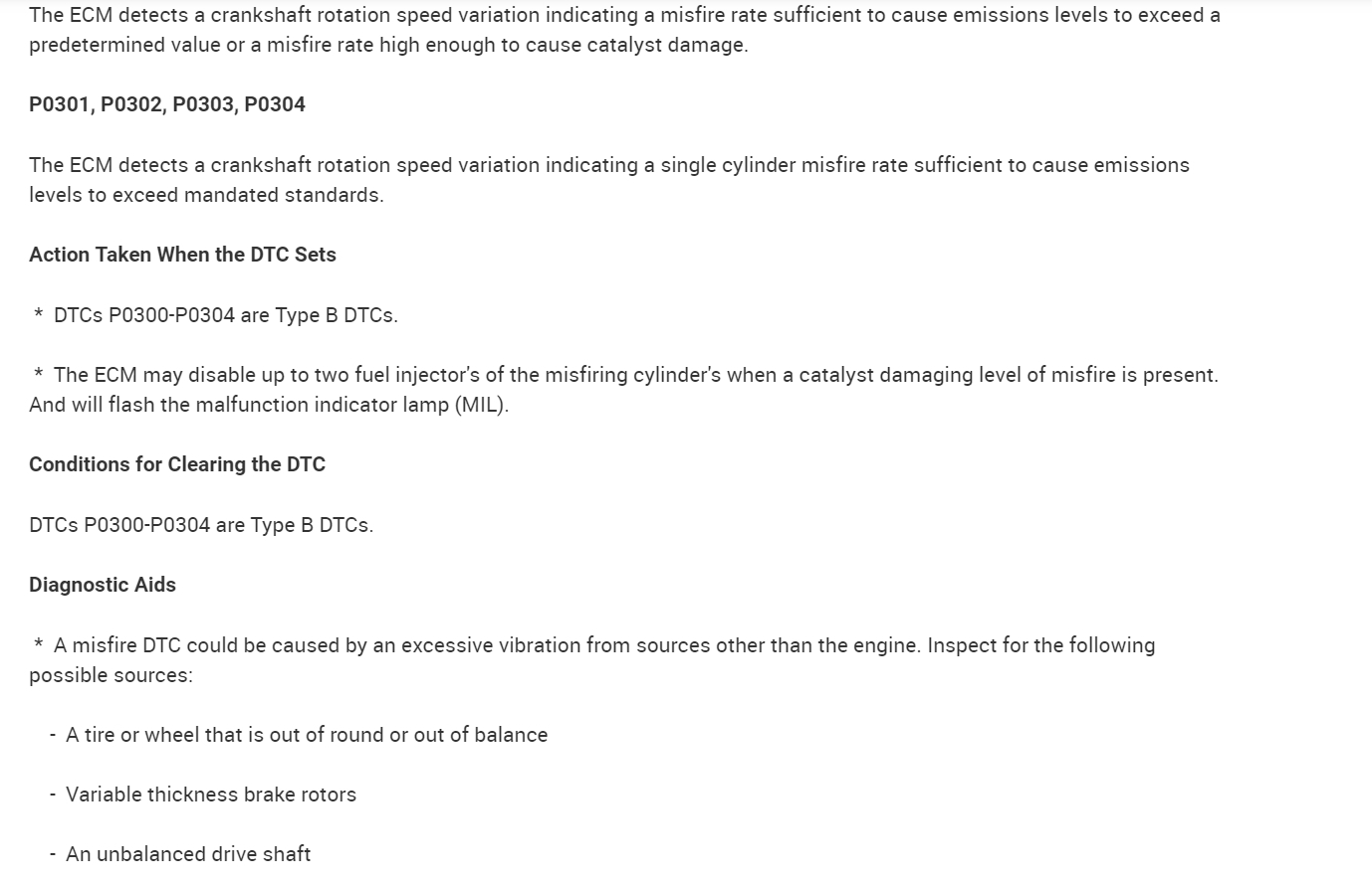

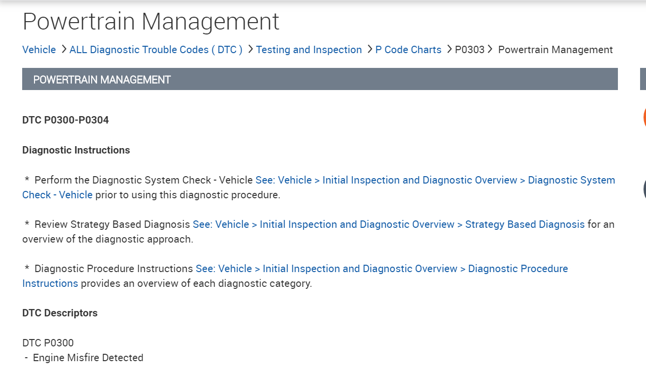

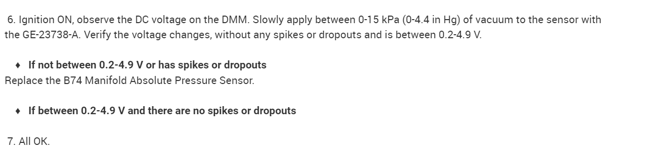

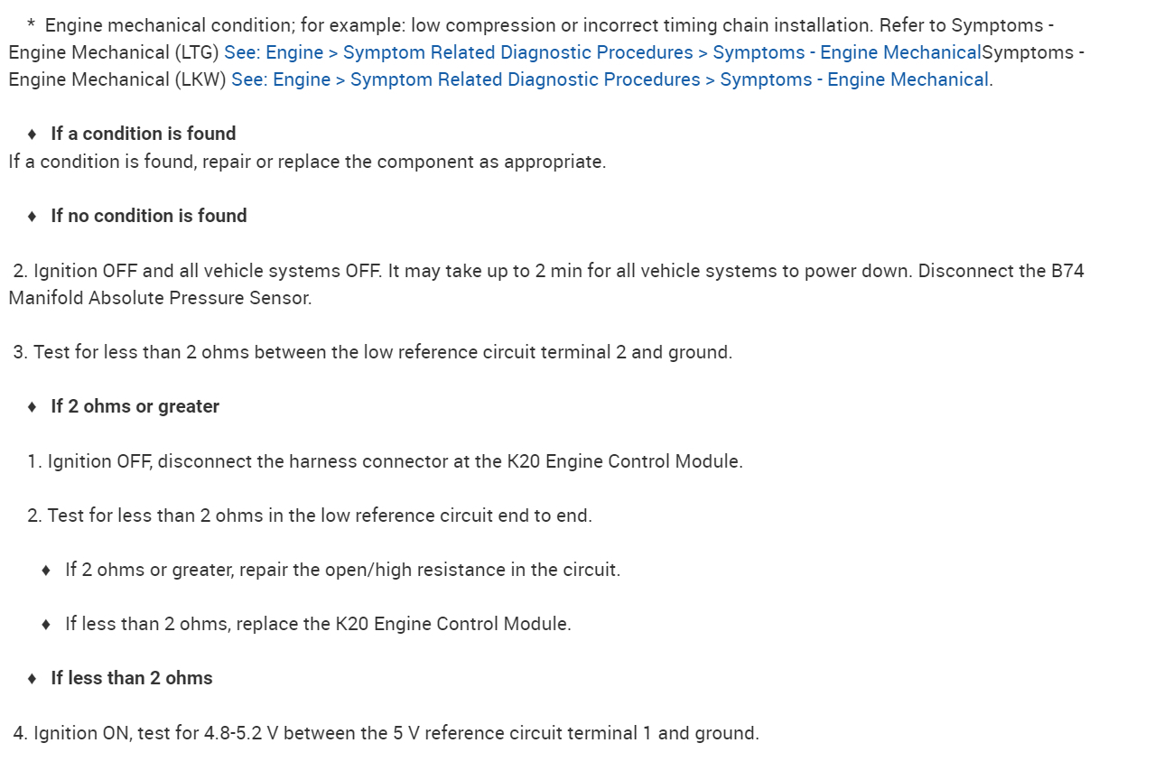

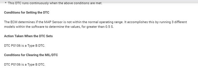

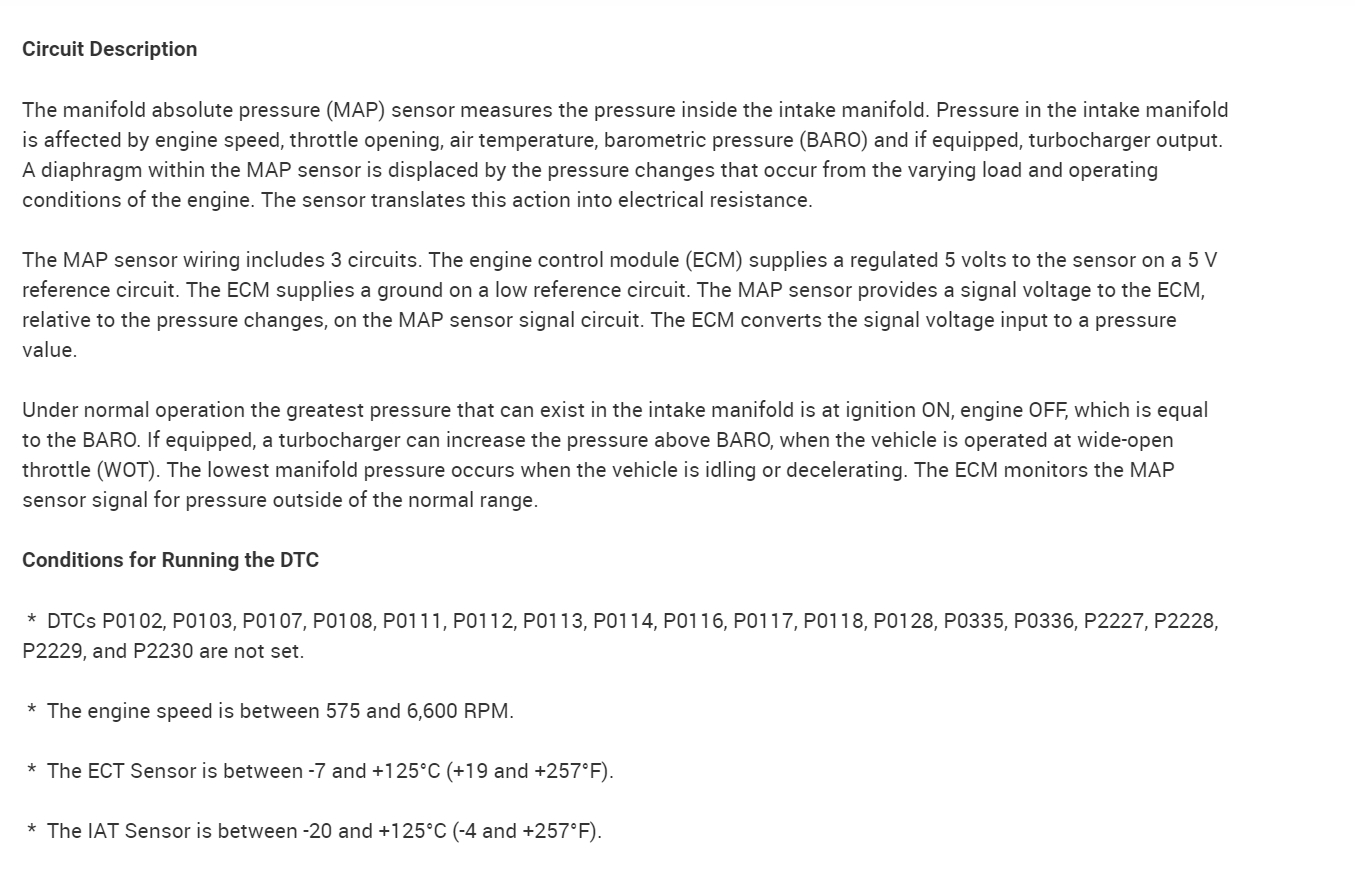

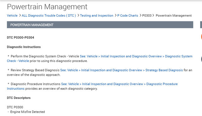

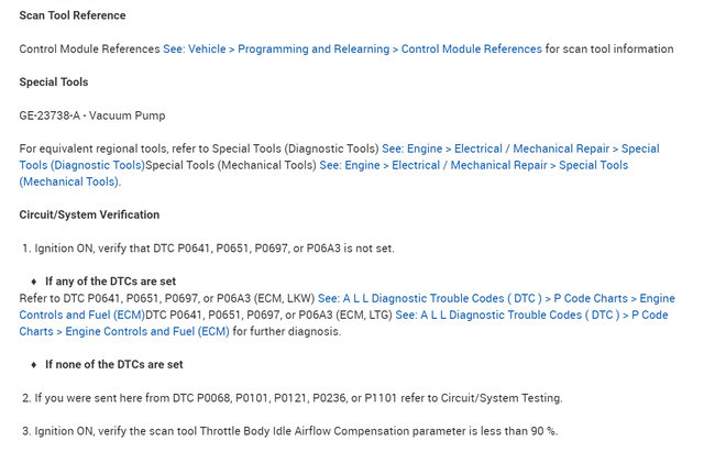

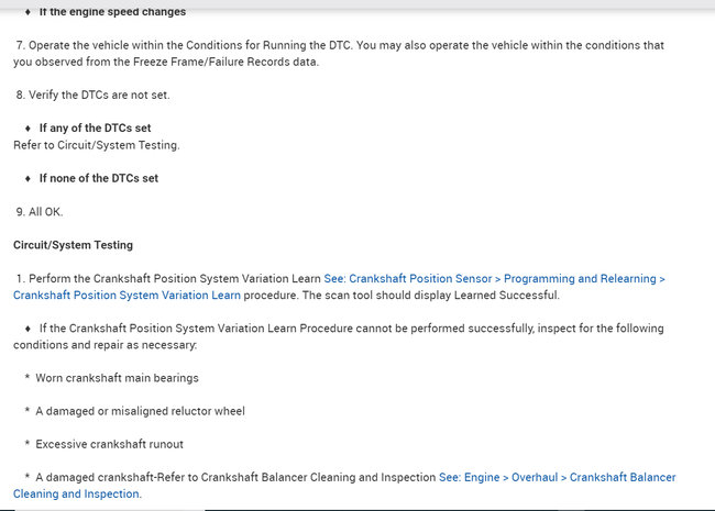

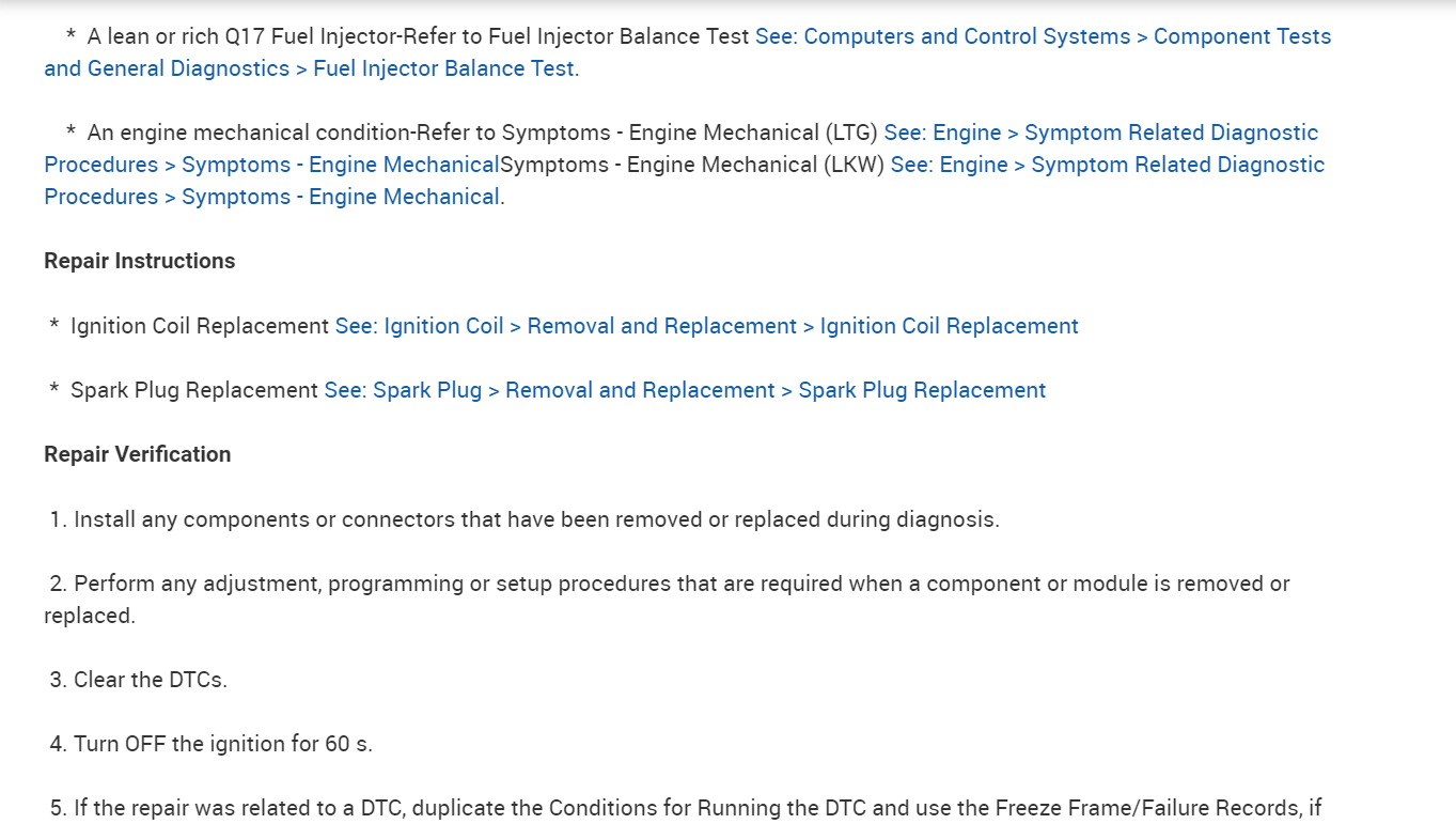

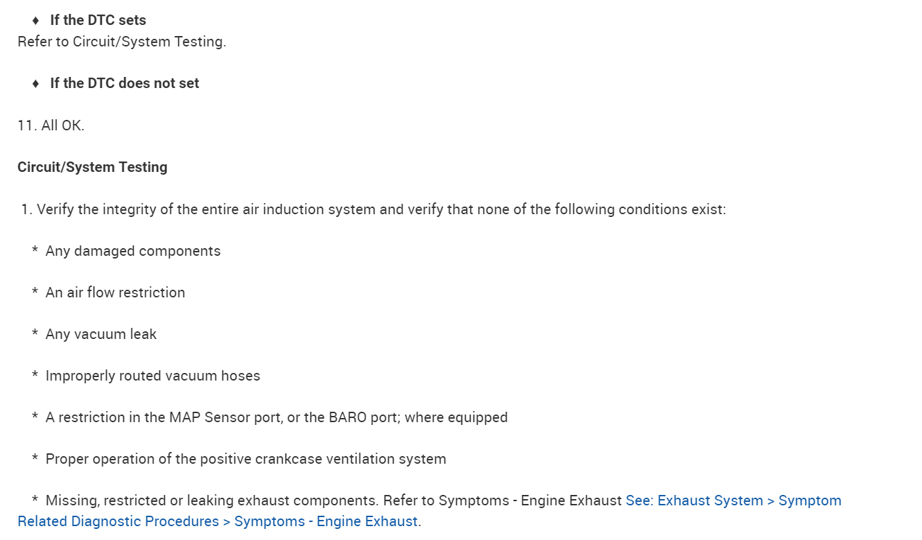

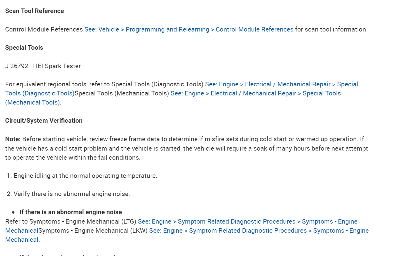

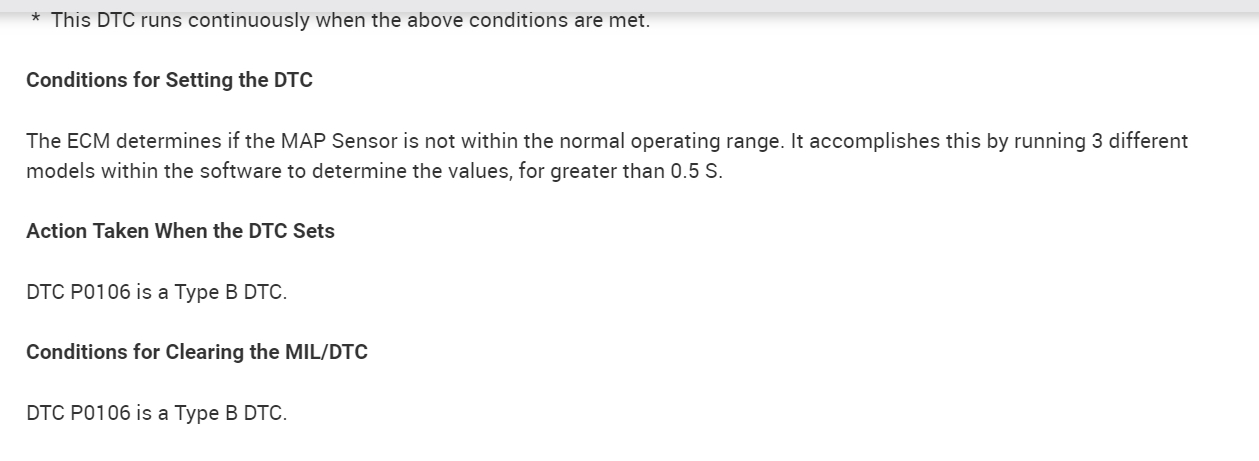

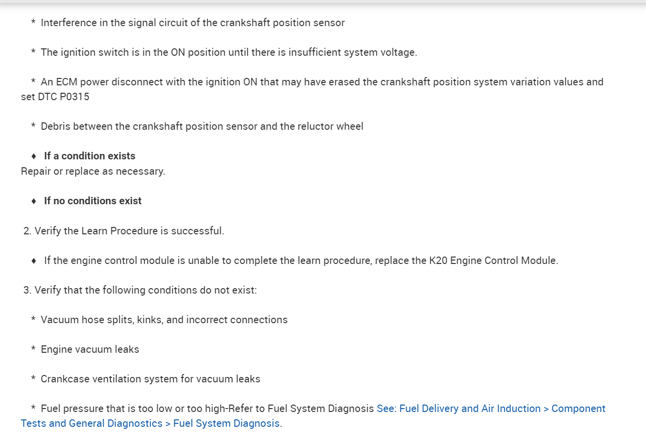

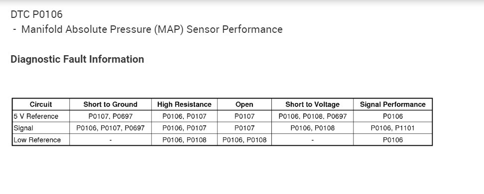

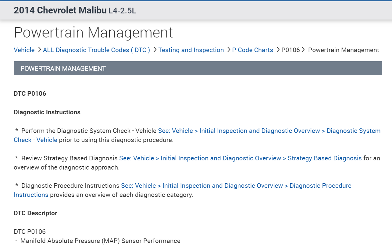

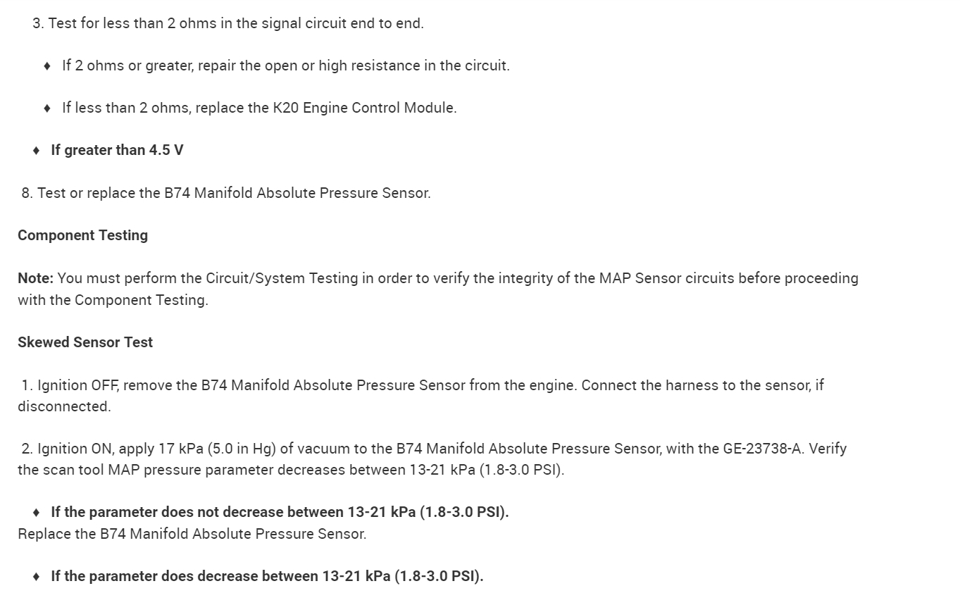

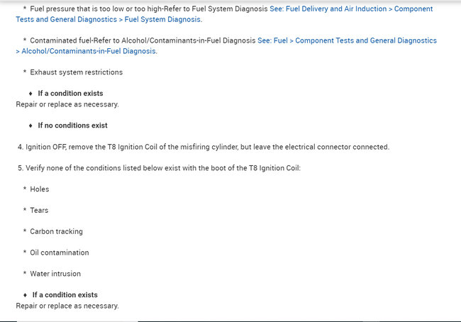

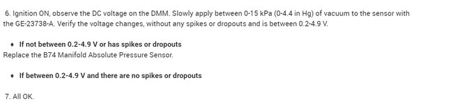

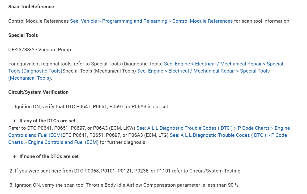

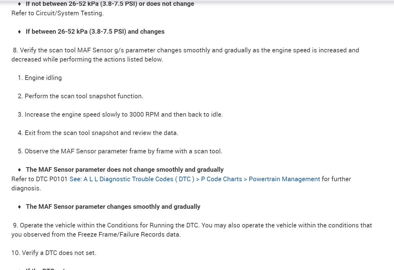

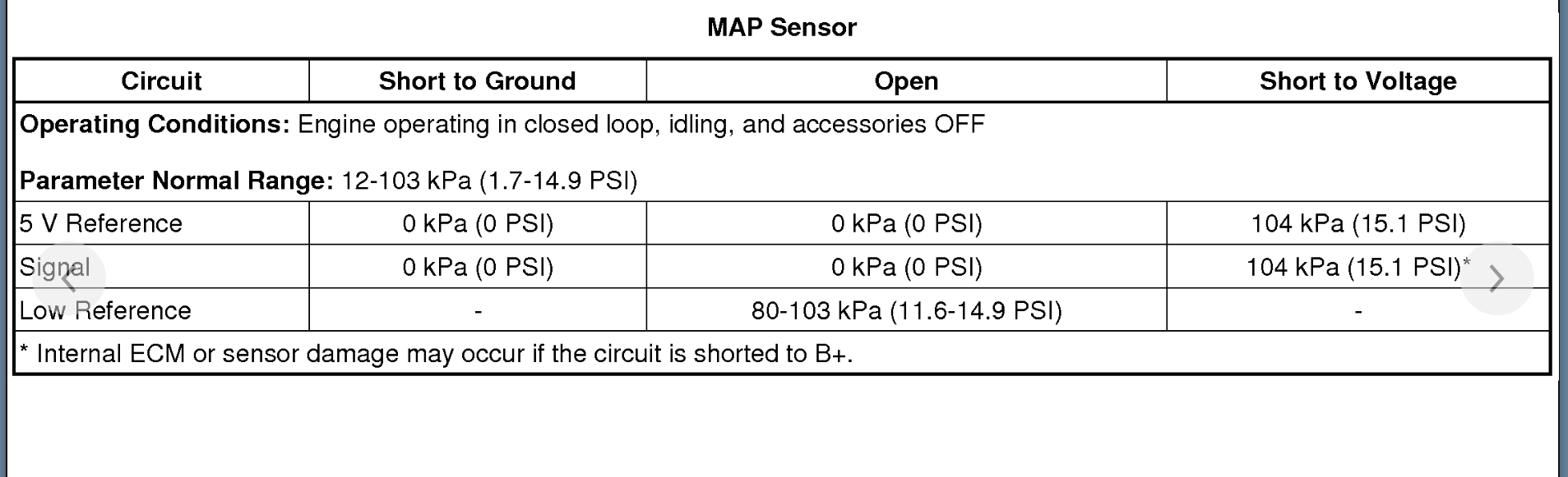

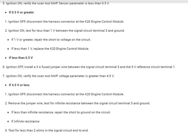

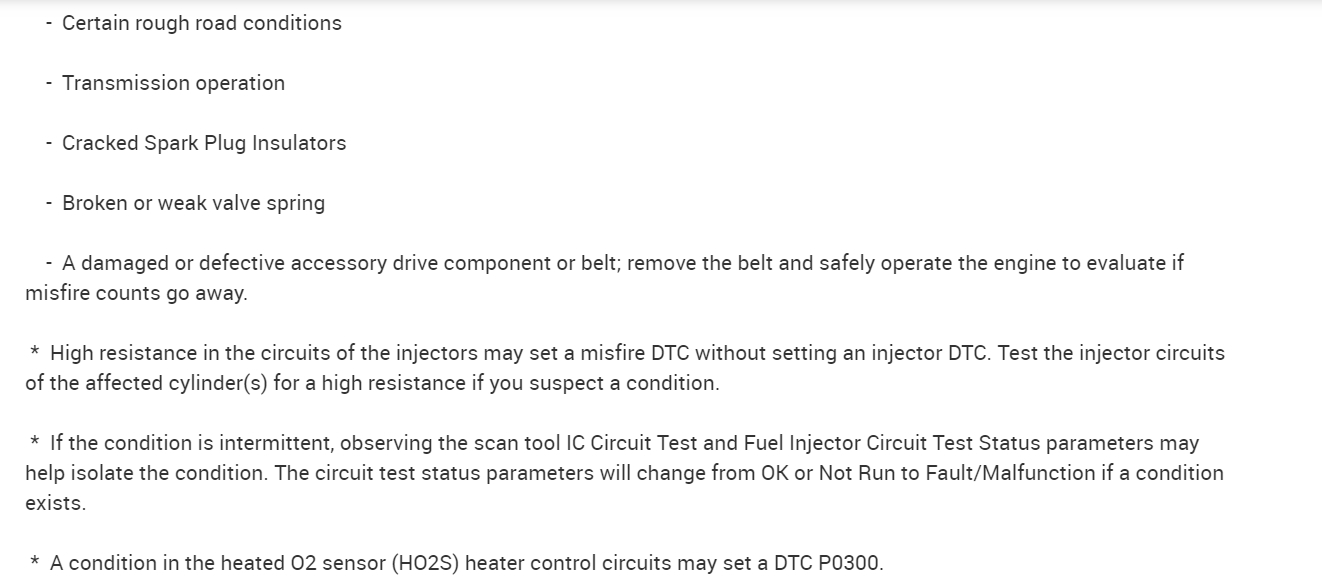

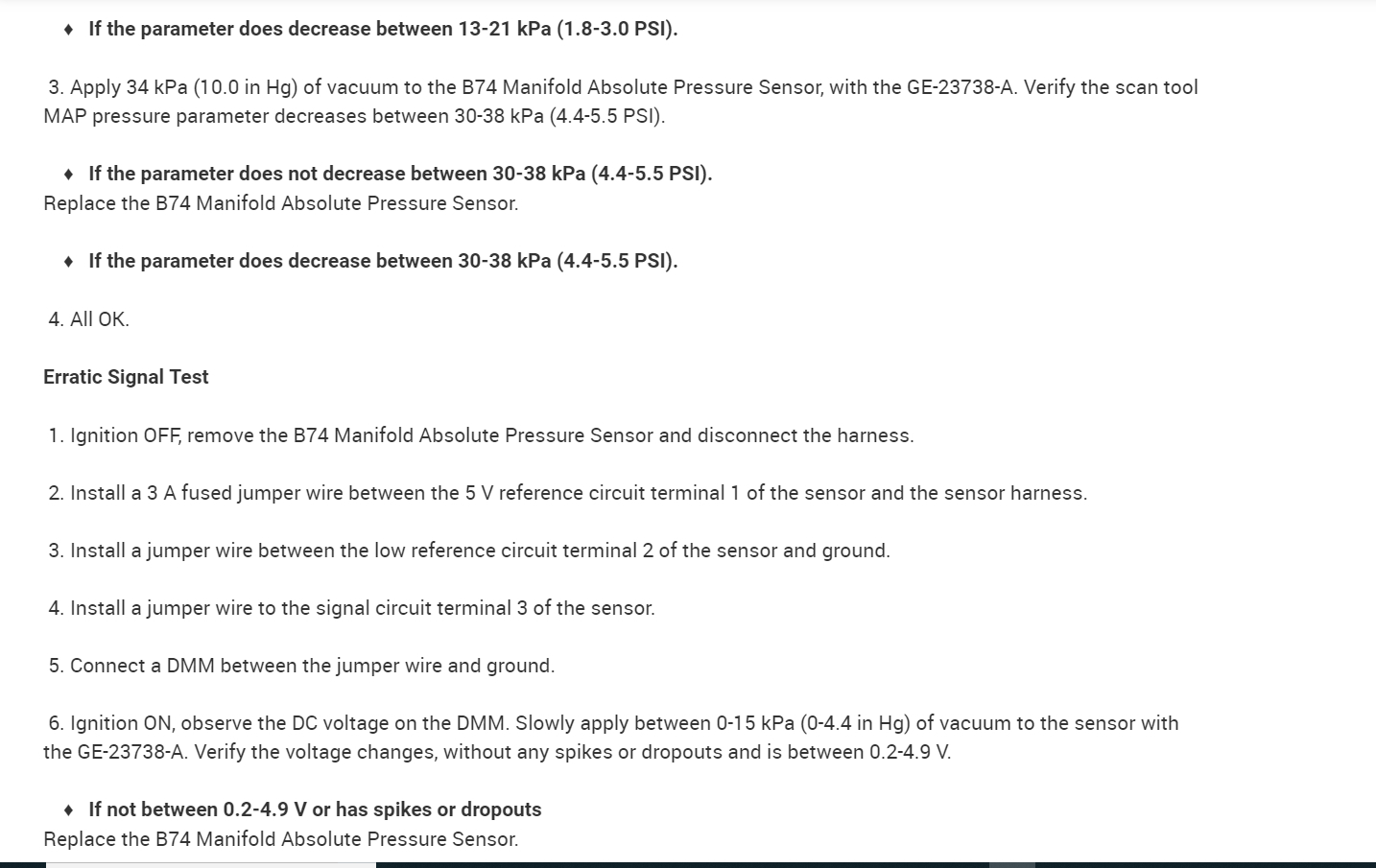

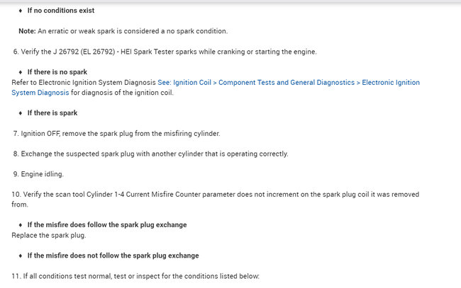

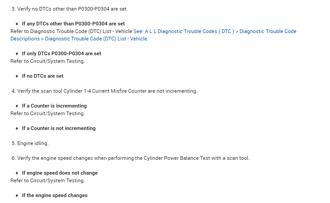

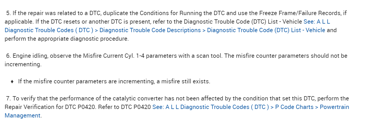

Direct Trouble Code (DTC) P0106 is set for Manifold Absolute Pressure sensor(MAP) performance and DTC P0303 is set for a misfire in cylinder #3. I have included in the diagrams down below the factory diagnostic troubleshooting guide for both of these DTC's for your vehicle. Please go through these guides and get back to us with what you are able to find out.
Thanks,
Alex
2CarPros
