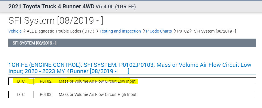

Because this vehicle is new, it needs to be checked at the dealership. The code you have indicates a low voltage issue from the MAF. When this DTC is set, the ECM enters fail-safe mode. During fail-safe mode, the ignition timing is calculated by the ECM according to the engine speed and throttle valve position. The ECM continues operating in fail-safe mode until a pass condition is detected. I believe that is where you are getting the drive cycle info. Keep in mind, when the ECM continues in a fail-safe mode, it will run fine. However, it isn't running as efficiently as it should. Make sure this is resolved before the warranty has expired.

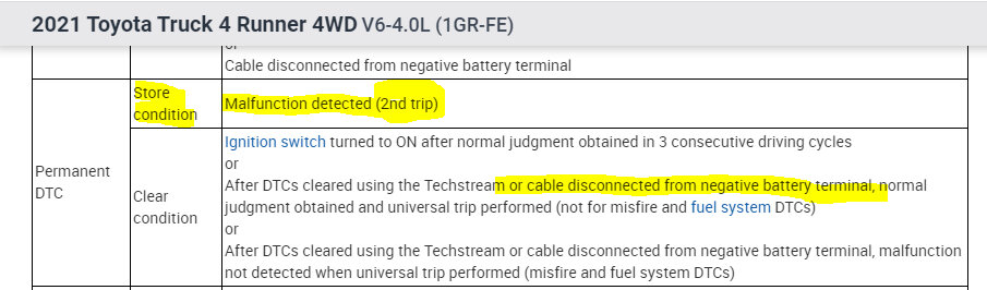

As far as a permanent code, in this case, the code is set when there are two consecutive drive cycles when the problem is present. If you disconnect the battery (neg first) then the positive, tie the two cables together with a zip tie, and allow it to remain that way for approximately 15 minutes, it should clear the code. However, if the problem is still present, the same thing will happen after the second trip

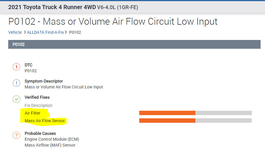

See pics below Note: Pic 1 describes the code, pic 2 shows the most common repairs (yours is too new for an air filter but there could be a wiring or sensor-related issue) and pic 3 explains how it is set and how you can try to clear it.

Thanks for the explanation and pics Jacob and Nickolas! I will certainly head to the dealer and get it checked out.
