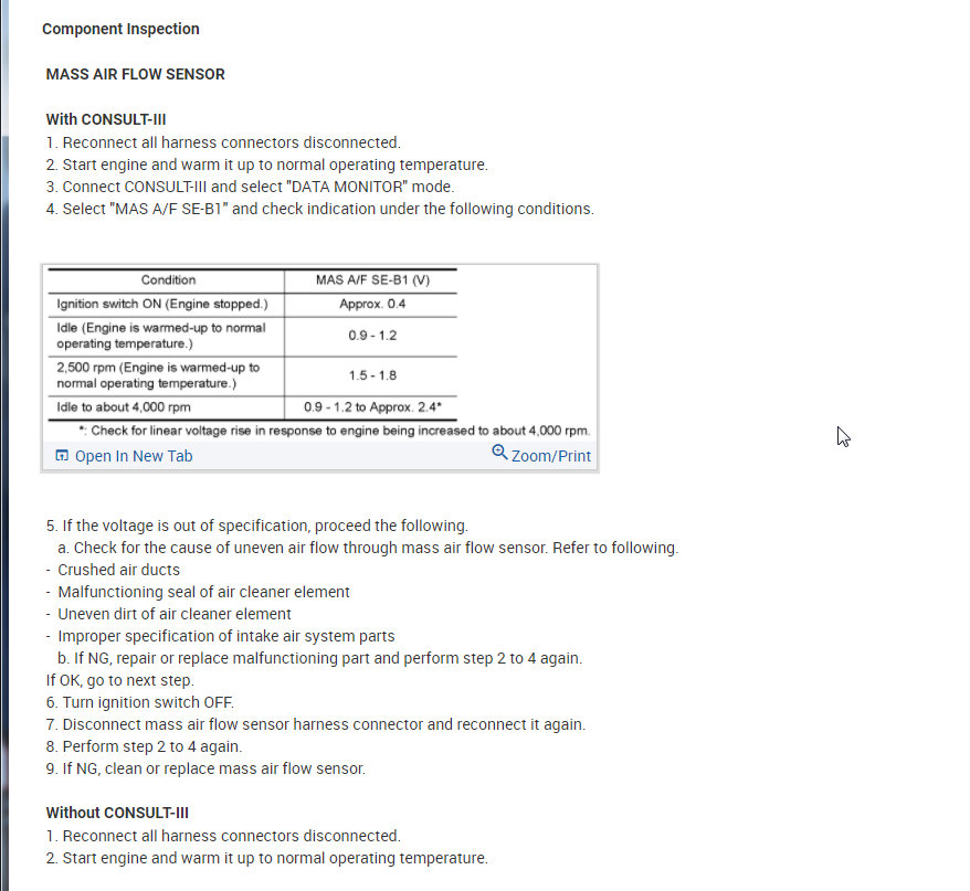

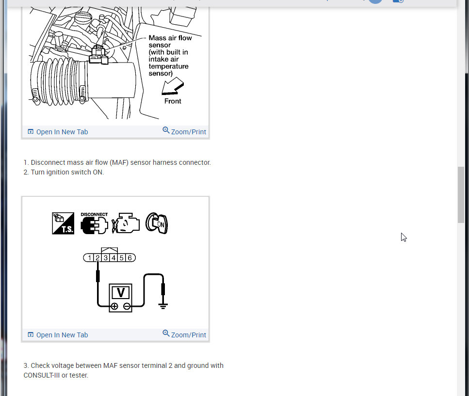

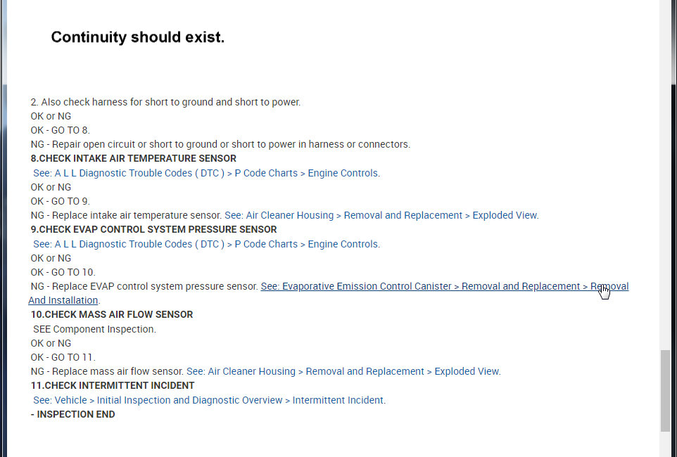

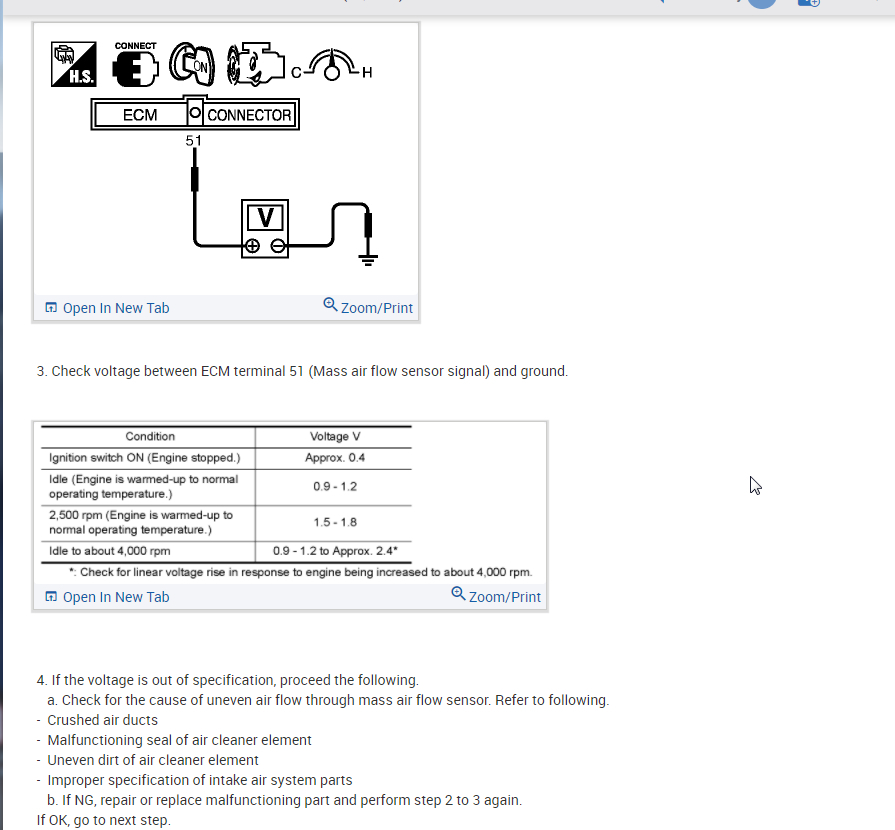

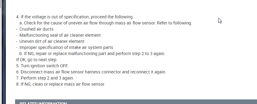

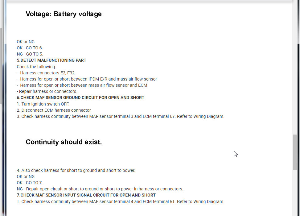

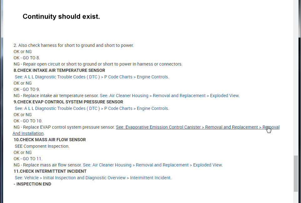

It can be frustrating when they guess at what it could be even when you have a code telling you where to go and what to test.

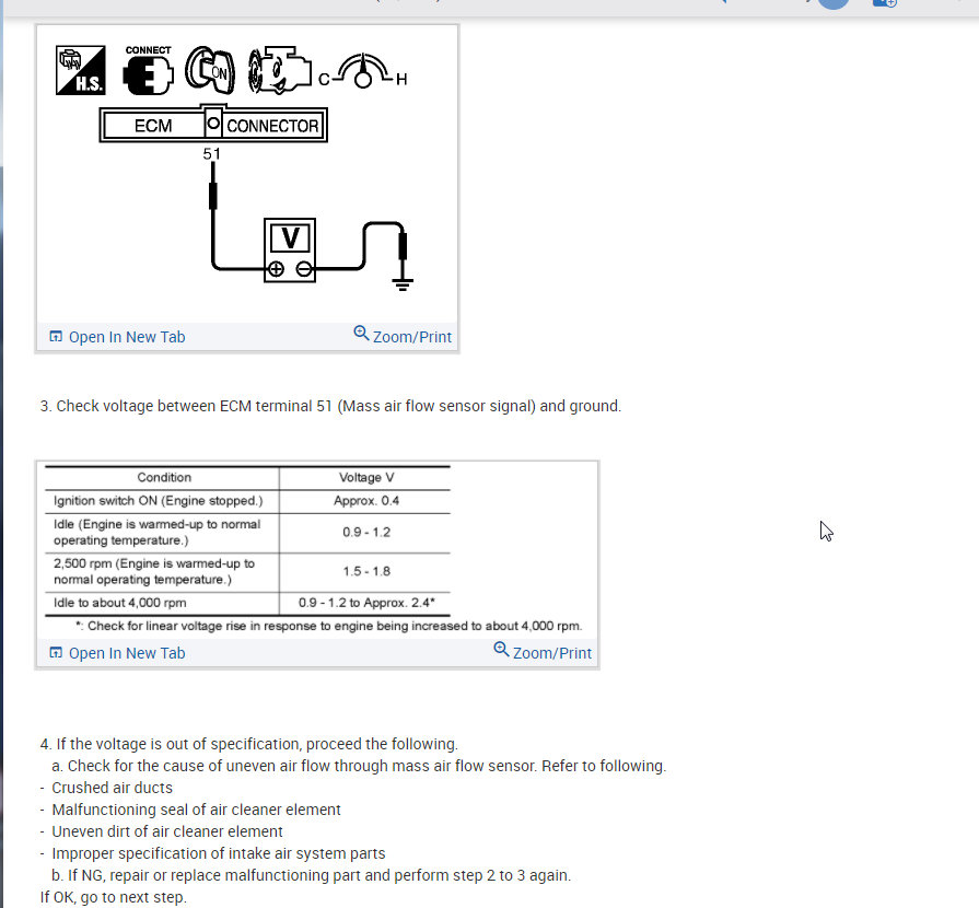

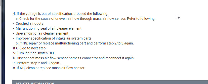

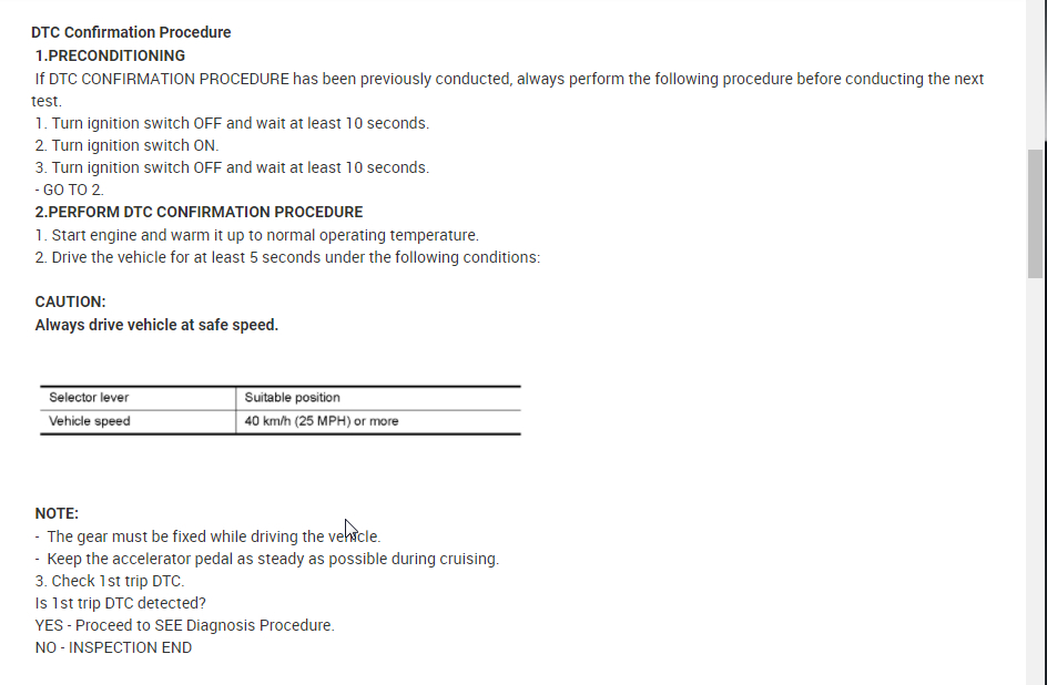

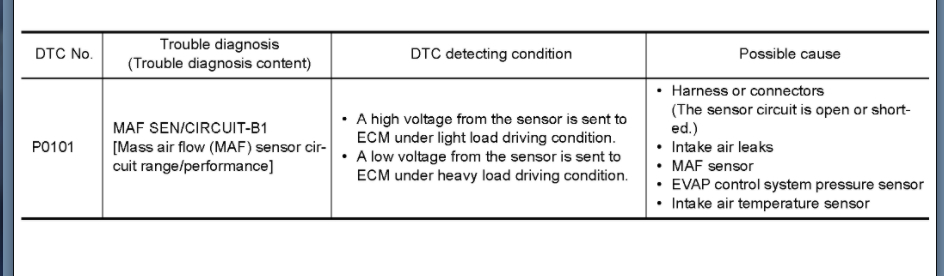

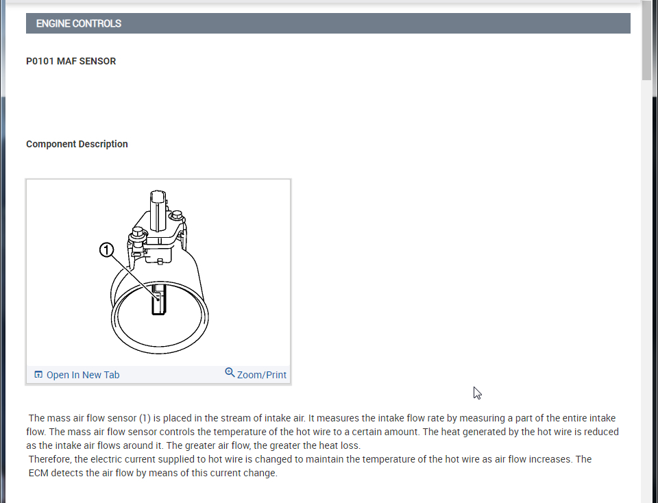

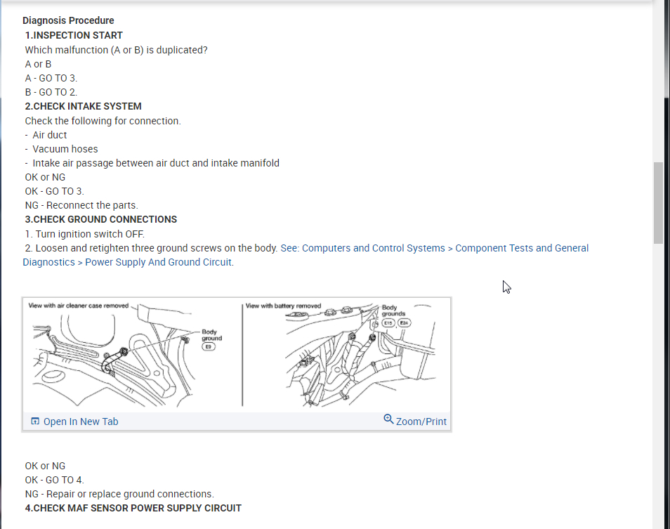

I attached the testing that we need to do in order to figure this out.
If you look at the second attachment you will see possible causes. Clearly MAF is on there but unless the replacement sensors you are getting are not correct for this vehicle (good possibility as they are made cheap and give the wrong reading to the ECM) or you have another one of these issues listed.
If you look under the DTC detecting condition, you will see that it sets this code when it is giving incorrect readings during different driving conditions. This is why it may take a little while to reset the light. You have to reach the driving condition where it is not correct and it sets the code. This is why it could be a sensor if you replaced it twice with the same name brand part. If the part is not made correctly then it could be giving a different reading then the ECM expects because they did not make it correctly for your vehicle. It does not happen often but it does happen.
Let's run through this testing and we can go from there. Let me know what questions you have.
