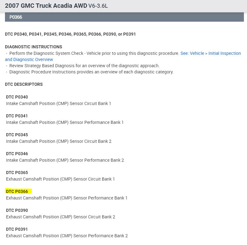

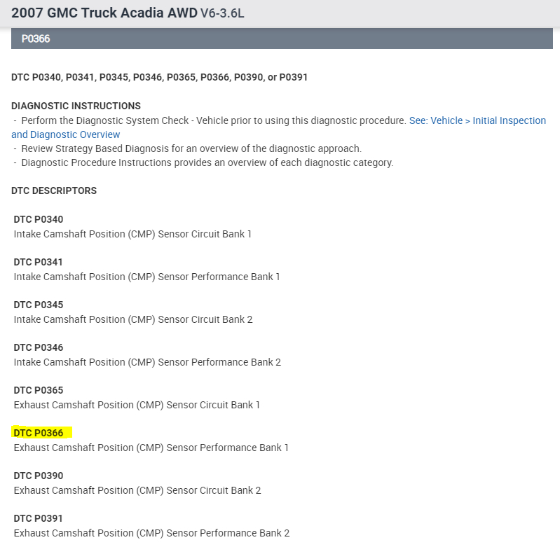

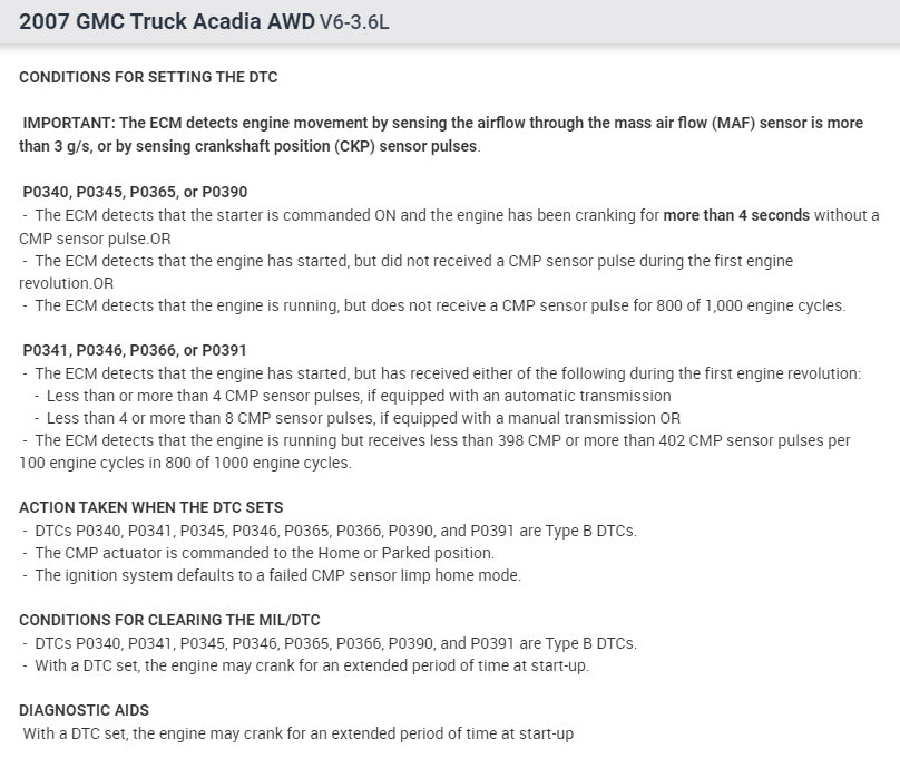

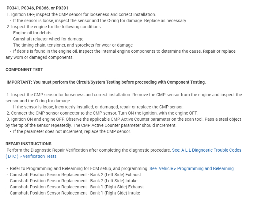

The code P0366 Exhaust Camshaft Position (CMP) Sensor Performance Bank 1
This is likely not related to the overheating.

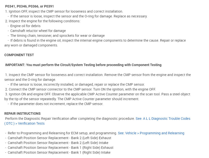

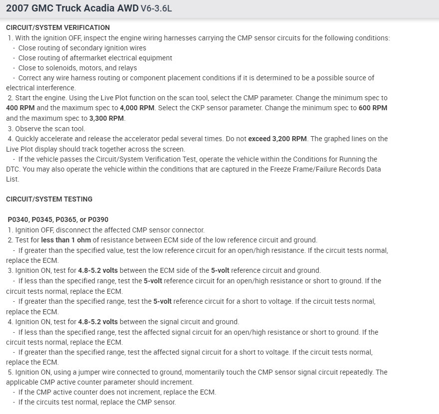

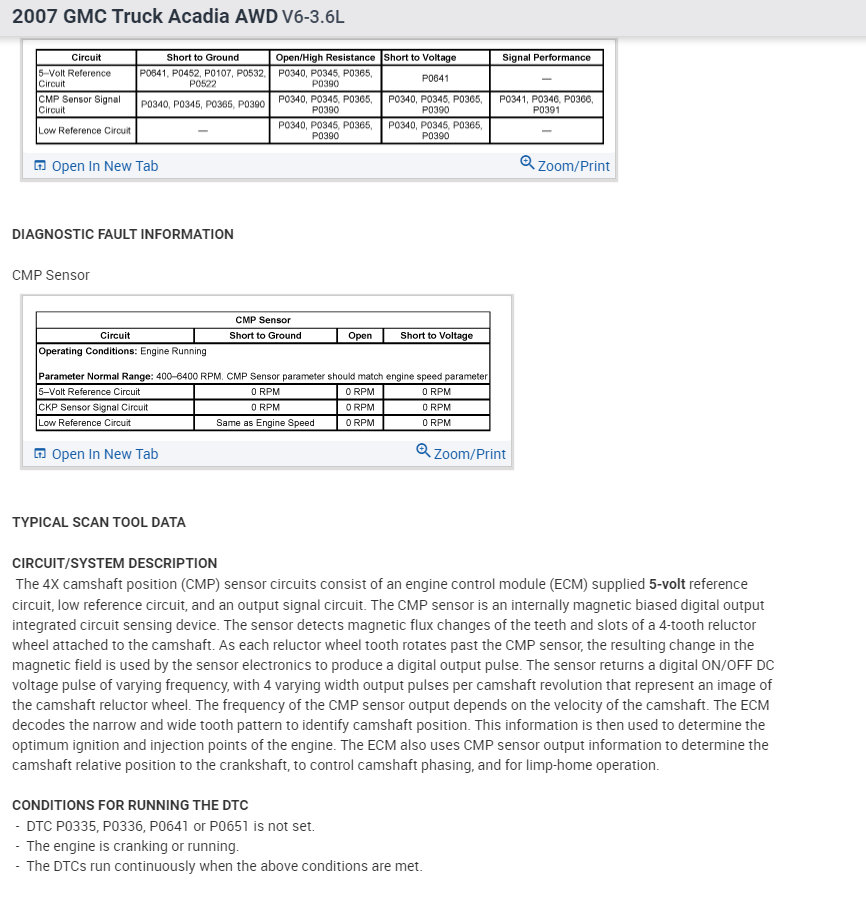

I have attached the trouble shooting guide for the code P0366 below.

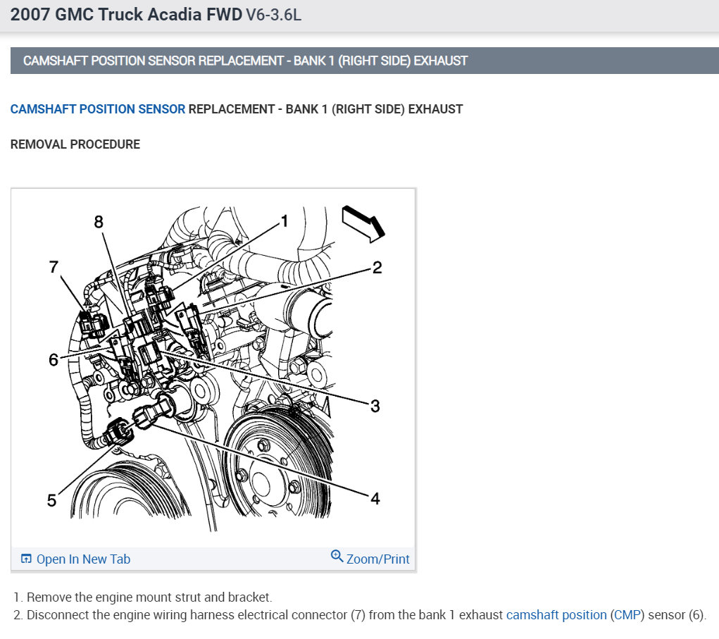

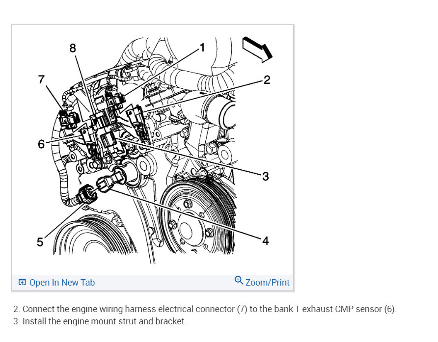

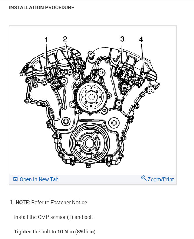

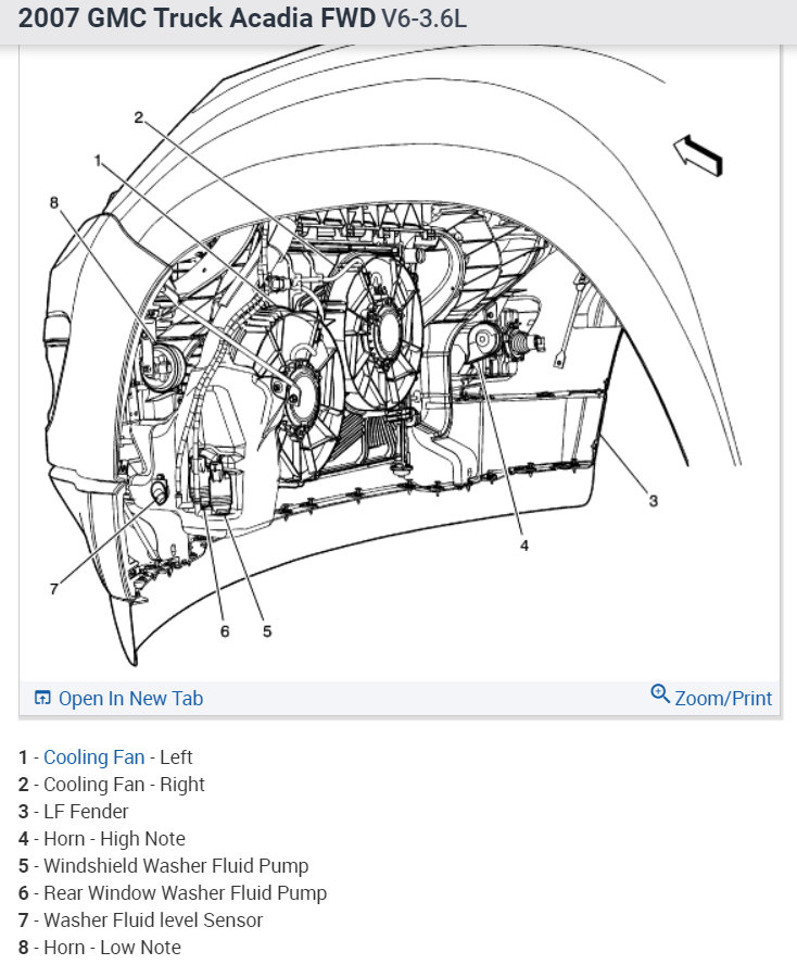

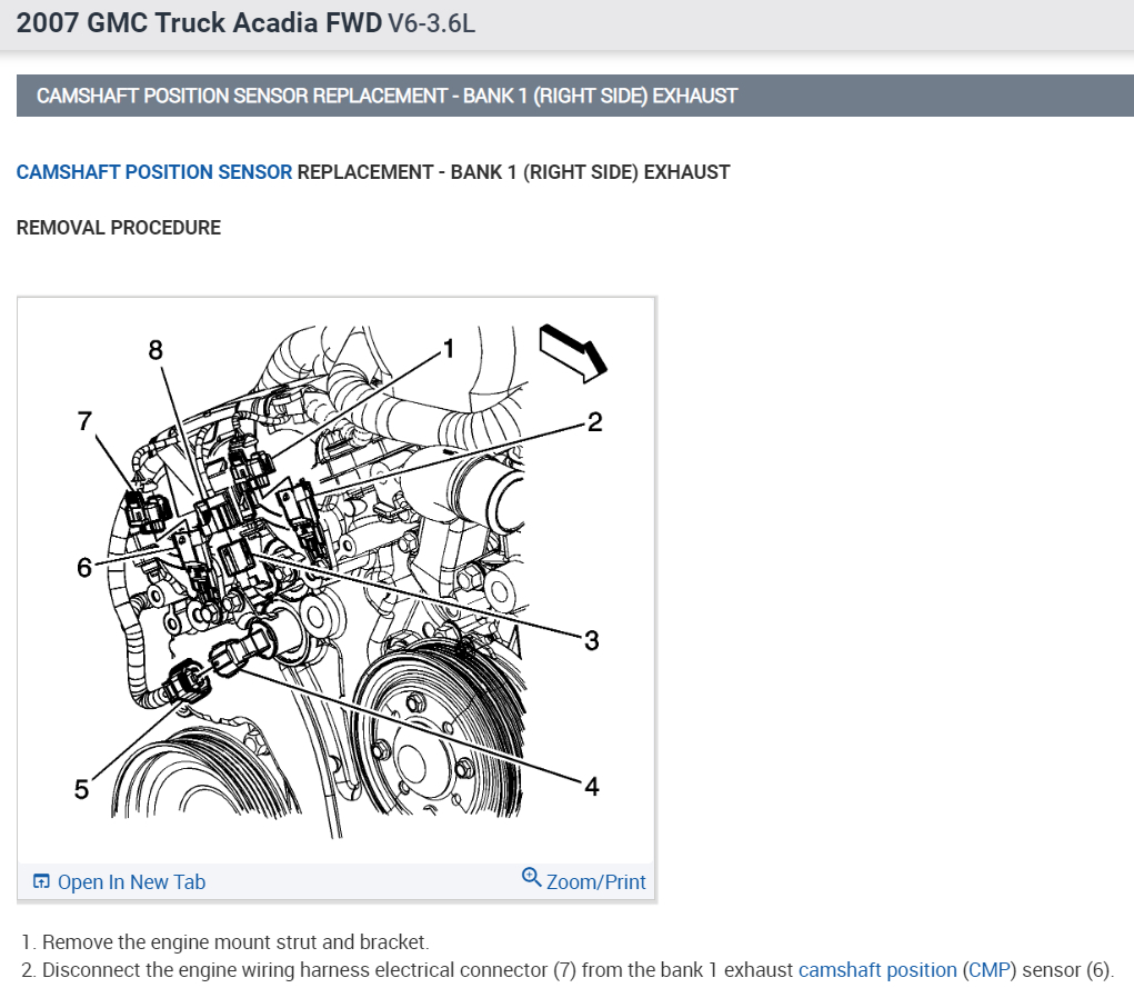

The P0366 code is the camshaft position sensor B is not working which can make the engine run sluggish as you have described. When the engine is heating up can you hear the fan running? You could have a cooling fan relay not working. I have attached some diagrams below, also is the car full of coolant? only check when the car is cold. This guide can help as well:
https://www.2carpros.com/articles/engine-overheating-or-running-hot

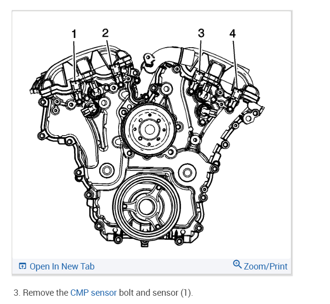

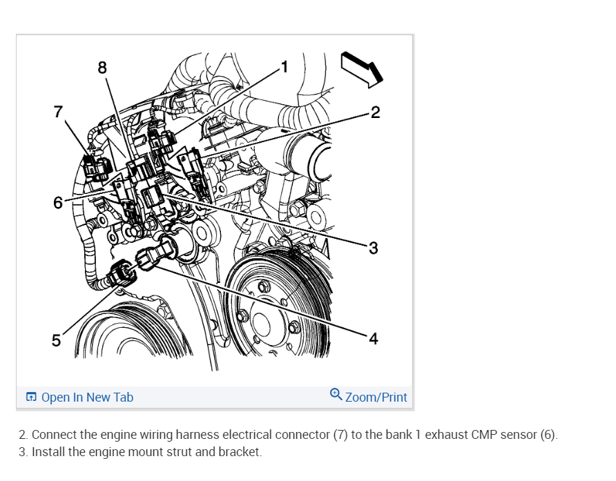

As far as the code P0366 here is the sensor location sensor bank1 position 2 (exhaust) so you can change it out and then clear the codes. Check out the diagrams (below). Let us know what happens and please upload pictures or videos of the problem.
