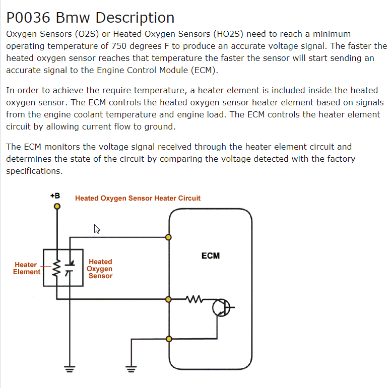

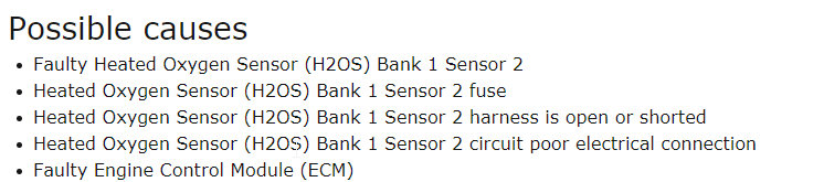

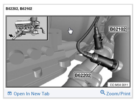

Hi, i recently had to change my drivers side suspension coil as it broke. then once i had the car back i have been getting two warning lights on my dash; one being the traction control ABS, the other being the handbrake light both in amber. Here is the read out i got with obd:
i think it has added the image?
