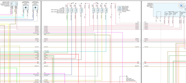

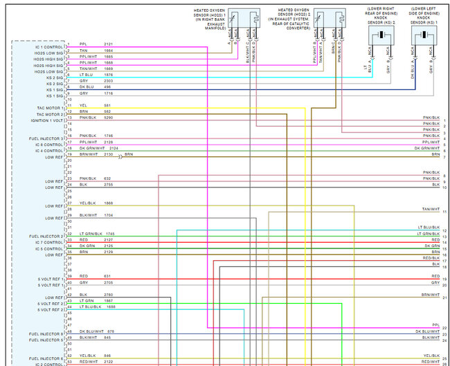

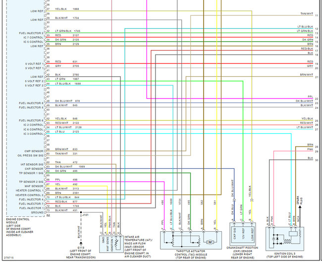

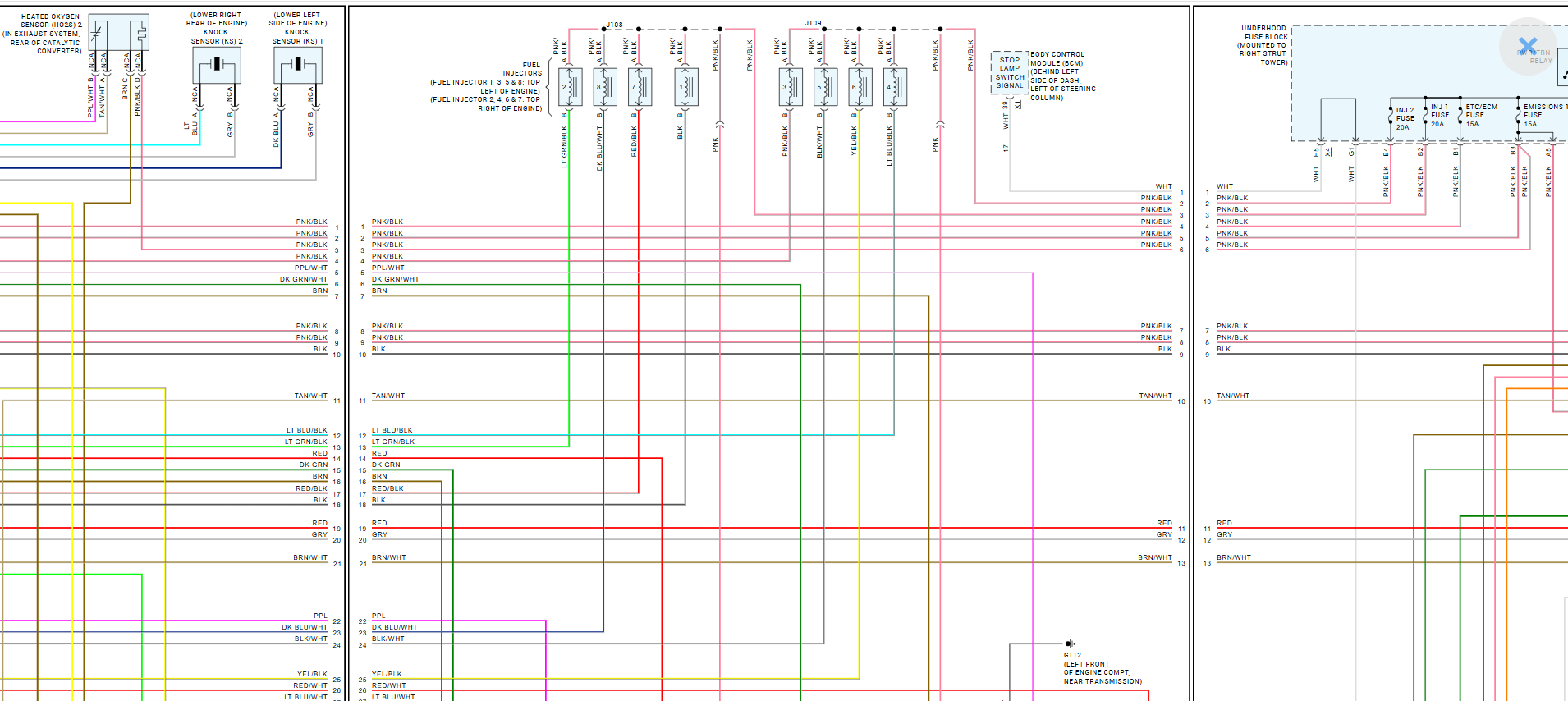

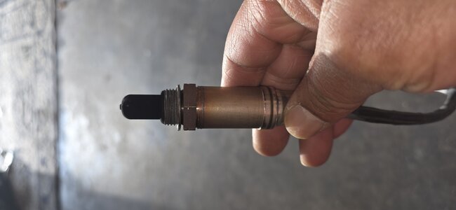

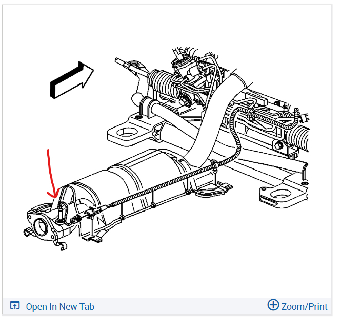

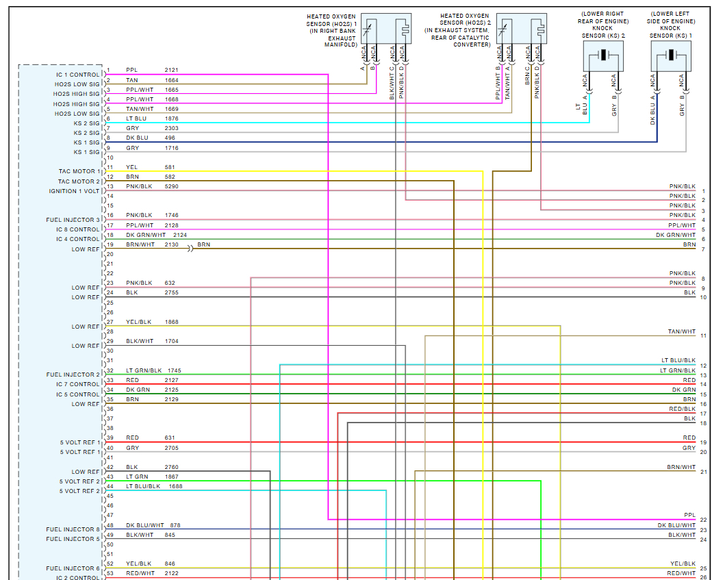

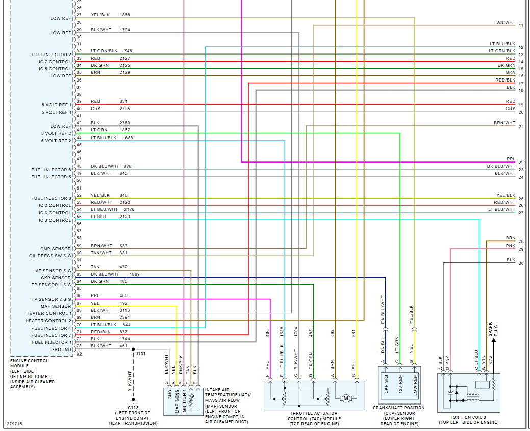

Need help. What else is causing this code? I changed my sensors again this time with ntk top and bottom. My wires are not damaged on both sensors they look good, and my car drive good. What else can I change to fix before emission?
