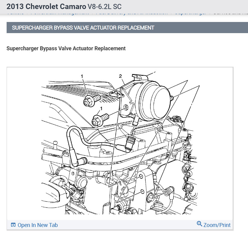

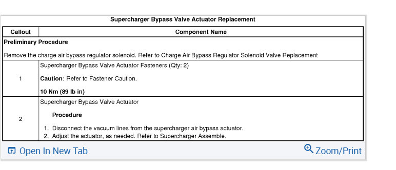

The control circuit code is the issue which happens when the wiring is bad, or the bypass valve has gone out. Most of the time it will be the valve here is the location and how to change it out which should fix the problem. Check out the images (below). Let us know what happens and please upload pictures or videos of the problem so we can see what's going on.
