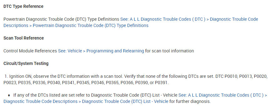

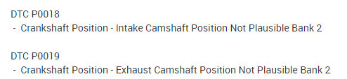

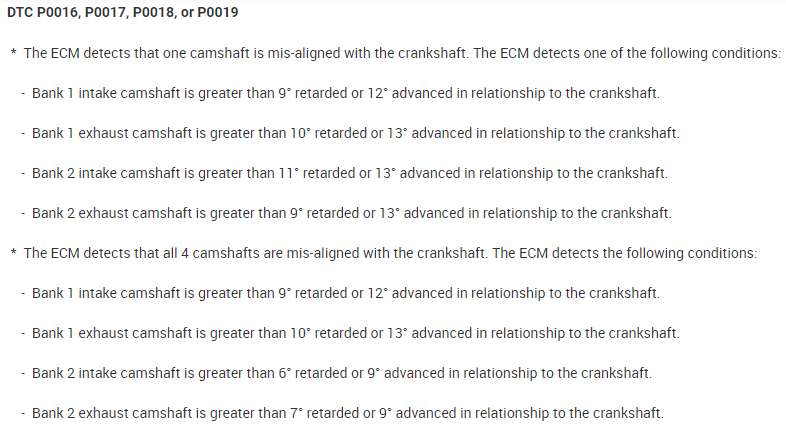

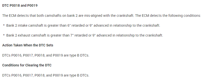

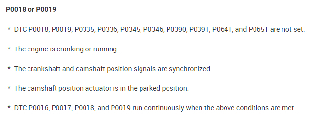

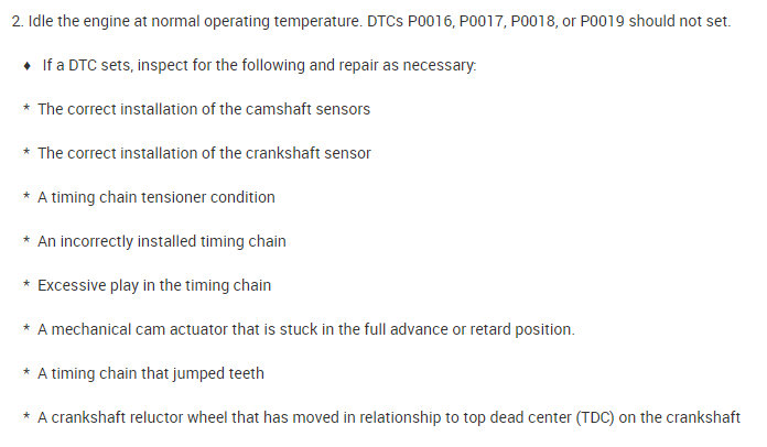

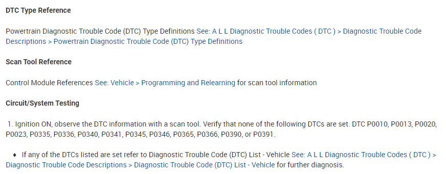

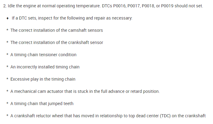

I am getting these codes and don't know what sensor to change camshaft or crankshaft. Also don't know where there located.
Apr 17, 2021 at 10:51 PM
DANNY L
  • 5,648 POSTS
Hello, I'm Danny.

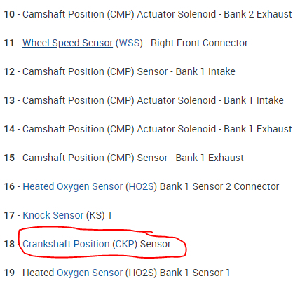

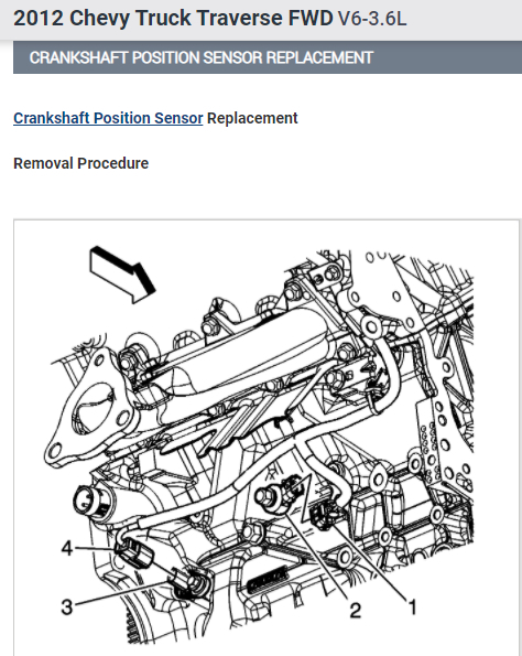

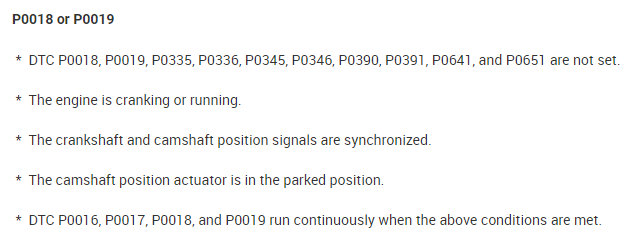

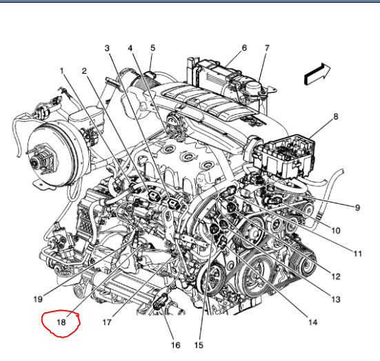

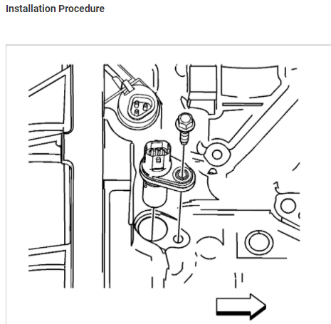

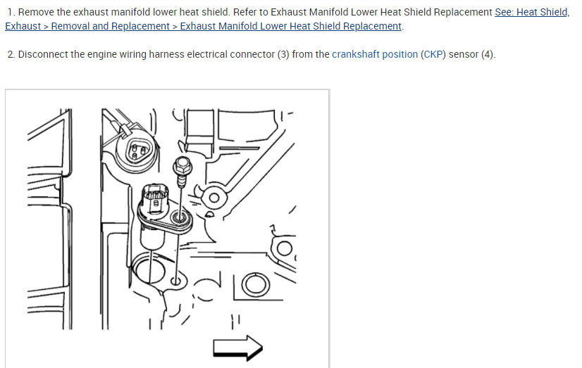

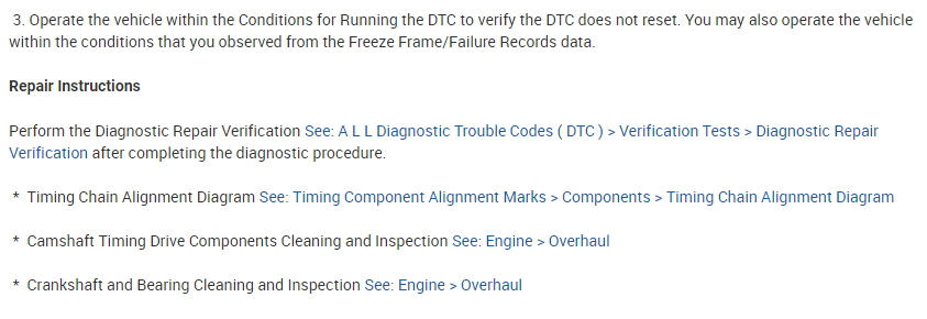

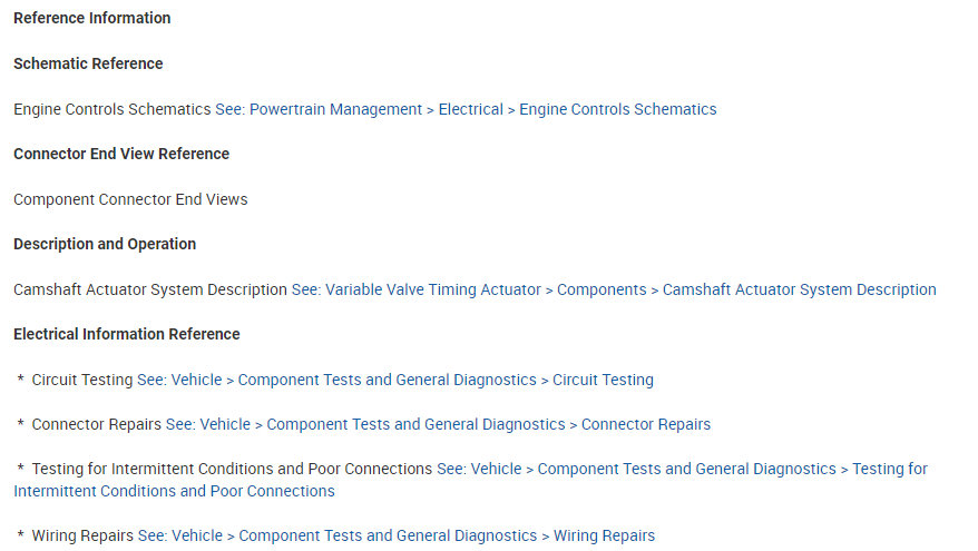

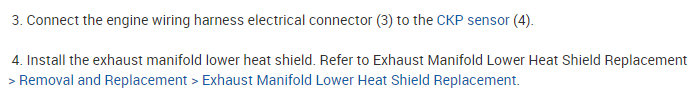

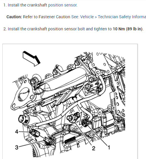

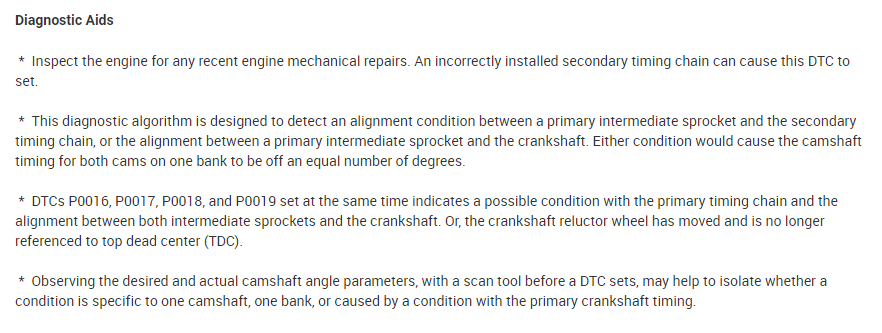

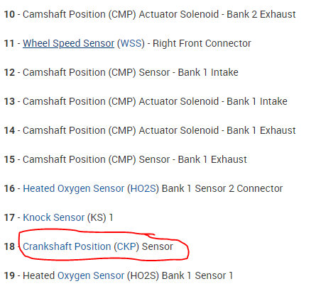

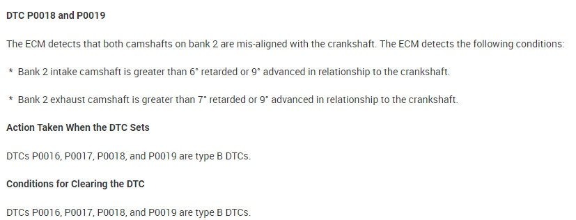

Here is the information you requested. Those codes are related to the crankshaft position sensor and has nothing to do with the camshaft position sensor whatsoever. Here is a tutorial showing how to replace a crankshaft sensor:
I've attached picture steps below showing how to remove and replace the crankshaft position sensor including its location -circled in red- on your vehicle. Hope this helps and thanks for using 2CarPros.

Well, I changed sensor light stays off while driving and engine runs better but every time I shut car off and restart check engine light comes on. After I reset it, it stays off .
