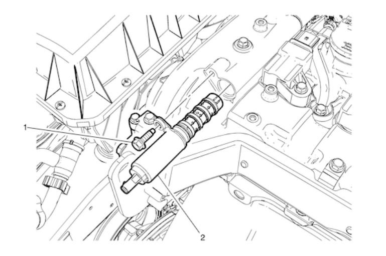

I'm going through checking wires noticed oil in the connector to the exhaust cam actuator. I don't think it should be there, right? Could this be causing the code?
Nov 25, 2019 at 8:44 AM

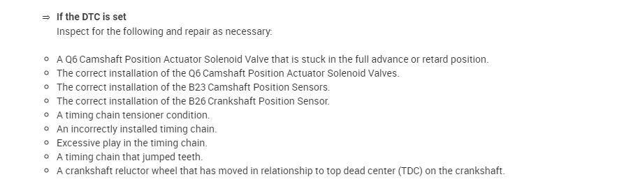

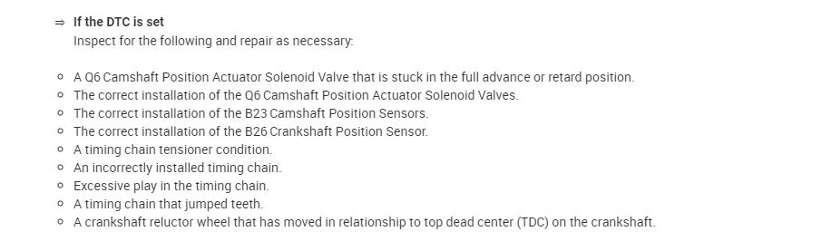

Good morning,
Yes, it could. Clean the connector out of all fluid and retry.
The most common reason for this is dirty oil holding the actuator open.
I would have the oil system flushed out for all dirt and debris. This is not an oil change, it is a system power flush which gets into all the passages.
Was there any other code besides the 17?
