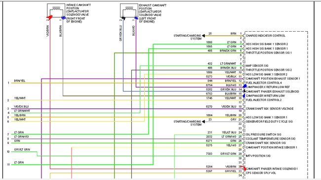

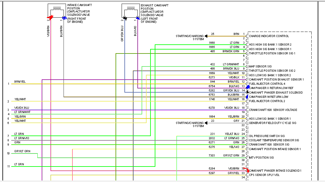

A year ago when I changed my timing belt and components, my car threw a p0017 and p0016 code. I replaced the solenoid valves and camshaft sensors. The light was still on so I took it to the dealership. It has been off a year until now, but they said they didn't do anything it just went off by itself. The car runs fine and no loss of power. I replaced my timing belt and components again about 5,000 miles ago. Not sure what to try next. I hear no noise from the timing area the screens on the valves are clean, and the belt is tight within clearance.
