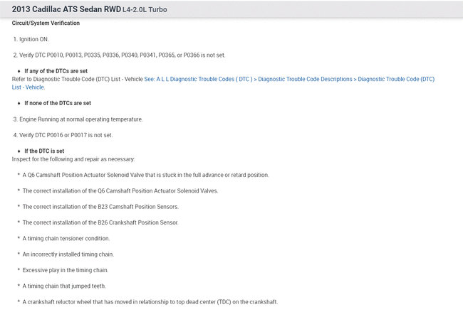

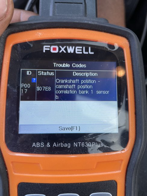

The code could be caused by a few different things. First, the actuator could be faulty, not properly installed, or there could be a wiring issue. Also, there could be an issue with the timing chain or chain tensioner allowing excessive play in the chain and throwing off timing.

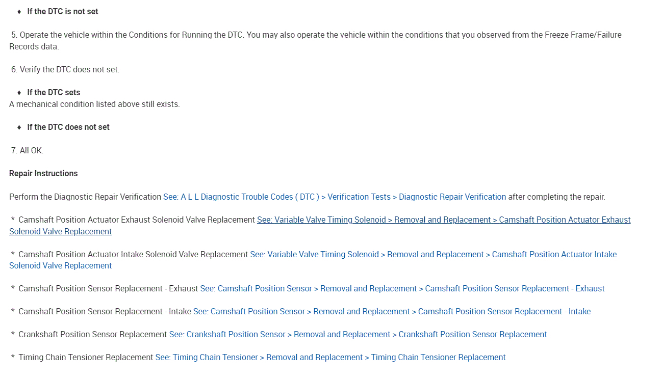

Take a look below at the diagnostics related to the code and let me know if you are comfortable performing the tests.
Take care and let me know what you find.
See pics below.
