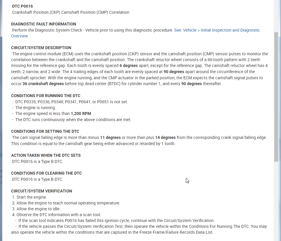

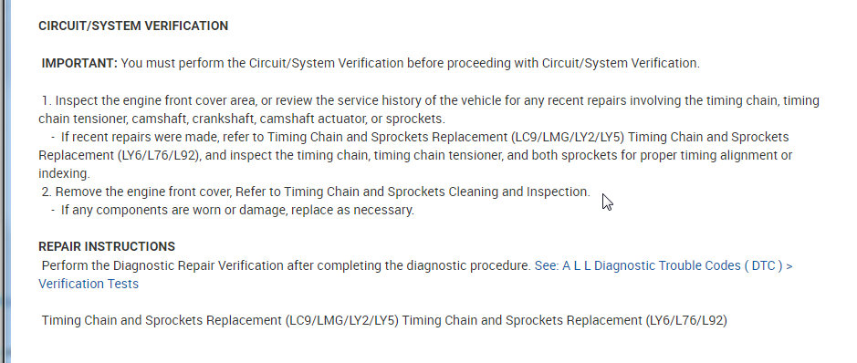

Changed camshaft sensor. Runs a little better. When pulling a camper going from 3rd to 4th gear the pedal goes to the floor and RPMs go up. Let off a little and it shifts back and misfires. After pulling the camper maybe 5 miles the truck says engine losing power and shuts off.
