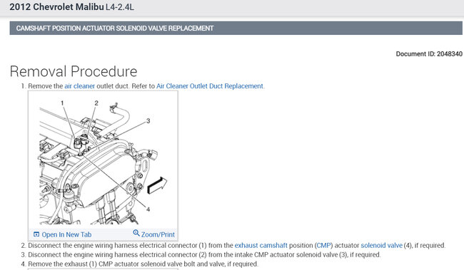

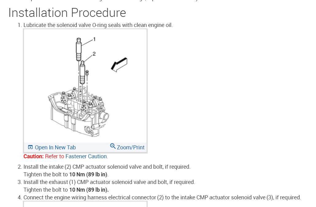

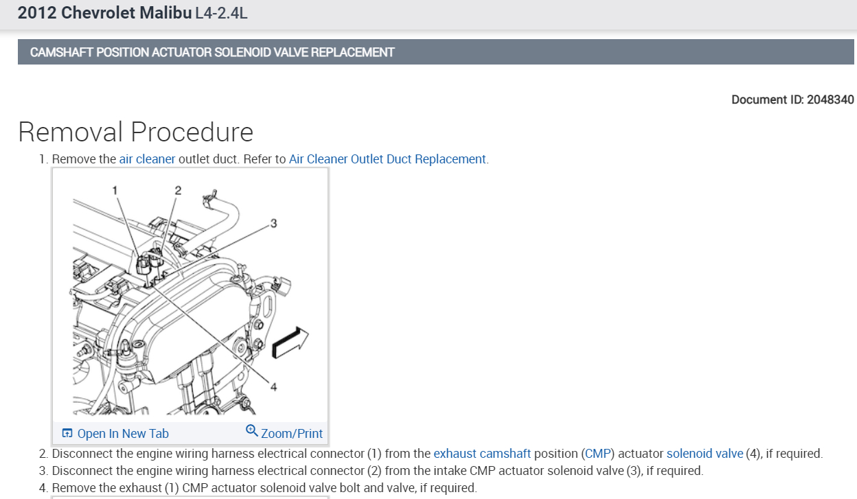

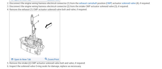

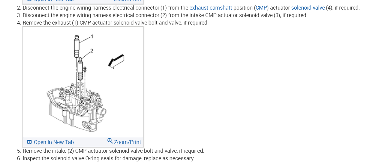

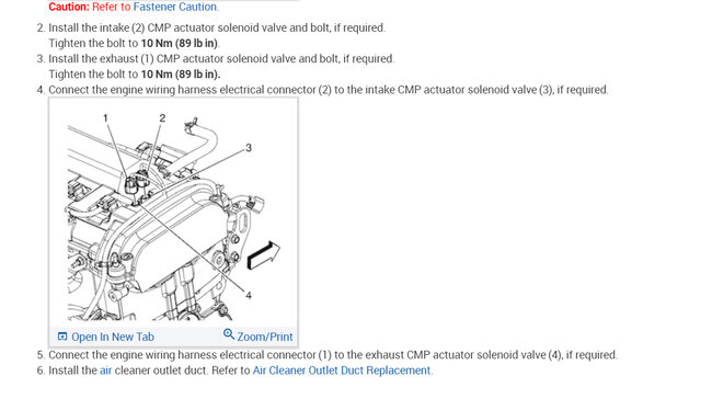

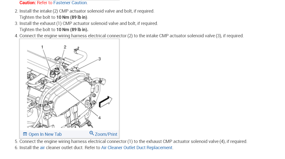

P0016 camshaft position sensor for bank 1 does not correlate to the signal from the crankshaft position sensor. So, I would remove both the intake and exhaust camshaft oil control valves and clean out the small oil screen at the front of the valve, here are the locations so you can do the work. Also make sure the engine oil level is clean and full. Check out the images (below). Let us know what happens and please upload pictures or videos of the problem so we can see what's going on.

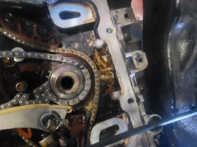

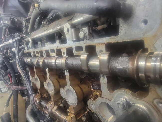

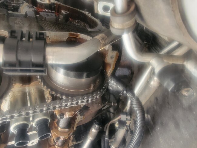

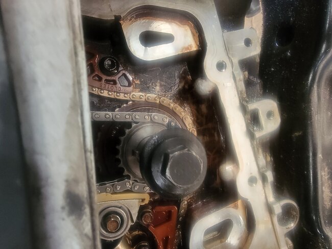

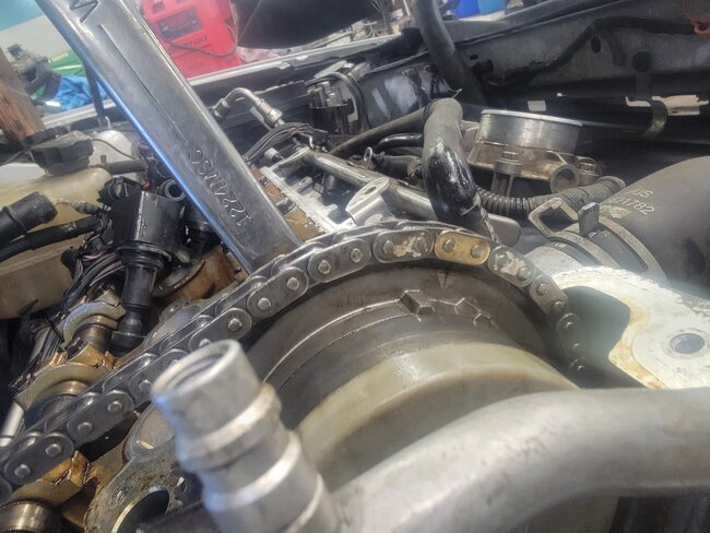

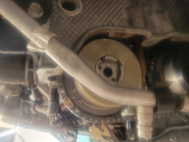

Hi, i only changed the intake actuator and when i changed camshaft position sensor it had sludge on them but i cleaned it out, I'm not sure of the code beforehand because this is a project car. here are pics.
Apr 10, 2023 at 2:26 PM

I'm timing it again and should the crankshaft notch be at 12 o'clock and the dot at 5?because when i do that my intake notch is more at 4 o'clock.
Apr 10, 2023 at 7:50 PM

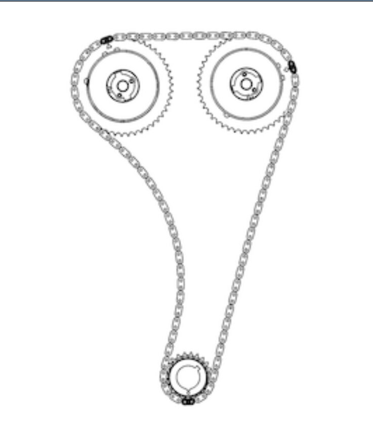

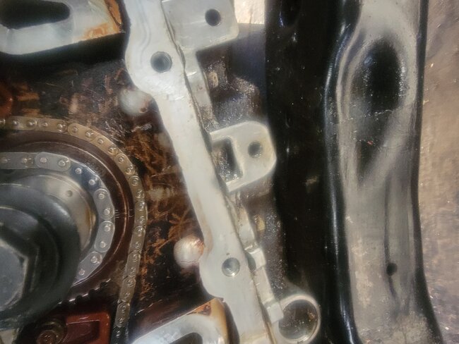

Good morning, i took it apart again can you confirm these locations see below for the pic?
Apr 11, 2023 at 6:37 AM

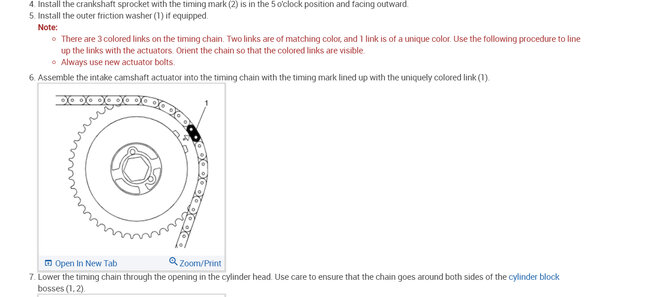

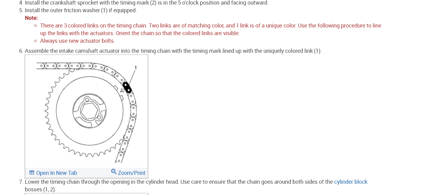

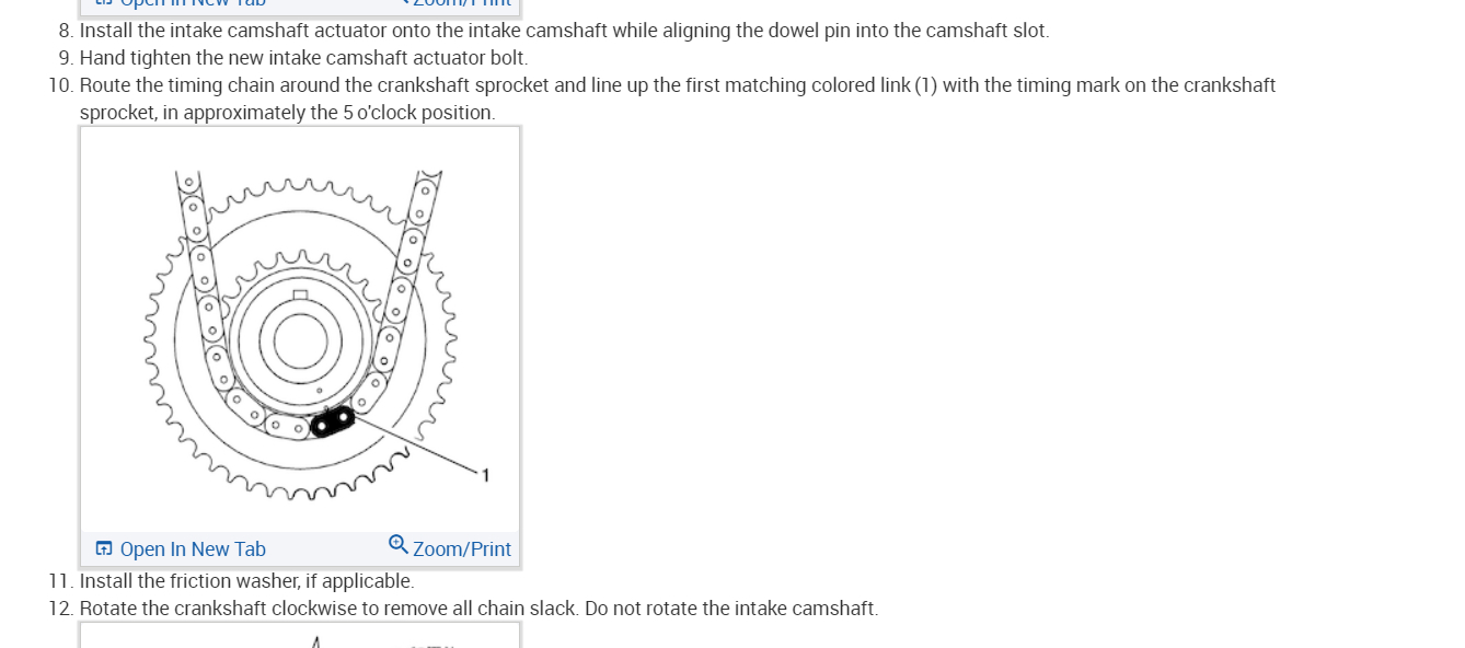

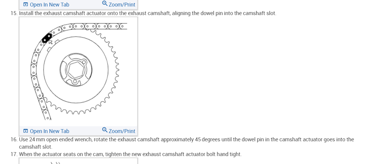

Thanks for the images, here are the timing marks so you can double check your work.
Apr 13, 2023 at 9:38 AM

Thanks, i think i got the code gone after referring to the manual.
