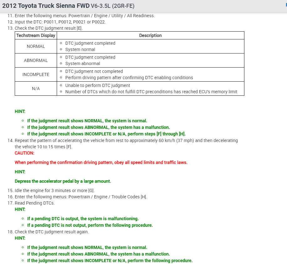

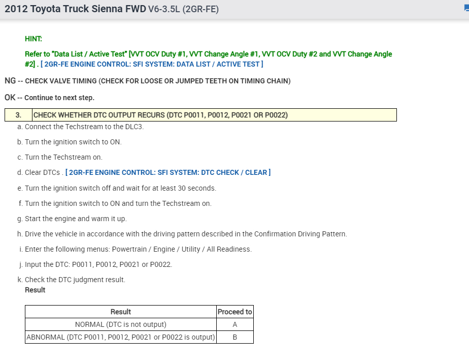

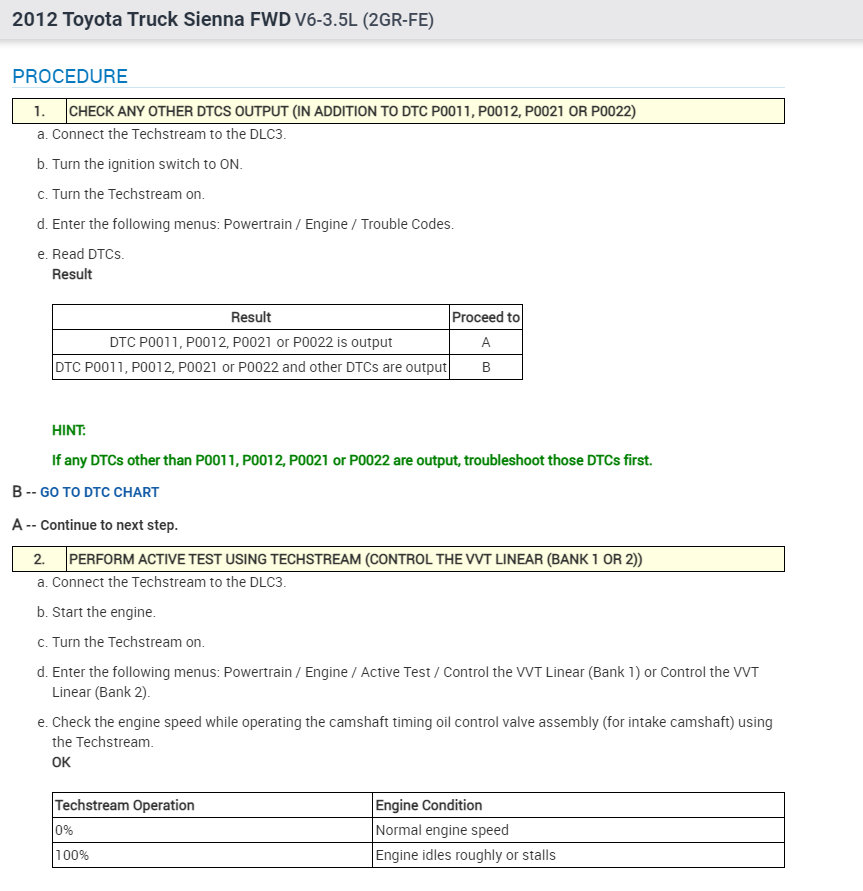

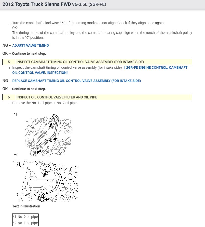

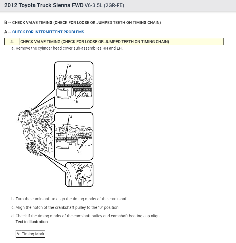

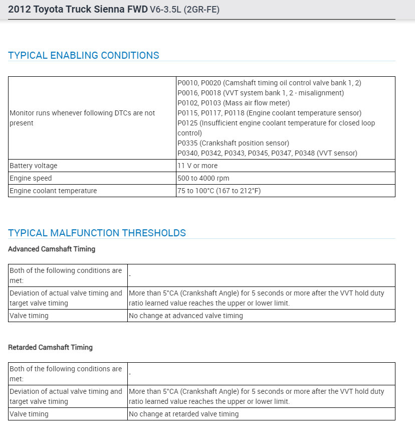

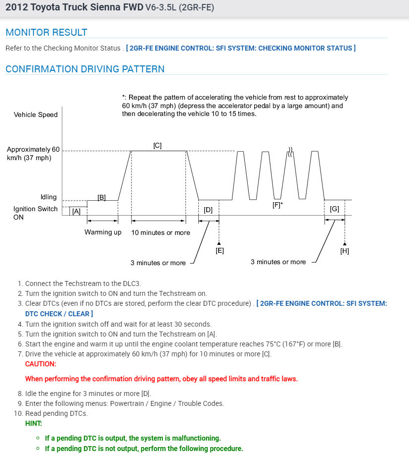

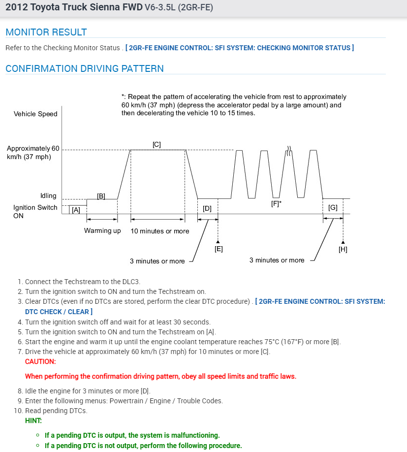

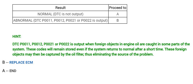

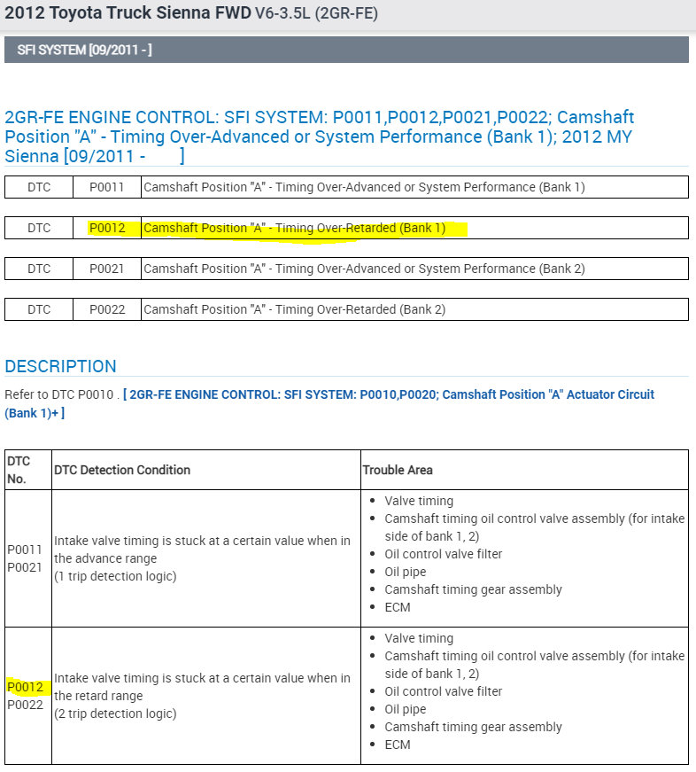

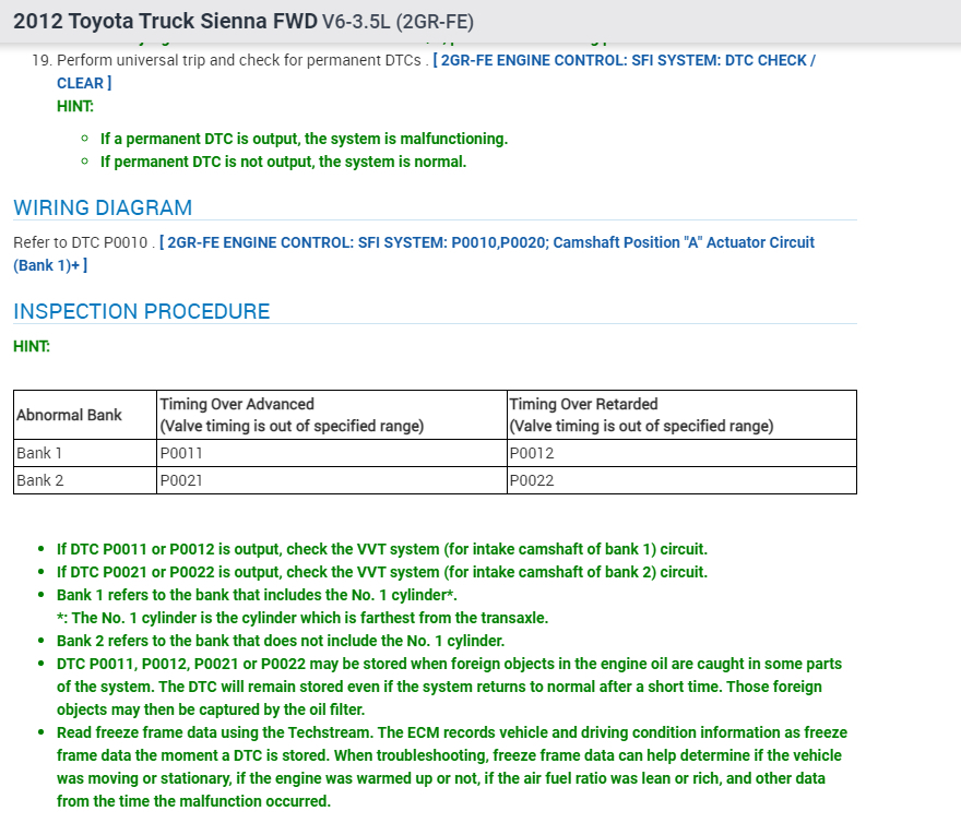

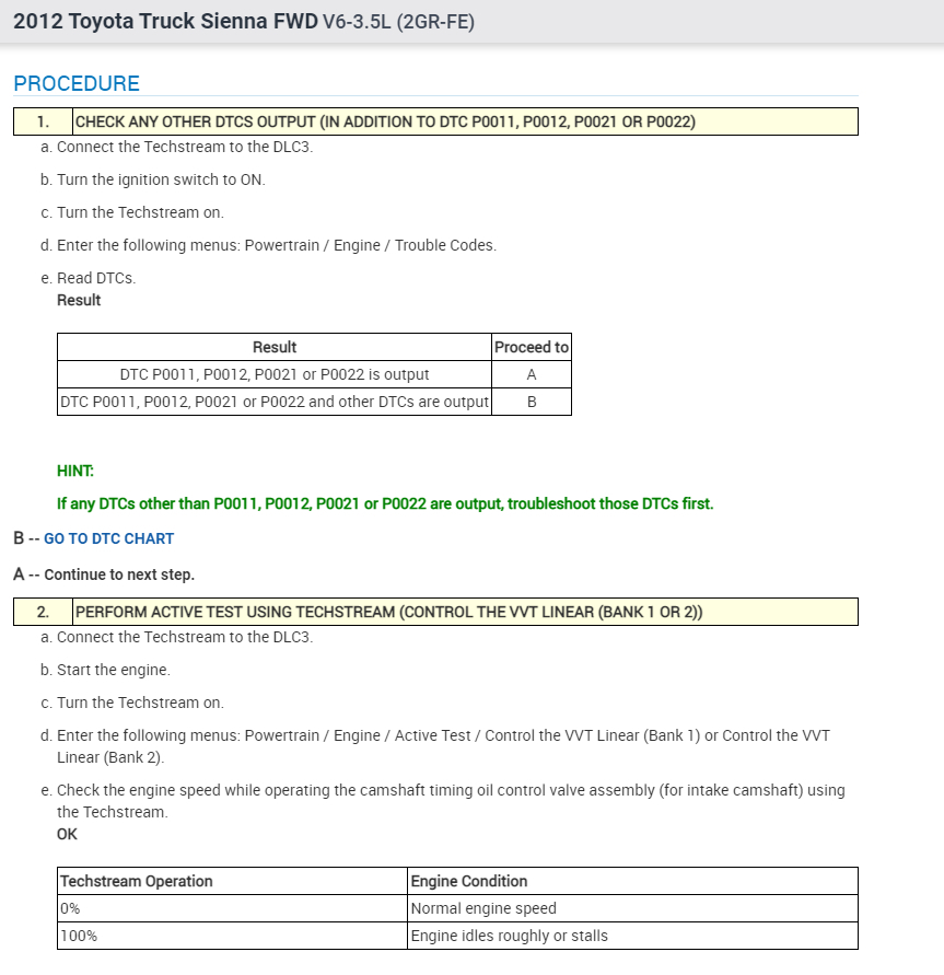

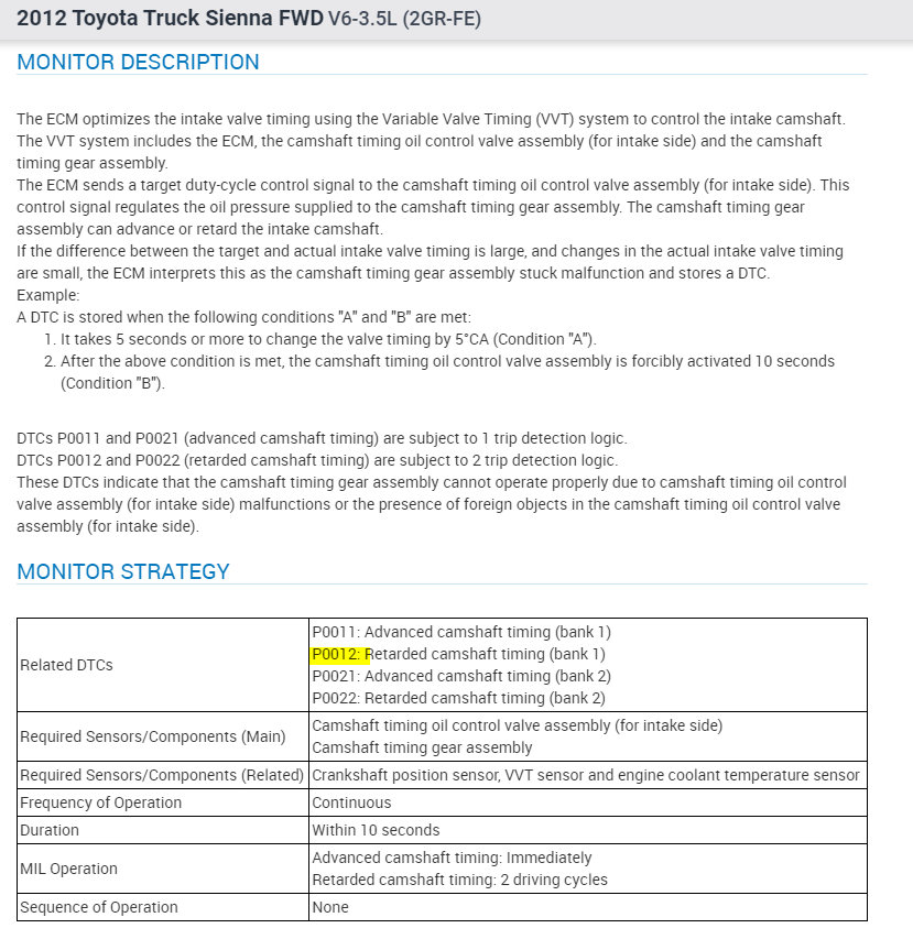

The code P0012 can get triggered due to timing issues, faulty oil control valve filter, the cam timing gear assembly or even the ECM.
This typically leads to irregular idle.

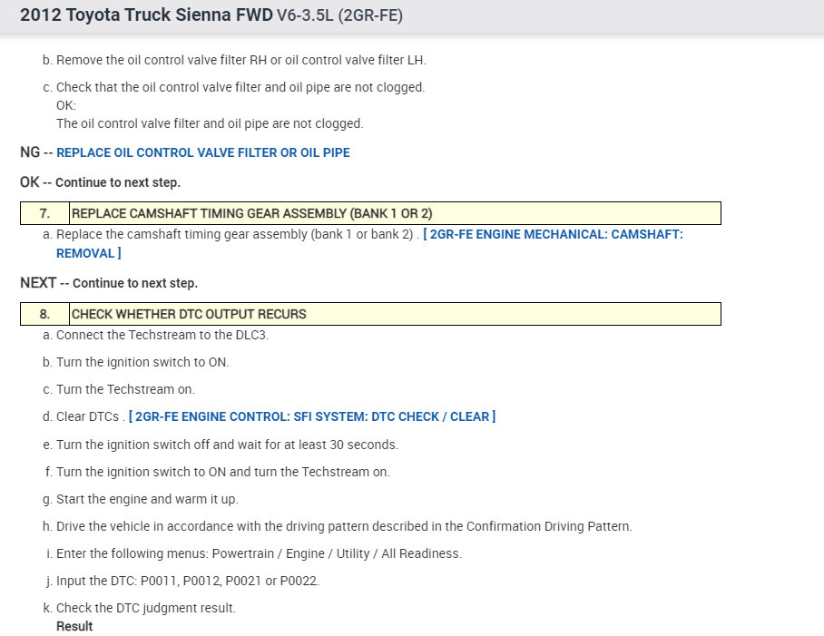

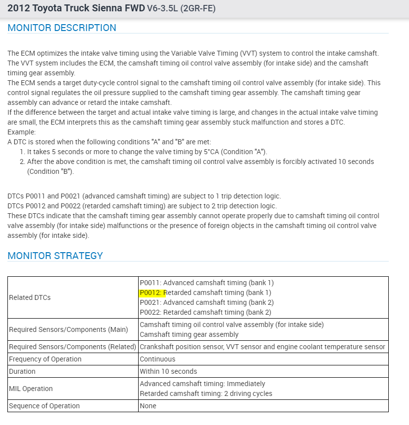

I have attached the diagnostics procedure below for your reference.
Let me know of any questions.
