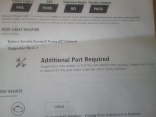

I had AutoZone do a ODBII scan and it threw 2 P0011 codes for the intake camshaft position system performance. Their system recommended replacing the engine variable timing solenoid all 4 of them.

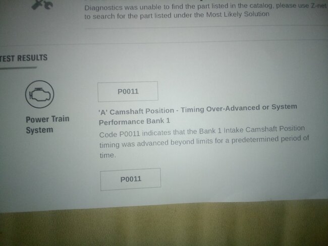

Here is a pic of the read out in case I'm miss interpreting it. Thanks

I don't see the image; can you try reloading it? Most of the time the problem will be the oil control valve stuck open, or the camshaft actuators is stuck in the advanced position.
P0011 - "Intake Camshaft Position Timing - Over-Advanced (Bank 1)"
Also, make sure the engine oil is clean and full. The camshaft depends on oil pressure to work correctly.

Yep, over advanced, I would get all four oil control valves and install them. Clear the codes and let's hope it is not the actuators themselves. Please let me know how it goes.

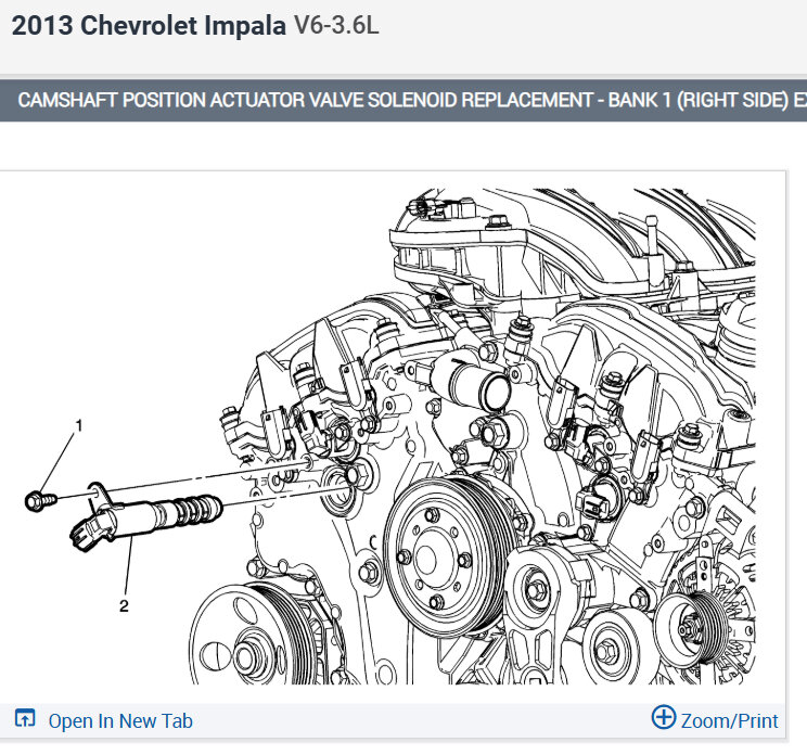

Also AutoZone showed the VVT being long tubes, but this video says it's the VVT and its triangle. Are these 2 different parts named close to the same or just mislabeling the part?

I am not sure what they are showing in the video. It does not look like the same car, here is what it looks like. Check out the images (below).

Yep that's what I thought as well. Okay, I will update later today when done.
