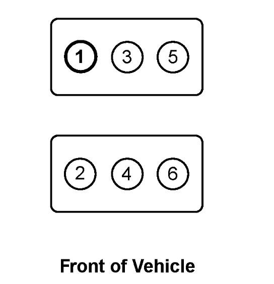

I am having trouble finding where Bank 1 is on the car. I have not been able to find a YouTube video that outlines where Bank 1 is. Can you tell me where I can find Bank 1? I bought the part just not sure how to replace it. Thanks

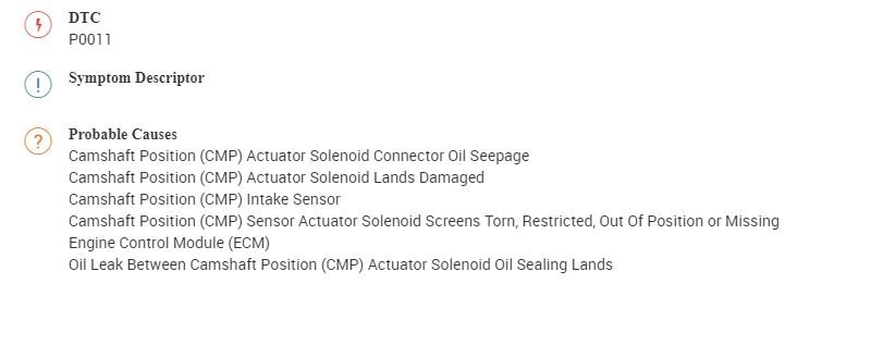

Did you have it diagnosed or are you assuming it is the issue from the code? Codes rarely identify bad parts just failed systems.
I attached a the possible failures for this code. Were any of these items checked?

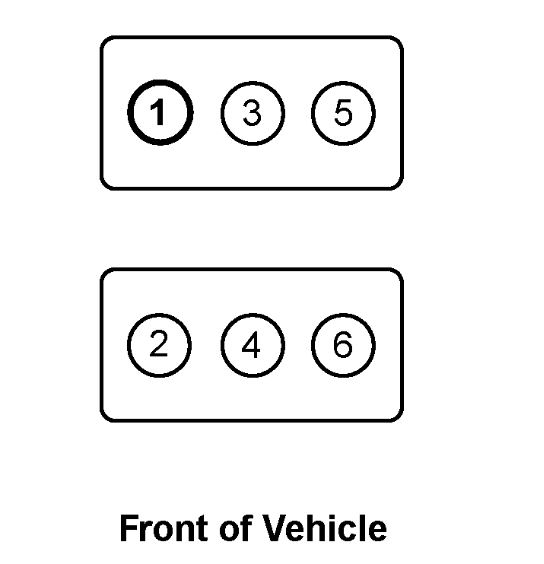

The cylinder location is also attached.
