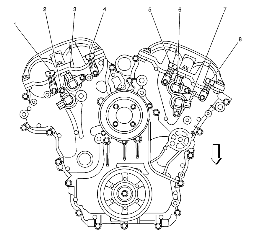

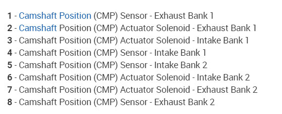

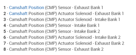

This can happen when the camshaft oil control solenoids get clogged up or stop working. Also, make sure the engine oil is clean and full. Here is the location of the actuators so you can remove them to check the screen at the engine of the valve. Here is more information on the problem:
