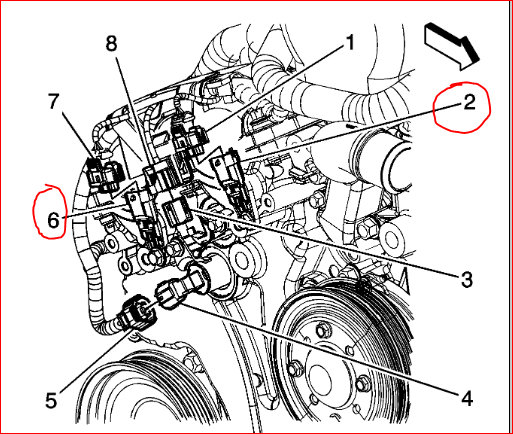

Code reads P0008 cam positioning sensor bank 1. Where is the sensor located?

I've attached a picture below of its location. I've circled in red the location #6 is the bank 1 exhaust camshaft sensor and #2 is the bank 1 intake sensor. Here is a tutorial showing what is involved in the replacement:
