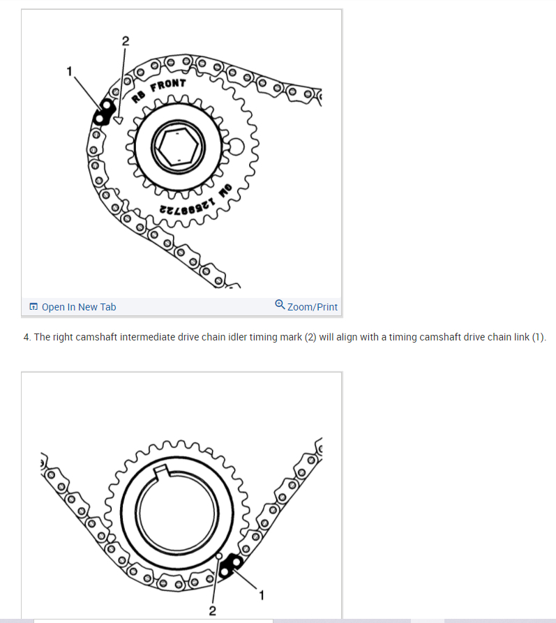

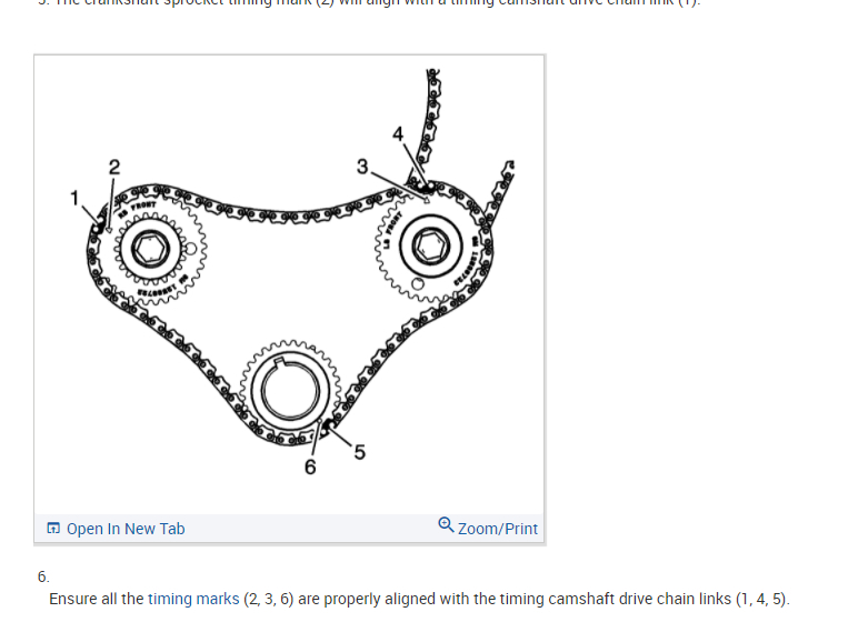

They have the timing chain on wrong.
Return the car to the repair shop and have them set the timing correctly.
I attached a diagram of the lower chain that is most likely the issue.
I attached a YouTube video of the procedure for you.
