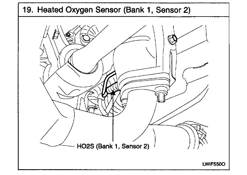

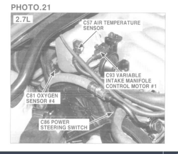

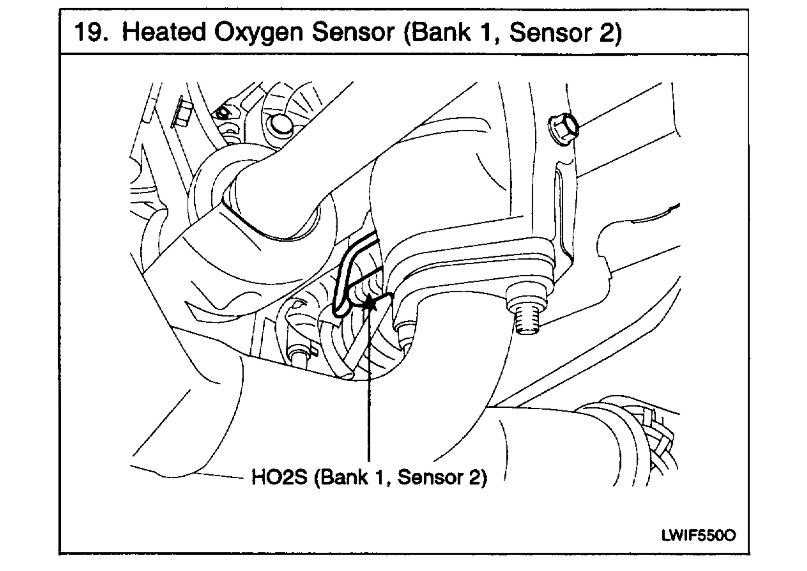

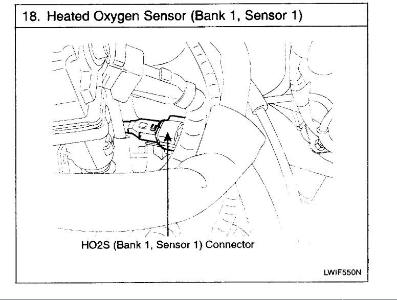

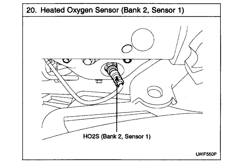

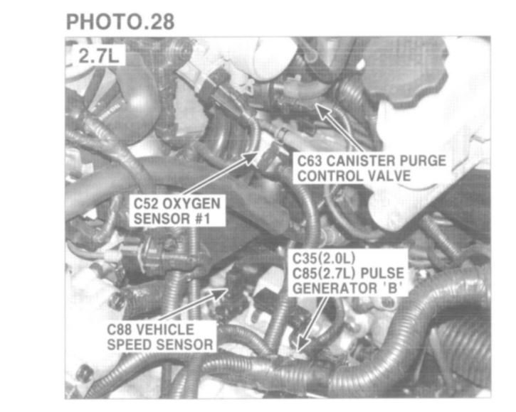

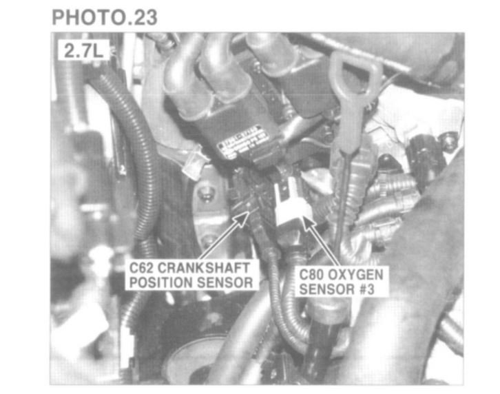

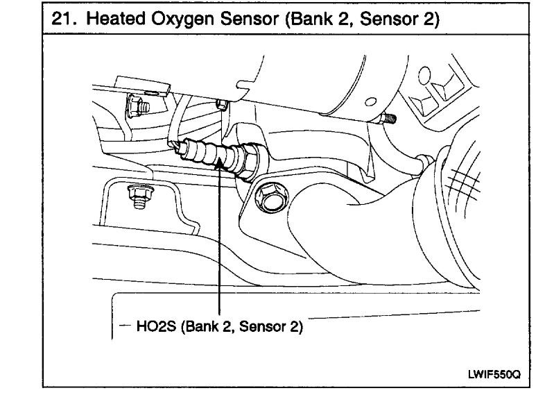

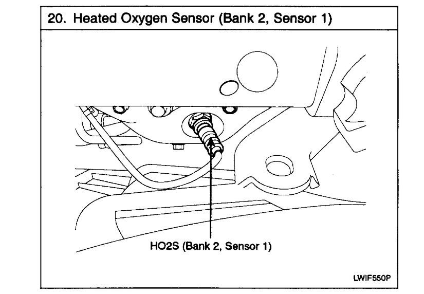

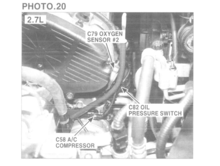

Hi, can you tell me how many oxygen sensors are on my SUV and where are they all located?
Thank you,
Patricia March
Jul 30, 2020 at 11:26 PM
CERTIFIED EXPERT
52,796 POSTS
Good morning,
I attached the locations and pictures for you of the sensors.
https://www.2carpros.com/articles/how-to-test-an-oxygen-sensor-02-sensor
You have a total of 4 sensors. They are very reliable and not a common failure.
