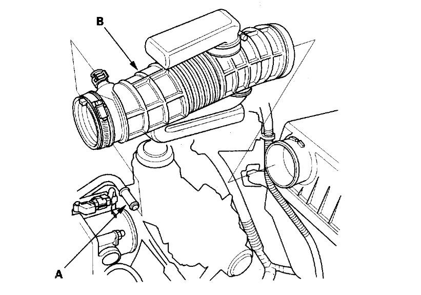

4. Disconnect the breather pipe (A), then remove the intake air duct (B).

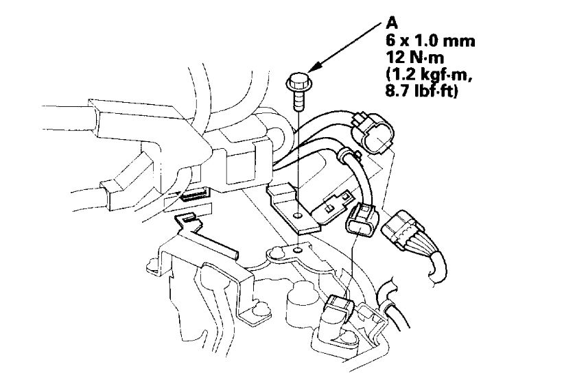

5. Remove the bolt (A) securing the harness cover, then remove harness cover.

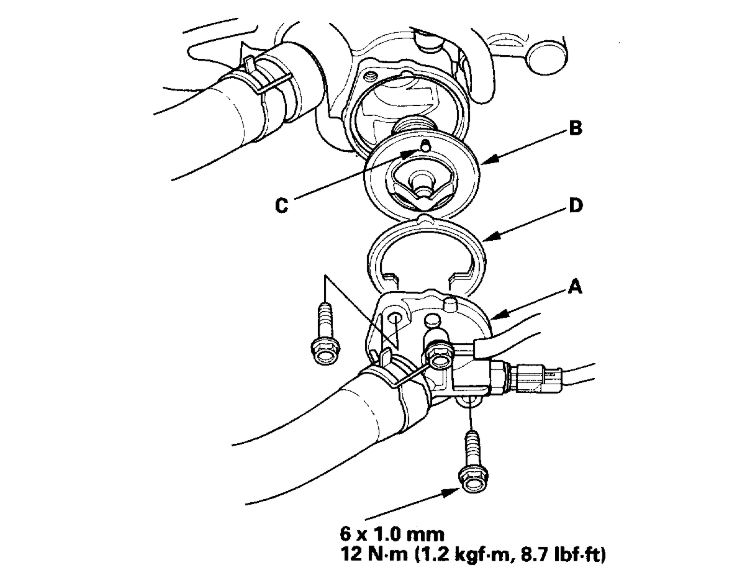

6. Remove the thermostat cover (A), then remove the thermostat (B).
7. Face the pin (C) toward the upside, install the thermostat with new rubber seal (D).

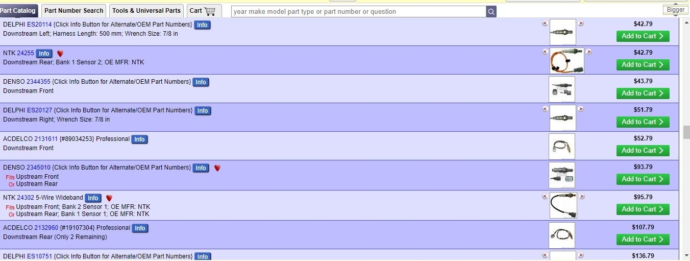

OK, time to go back to honda parts and get the upstream O2 sensor. take out that used one and throw it away.
