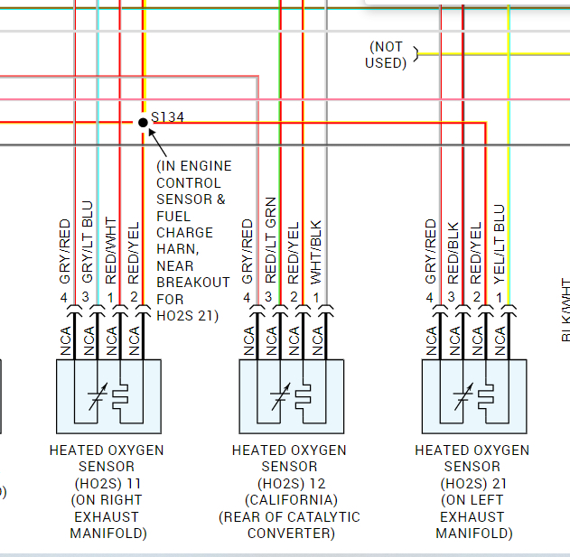

Check behind the engine to see if anything is disconnected. I'm not sure what someone has done. The wiring from the sensor goes in different directions, so there has to be a connector at some point.
I attached a pic below at least showing the wire colors you should be looking for at a connector. It should be a round connector with 4 pins.
See pic below.
